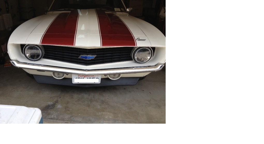

      i just took out the old headlight and replaced it with the trucklite housing. the only thing of note is that edge on the cast aluminum housing where the stock bracket sits is a little deeper so the headlights "stick out" past the trim rim a little..maybe 1/4 inch. Once they're both in you cant tell
      I dont run that resistor and have no flickering. Just plug the trucklite plug directly into the stock plug.
      These are super nice units. build quality is excellent and light out put is on par with my GFs nissan leaf which has OEM LED headlights. Not to mention they look cool as #@&$..i smile every time I turn them on..Got mine on Ebay for $350 for the pair..worth every penny just for the safety of actually being able to see

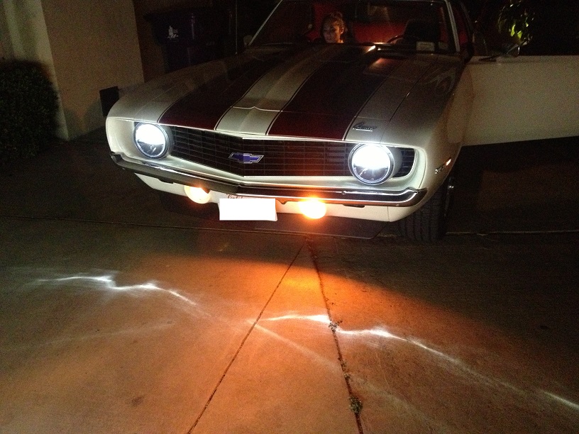

      Anyone have a picture of illumination geometry (or whatever it's called)?
      this;

      I think "cut off" is the term you're looking for.

      As far as fitment....The back of the trucklites is round as opposed to the JWs which stepped, so it fits inside adjustment bracket pretty snuggly. I think the only thing that trimming the bracket would do is sink the housing in the hole more more. If you look at my pic ypu csan see the lights stick out of the trim rim about 1/2" as opposed to being flush. I didnt think it was worth messing with...Once you tighten down the lock ring, the headlights arent going anywhere
      Also im my opinion the JWs are kinda ugly and too "obvious"..Plus in the pic the light out put looks blue..Might just be the camera..The light out put on the truck lites is kinda purpleish like OEM HIDS/LEDS
      Ill try and get a pic tonight if i remember

      Yes, that was it. Thanks.
      Any pics of the cut off?

      cutoff
