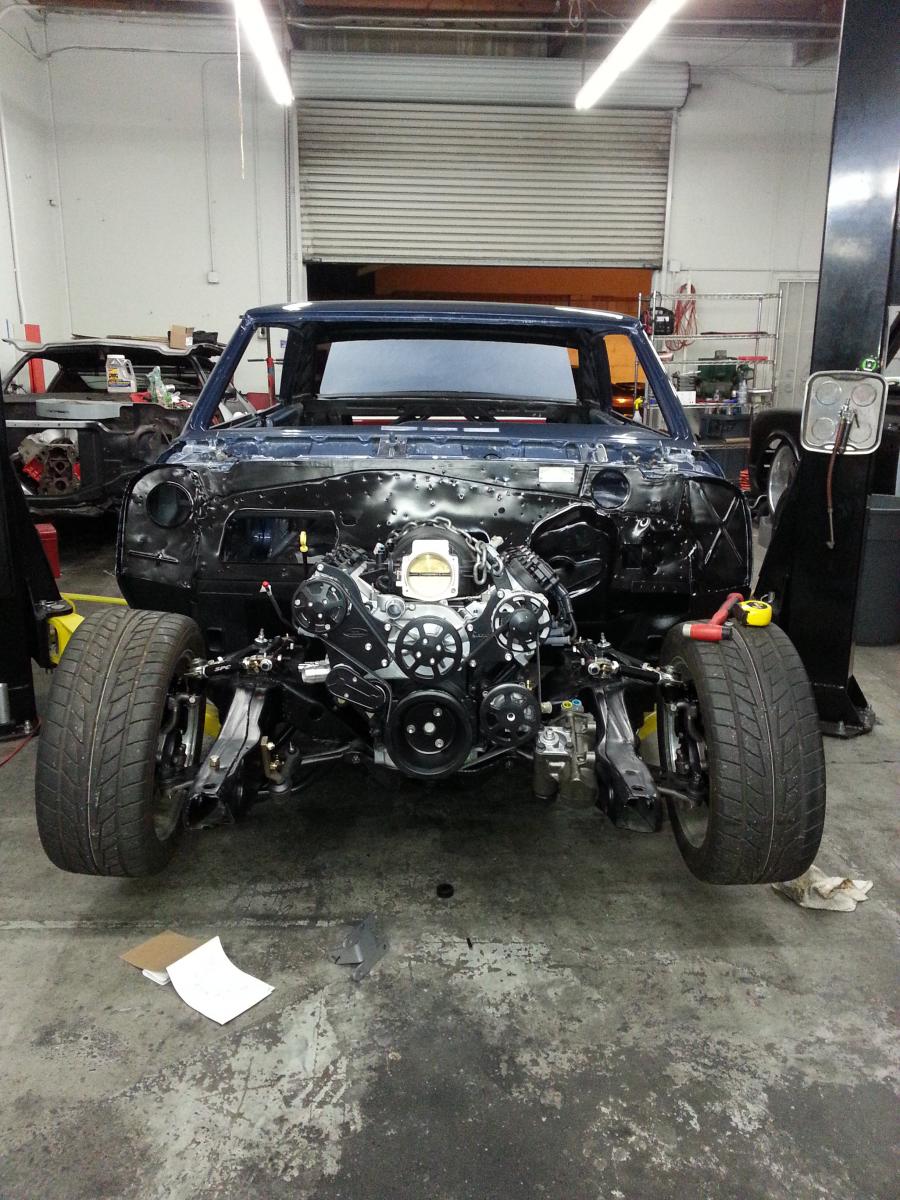

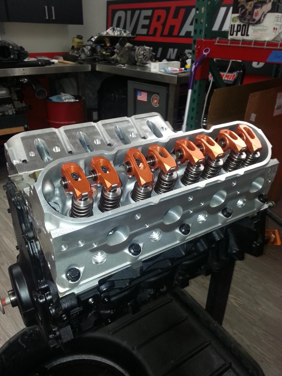

      This is one of our current builds we are doing for one of our close friends and customers Jay Glatman. This is his first Pro Touring car he's ever built, and I have to give him alot of credit, he's doing it right. Here is a quick little list of what is going in the car:
      • All aluminum LS
      • Trick Flow Heads
      • TF Camshaft
      • Harland Sharpe Roller Rockers
      • Fast 95mm Throttle Body
      • Holley HP EFI
      • Holley HP Fuel Rails and 43lb Injectors
      • Eddie Motorsports S-Drive Serpentine Kit
      • Hedman Headers
      • Tremec T-56 Magnum
      • Quicktime Bellhousing
      • Centerforce Clutch DYAD clutch kit
      • AGR quick ratio Steering Box
      • IDIDIT Column
      • Custom Brushed Drive Shaft
      • Built 10 bolt w/ Detroit Tru Trac
      • Wilwood 6 Piston Brakes
      • Magnaflow Stainless Steel Exhaust
      • Rick's Stainless Tank w/ vaporworks Pump Setup
      • SPC adjustable upper Control Arms
      • Tubular Lower Control Arms
      • Hotchkis Adjustable Upper Rear Control Arms
      • SPC tubular Lower Rear Control Arms
      • Phase 2 Watts Link
      • Dakota Digital Carbon Gauges
      • Full Dynamat Interior
      • Full Arc Audio Stereo System
      • Classic Auto Air - Air Conditioning

      252
      Nice looking build. What motor mounts and oil pan you using? Any pictures of the tunnel mods for the transmission. Looking for ideas.
      Apr 2010
      Huntington Beach, CA
      166
      Quote Originally Posted by 64G-lark View Post
      I will try and find some pics for you. If you put the motor in the stock location you wont have to modify the tunnel as extensive ad we did. But we wanted the motor as far back as possible. We used the Gm muscle car pan. Which I dont recommend because it hangs down a little far for my taste. If you are going to race it at all Auto kraft or canton make a sweet low profile pan for @$400.

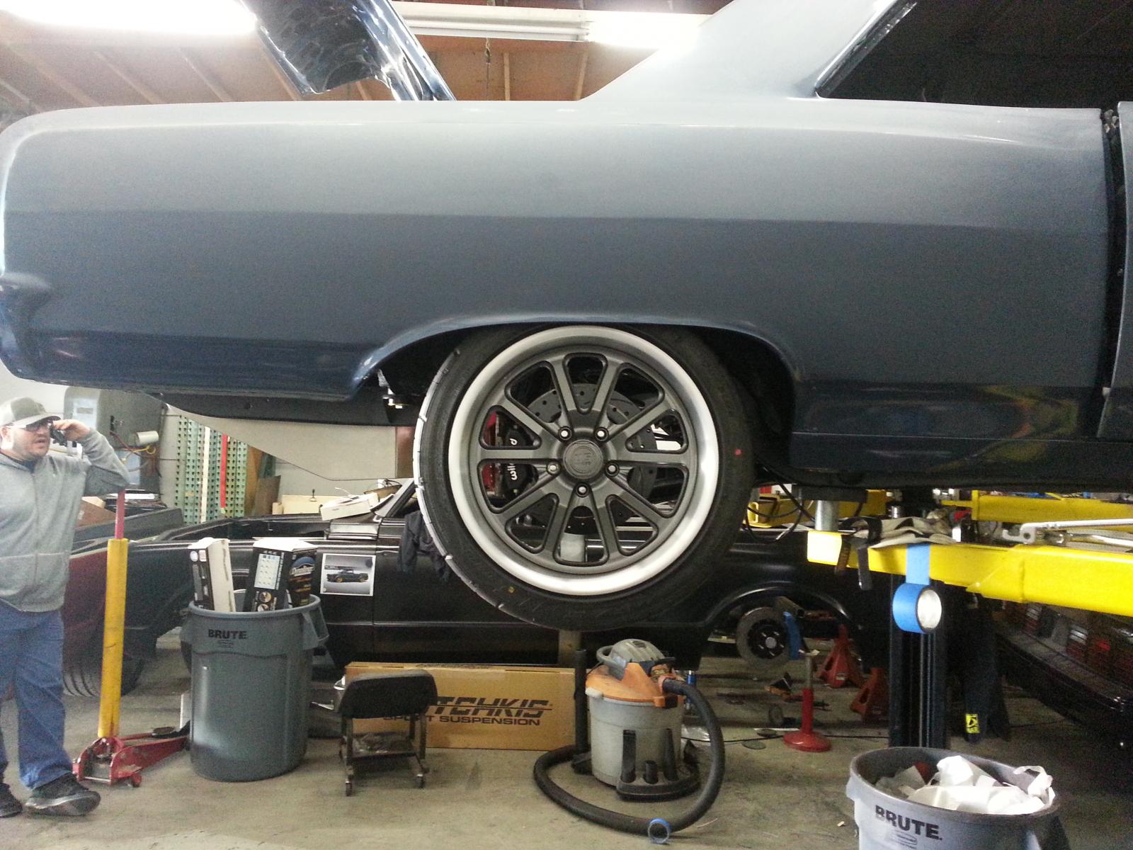

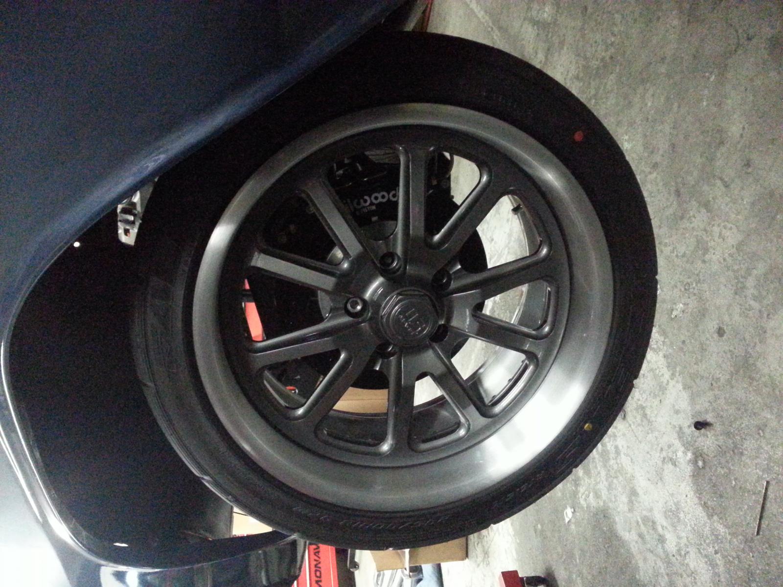

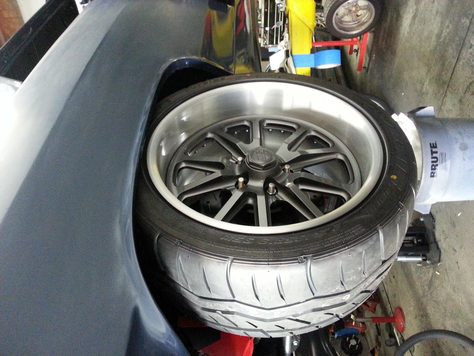

      We got our wheels today......
      Here are the wheels for the chevelle:

      Nov 2012
      346
      You got a lot of lip on that. Narrowed rear and tubs?
      _______________
      1969 Camaro
      1966 Skylark
      1964 Lemans
      1960 Biscayne
      Steve
      Apr 2010
      166
      Quote Originally Posted by Zoomin View Post
      Stock rear axle width and stock rear tubs. Lots and lots of measuring and having to have a custom set of wheels made so they fit perfect. It's definitely tight but they don't hit on anything......yet ;)
