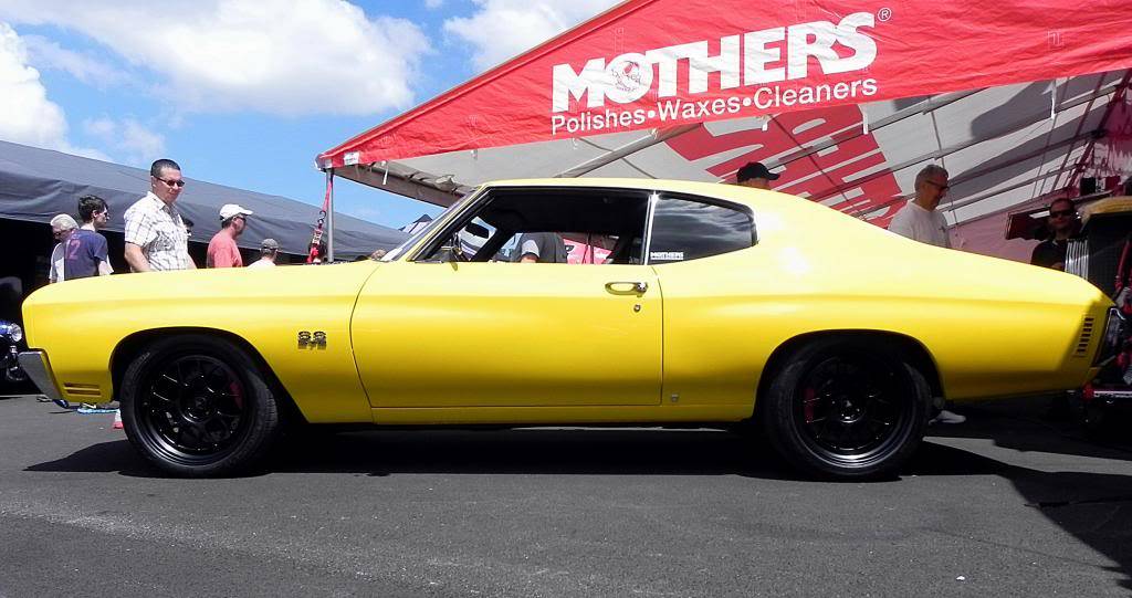

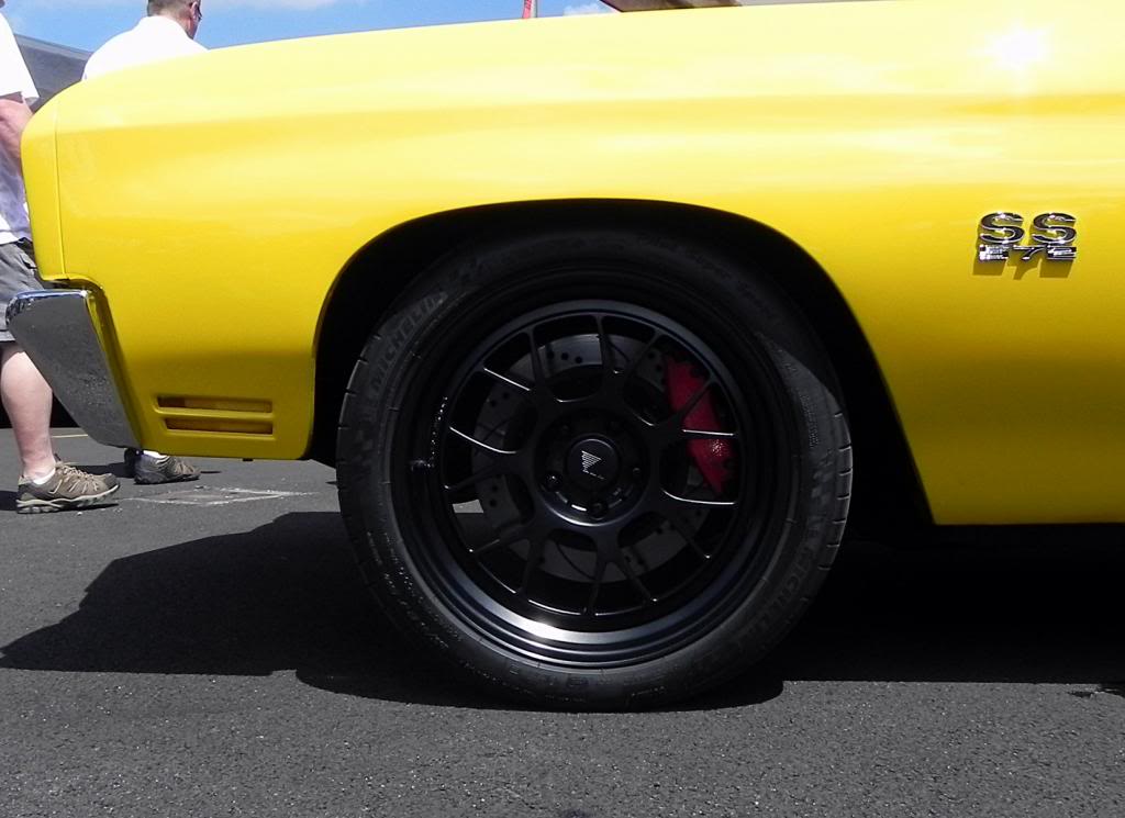

      Finally found time to get them on. I'm very pleased with the quality and help from Boze Forged.
      Now i'm wanting to get rid of some chrome…
      Went with 245/40 R18 and 285/35 R19 Nitto Invos too.
