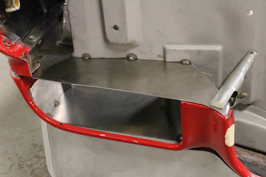

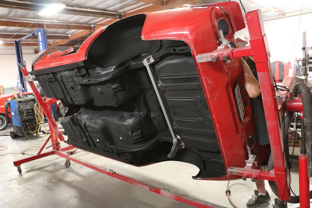

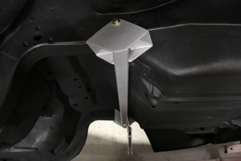

      We finally got back to work on the Camaro project the last few weeks.

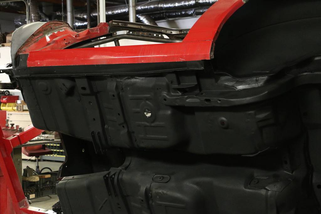

      We don't plan on making this car nearly as nice as the Mustang but we still cleaned the underbelly of most of the factory undercoating and years of gunk.

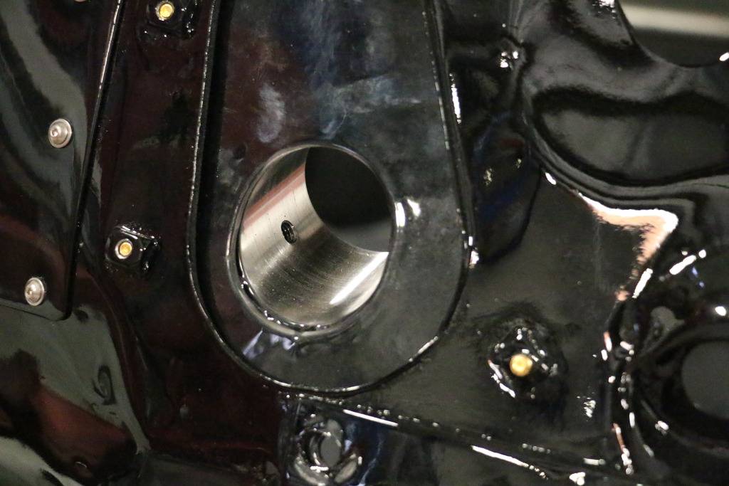

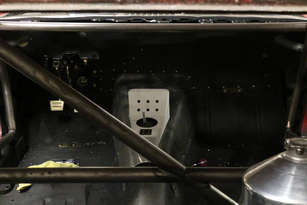

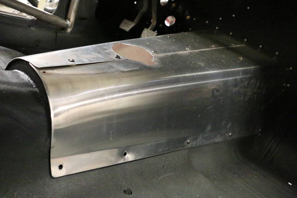

      Here is the trans tunnel mount plate.
      Back of the trans tunnel mount, The tunnel will be easy to remove.

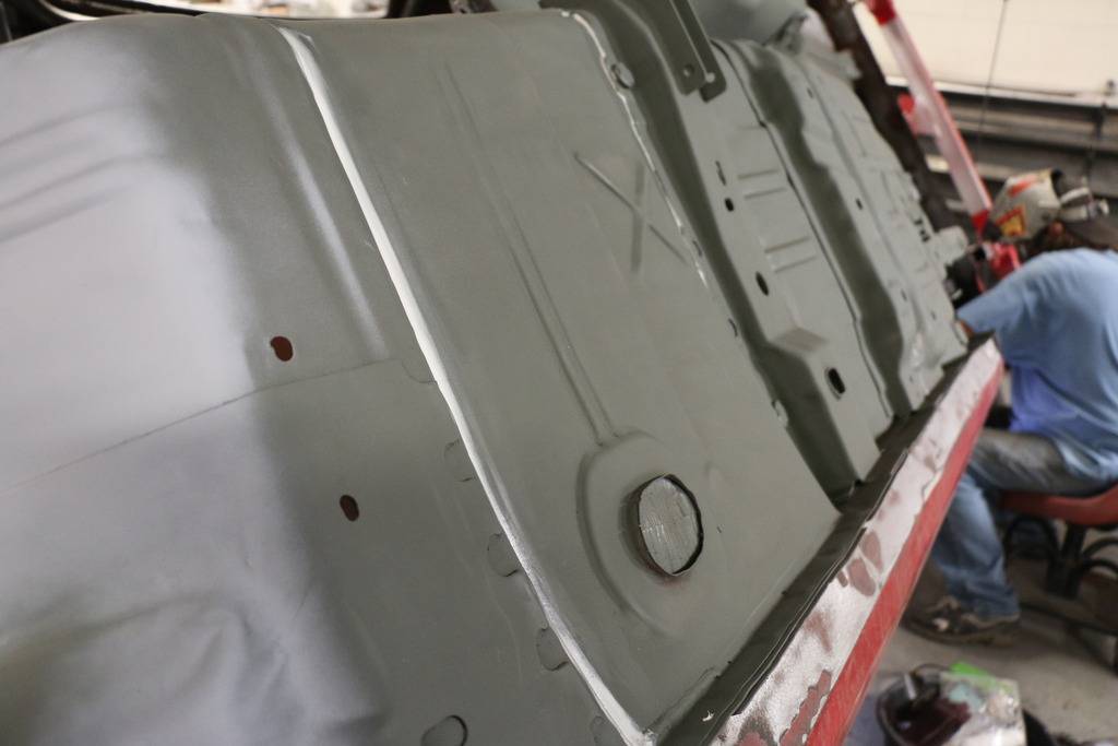

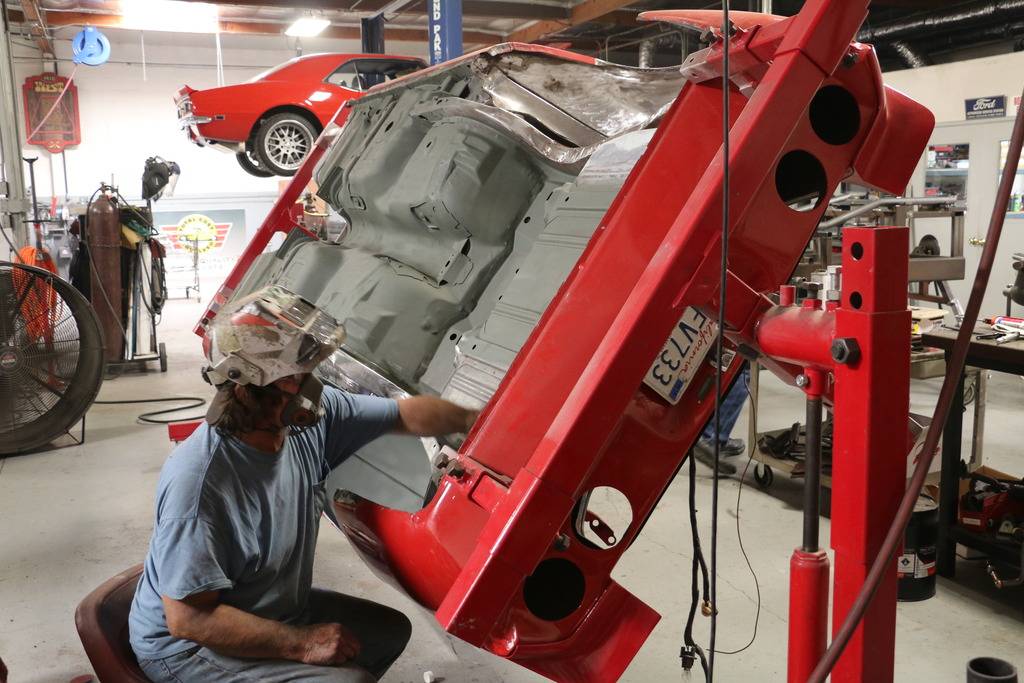

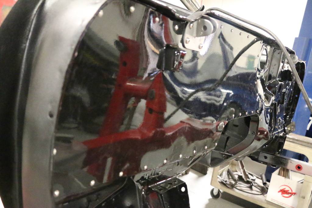

      Welded up most of the holes on the firewall. We debated on replacing it all together or just doing a cosmetic overlay.
      Danny going to town on the trunk
      Some of the parts came back from powdercoat.
      Trans tunnel and 35 spline Currie axles

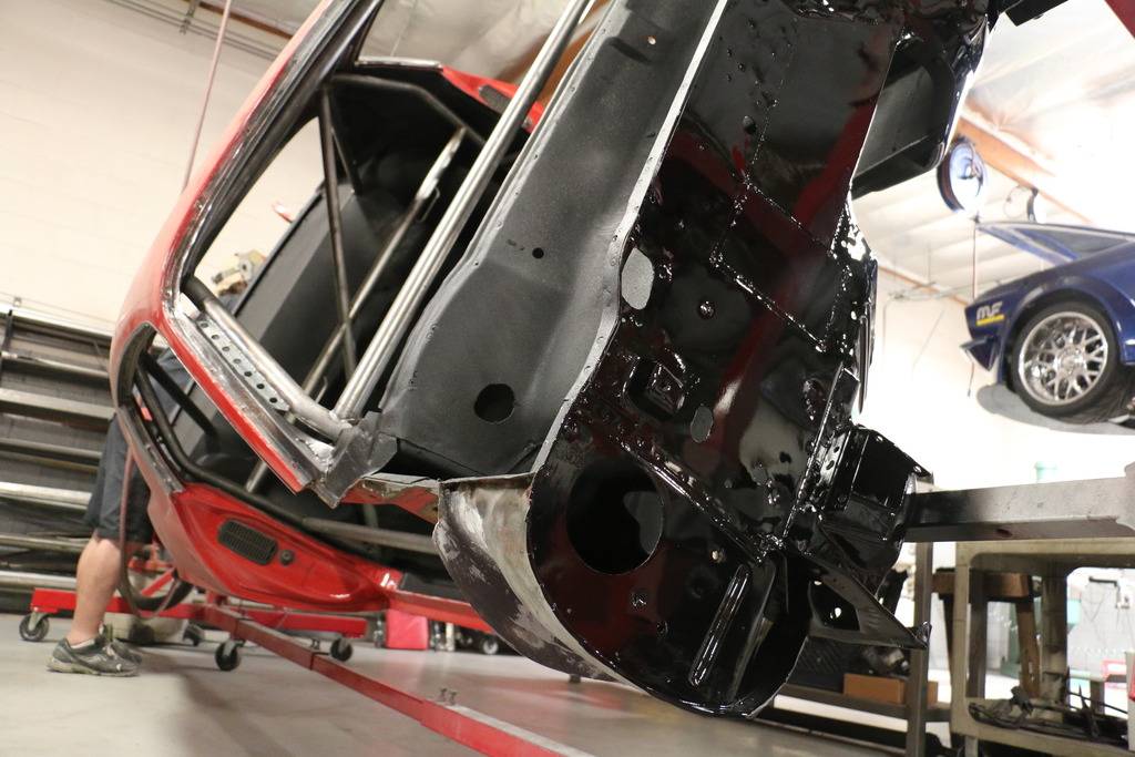

      The bottom was sprayed with undercoating
      Could this be reassembly? Say it ain't so.....

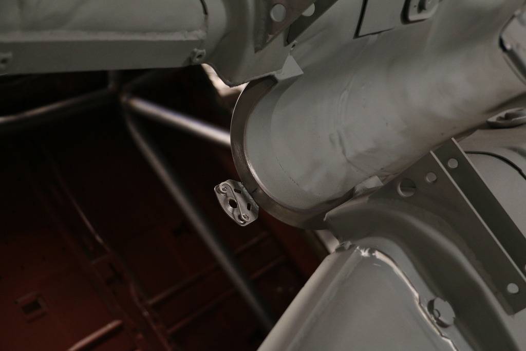

      Steering column firewall mount
      They decided on doing an overlay
      Downbars will be tied to the cage.
      Cage is finish welded
      -J
      www.totalcostinvolved.com

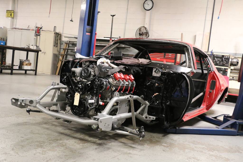

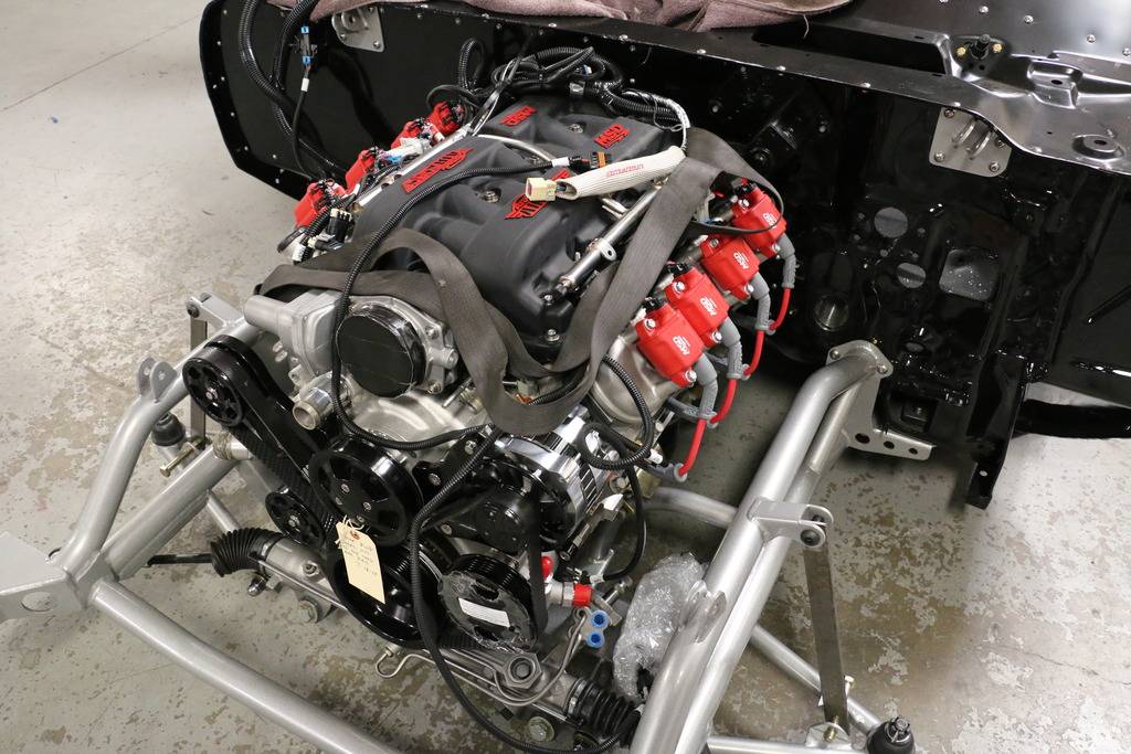

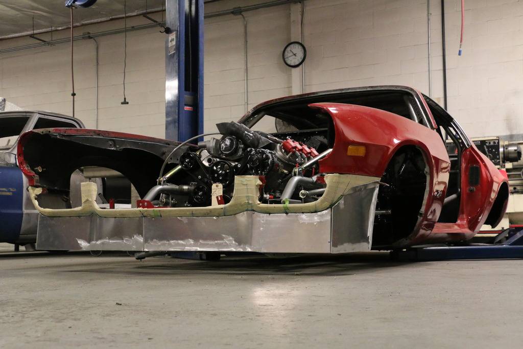

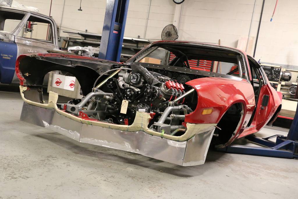

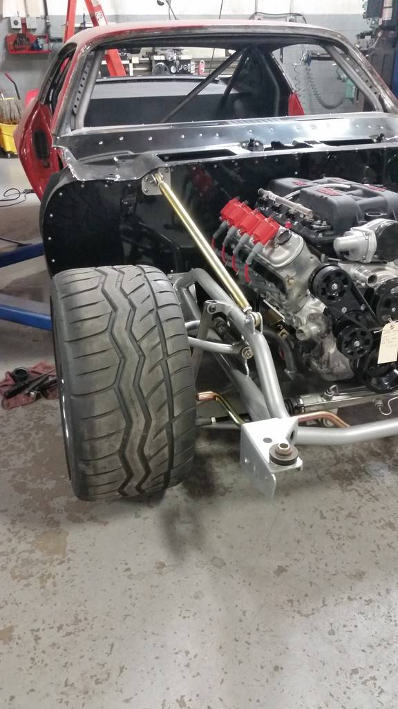

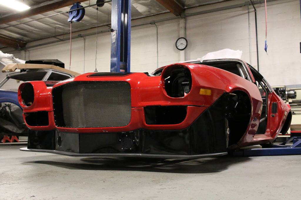

      We have good news. The new bullet arrived from Lingenfelter. It's a 644hp LS7. It made that power with factory C6 exhaust manifolds too so we're hoping it'll make 600 at the tires with a proper stepped header on it.
      We set her back an inch or so.
      Mocked up some 315/30/18's on an 11" wide wheel.
      -J

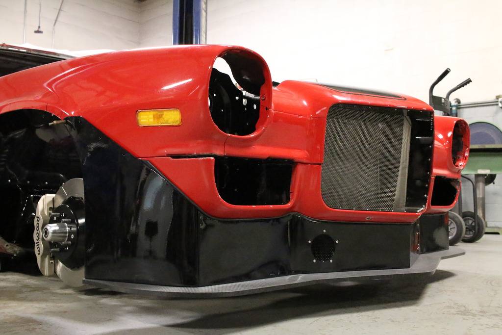

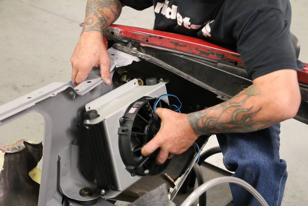

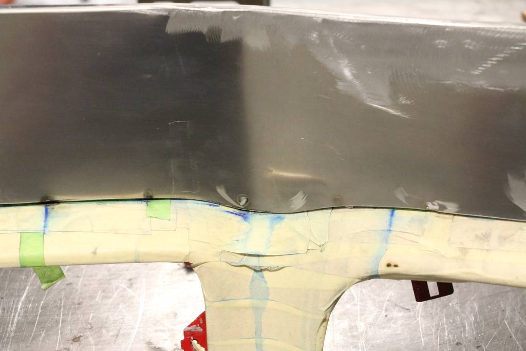

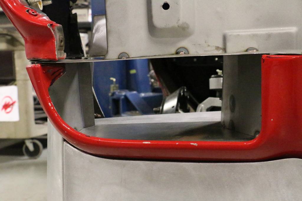

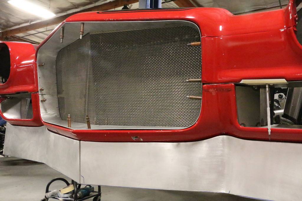

      Working on a new valence

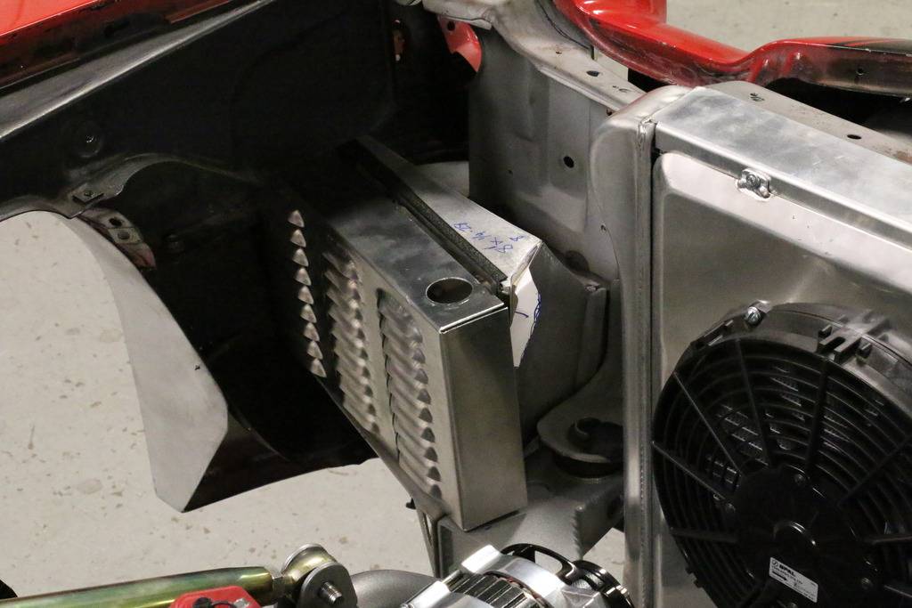

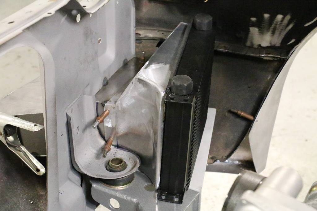

      Mocking up some Derale coolers
      -J

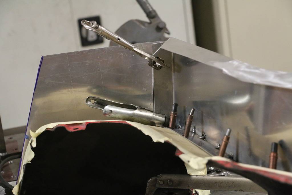

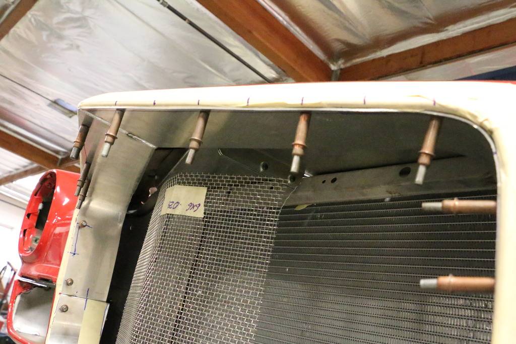

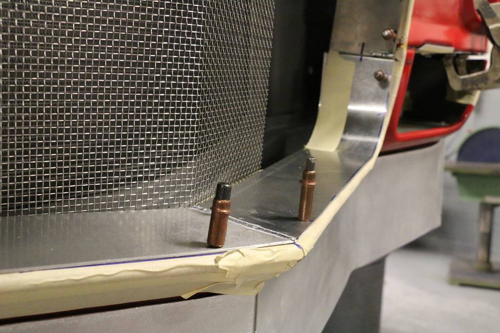

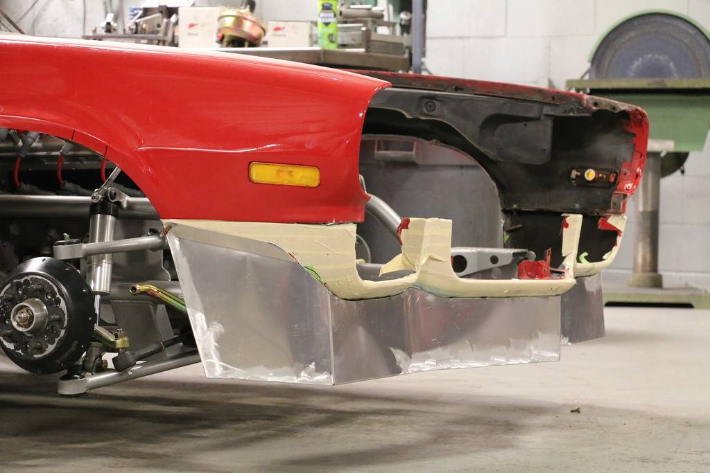

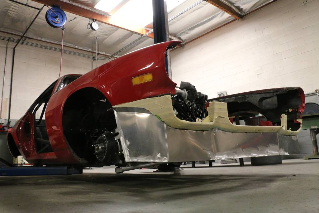

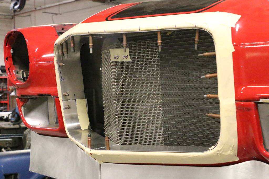

      Still working on the front sheet metal.
      Air ducts for the coolers (power steering & oil)
      -J

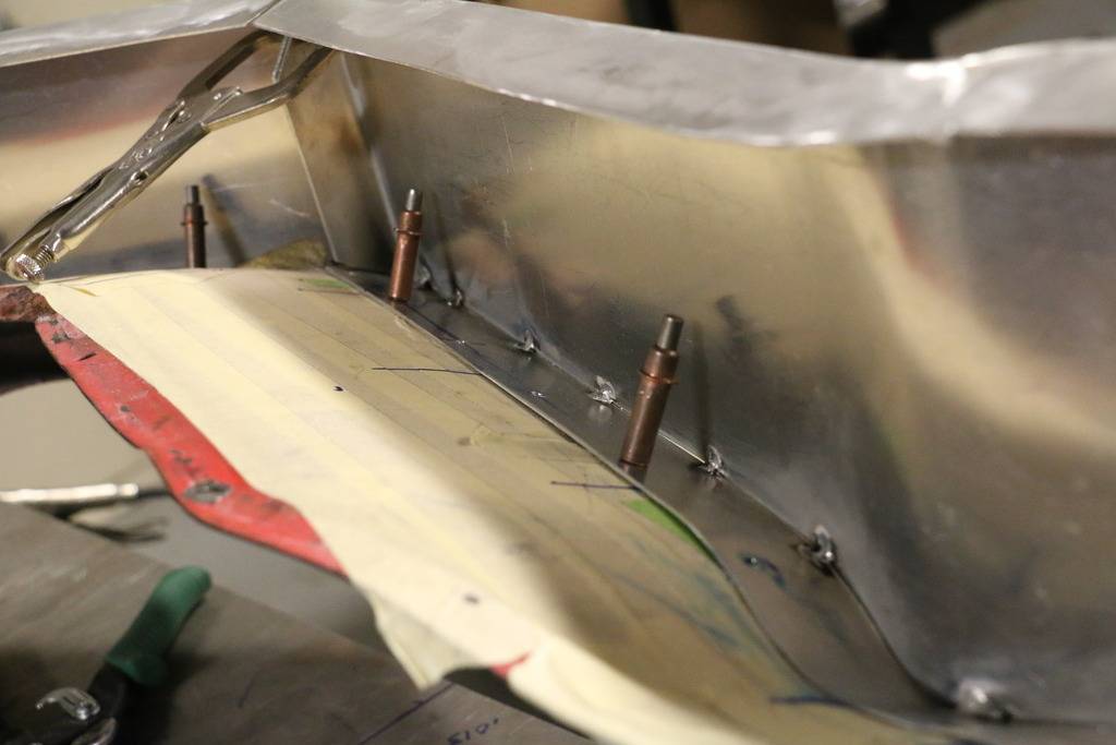

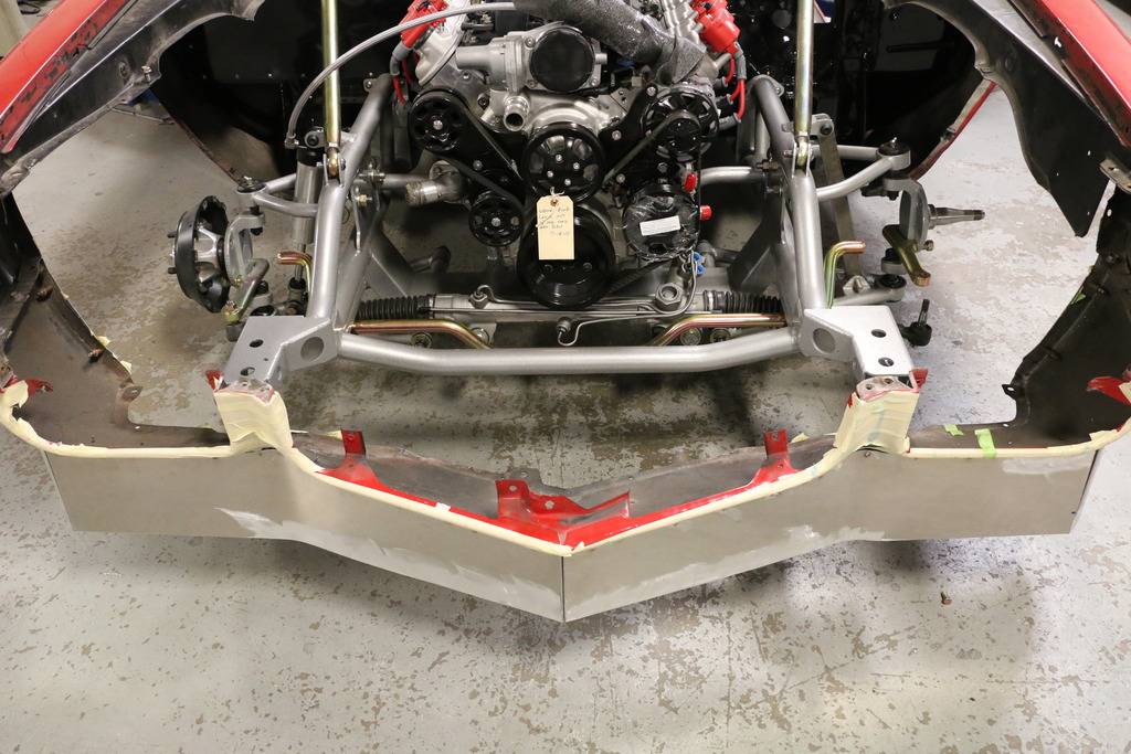

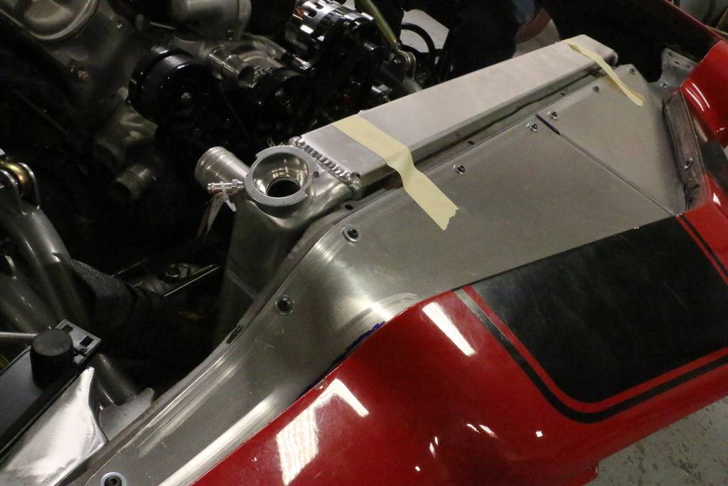

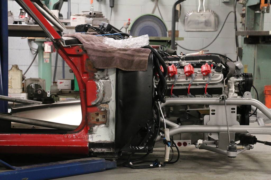

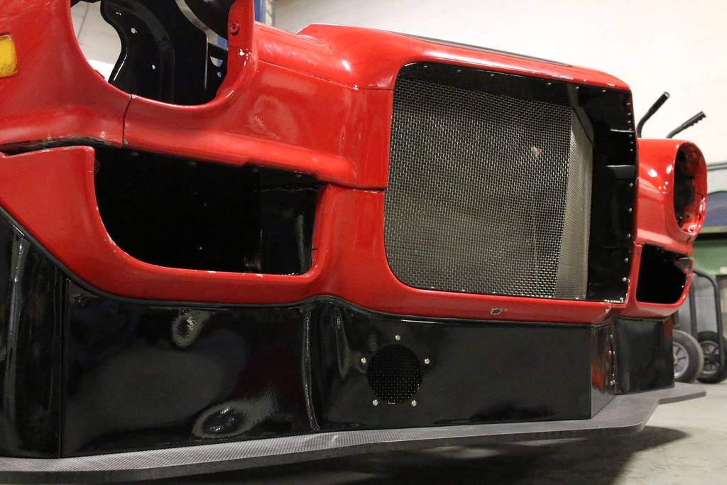

      Slowly making progress on the front end.

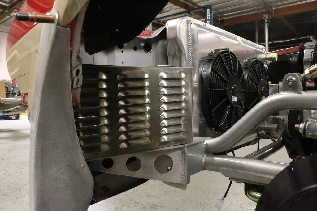

      Covering up the Derale coolers with louvered pieces to keep tire debris out
      -J

      782
      Wow looks great what undercoating did you use?

      Quote Originally Posted by nicks67camaro View Post
      It was just an over the counter spray(can) on liner.

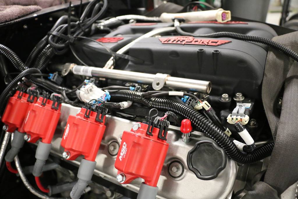

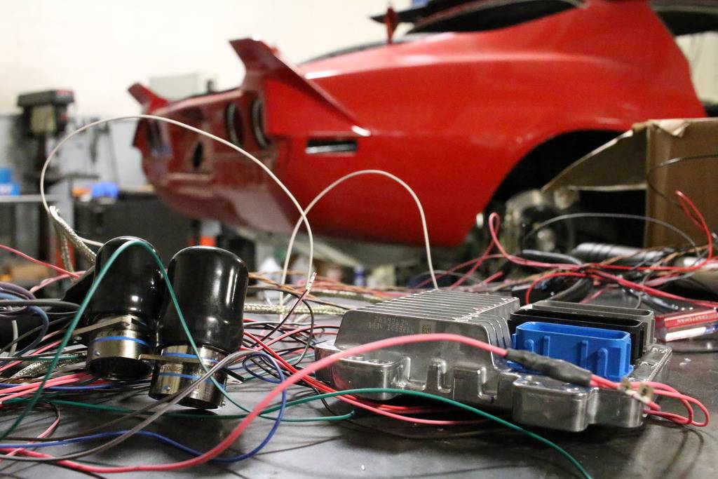

      Progress slowed a little towards the end of the year but we're currently working on wiring and plumbing.
      -J
