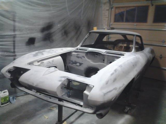

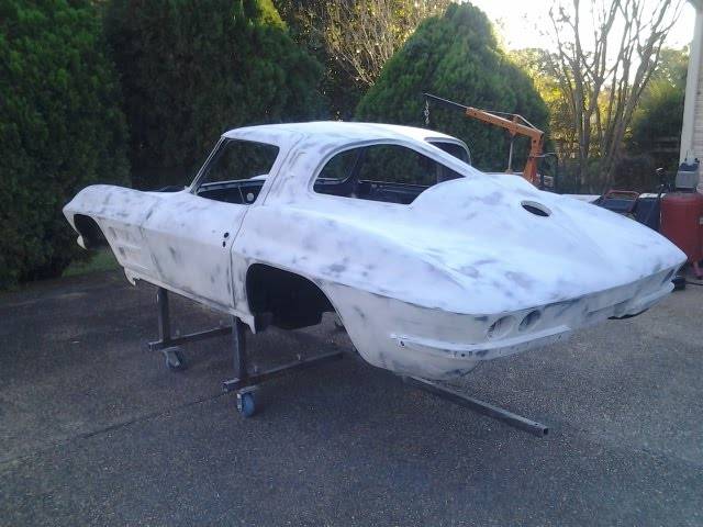

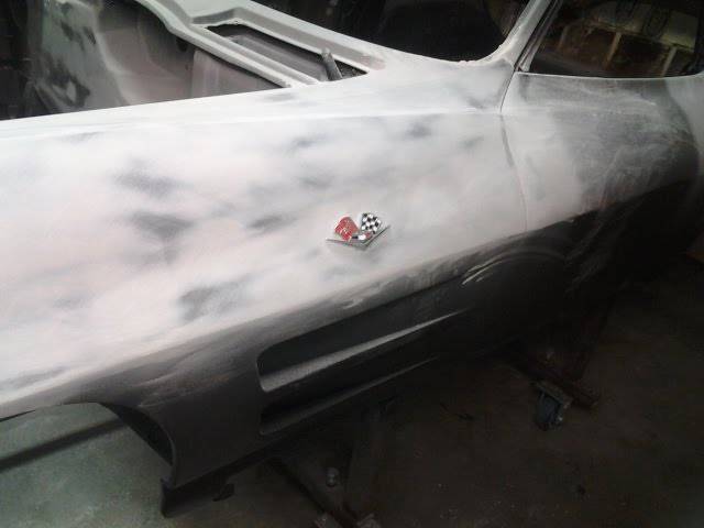

      Moving along again. I had to take a break from the car due to a business trip and a cold.
      Back half and jambs are in primer. Next are the doors, hood, door hinges, headlamp buckets, exhaust valence, and viper vents. After everything is blocked again, i will spray the car with slick sand.

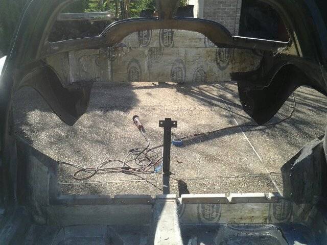

      306 hours total Body work is brutally time consuming!

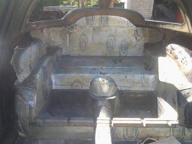

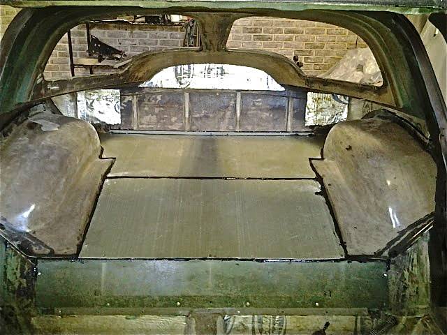

      It only took around 2 hours to remove the rear compartment and jackwell and temporarily install the new wheels wells and floor to check fitment. Mike's/SRIII rear floor really simplifies things and was well worth the 350.00. I payed 2300.00 to have the old floor cut out and a new one fabricated for my 66 last year. Total time in this floor will be around 6 hours once all is said and done. Cost is 350.00 for the floor and 40.00 for a tube of 3m panel bond.
      The official point of no return!

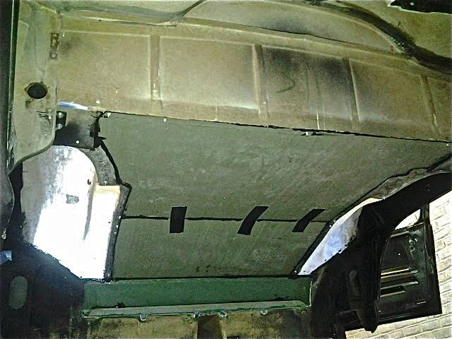

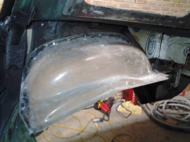

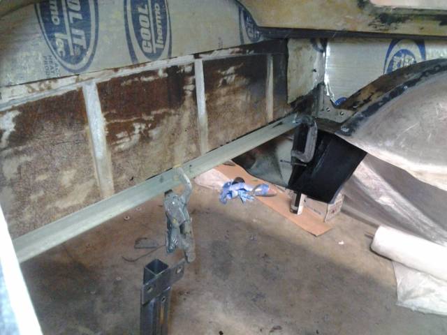

      Found another hour to install spray in new undercoating and install the wheel wells and rear L support. Im going to let the adhesive cure overnight and then install the floor sections tomorrow.
      These crappy cell phone photos have really reminded me that i need to start using my nikon again.
      Shot from the underside of passenger wheel well. Im going to smooth out the transition from new to old glass. No reason to cut corners at this point.

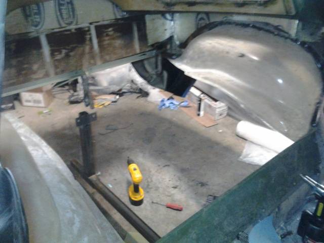

      I enjoy seeing instant progress, so doing the rear floor was fun. Doing the bodywork was very tedious and sometimes I felt like i accomplished nothing even after putting in a 10 hour day.

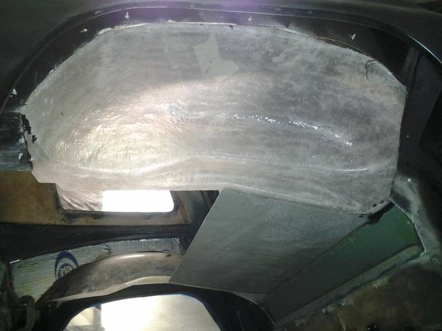

      309 hours
      Rear floor and wheels wells are installed. Im going to try out some sprayable seam sealer on the underside this evening. And yes, i will be reinforcing the floor.

      Oh, and i continue to be amazed by 3m panel bond. Tonight i put the majority of my weight, 170 pounds, on the floor boards to remove the self tapping screws holding the new rear floor panels to the new rear wheel wells and original fiberglass. The boards did not budge at the seam and there is nothing reinforcing them currently. Just an amazing product, plain and simple. I never thought an epoxy could be so strong.

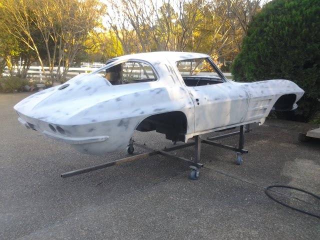

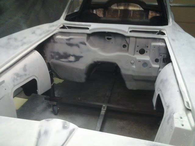

      Lots of little things have been address and I will post pictures of them later, but for now, here is the state of the body.

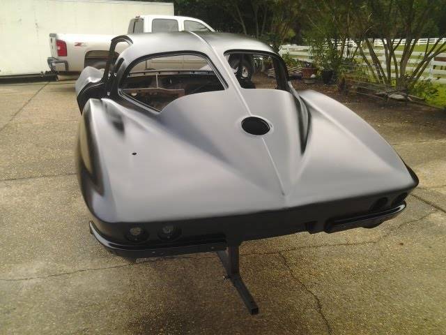

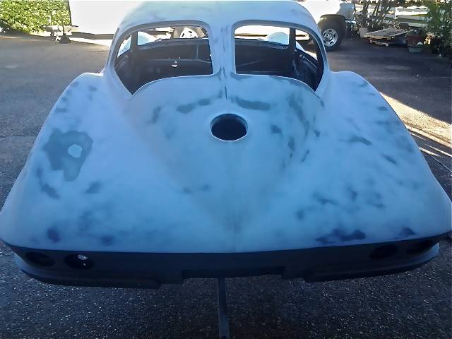

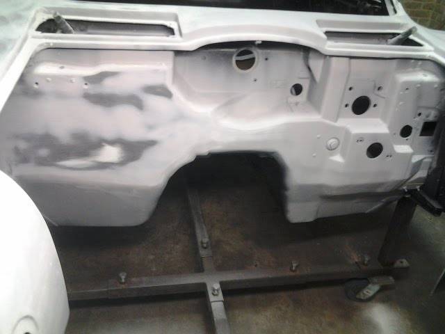

      I block sanded the entire body again, then applied two more coats of SPI black epoxy. After the SPI black epoxy sat overnight, i applied two coats of Evercoat Slick Sand. I just finished blocking the slick sand on the front end and engine bay this evening.

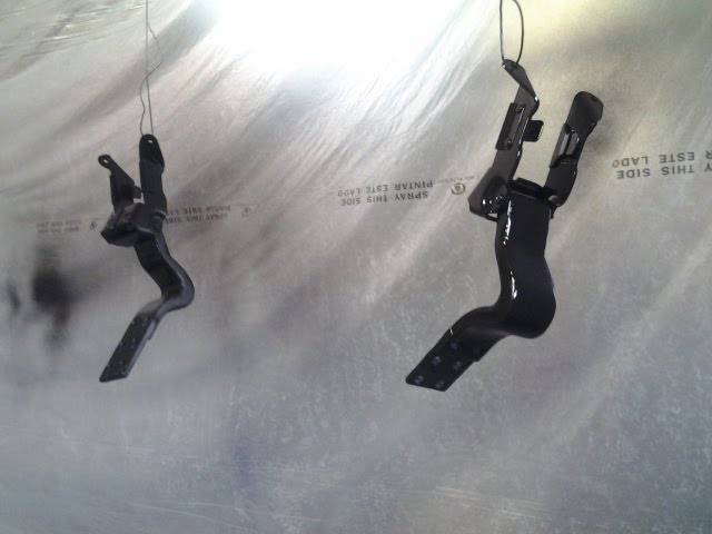

      One of those small details i was talking about above. Hinges rebuilt and coated with SPI black epoxy. This happened a few weeks ago.

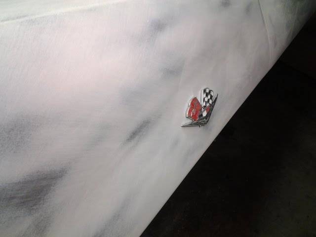

      I decided to ditch the fuel injection emblems and go with the early style 63 emblem, which i thought was original to the car since it has an October 62 build date. I think i might have received the wrong emblems. The original holes for the emblems were wide, while the pegs on these emblems are narrow and do not penetrate very far through the fiberglass. However, i like them and Im going to use them alone without the fuel injection emblems.

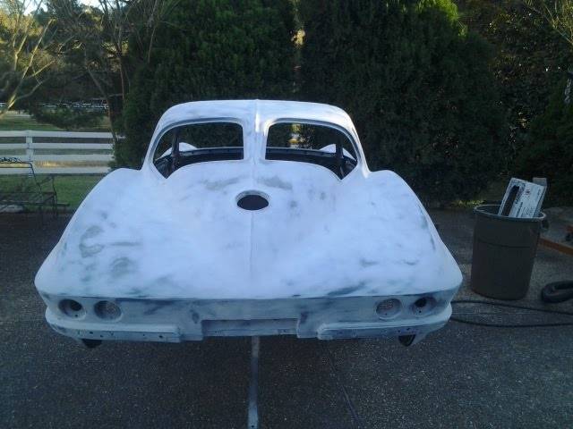

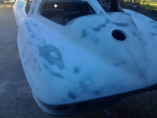

      After seeing a 63 split window without an antenna at SEMA i decided that i would copy that person's car and do the same. Removing the antenna gives the rear of the car a much sleeker look. I used a Hideaway antenna on a custom Mustang i built last year, so i will do the same for this one.
      Two more coats of slick sand and a whole hell of a lot more sanding. I sure hope this thing is as smooth as glass! Oh, and surprise...I ordered SPI black today for the basecoat. I saw a 63 in cyber gray a few weeks ago and it did not look so hot. I thought about switching to silver, but most every 63 restomod i have seen in the last year has been silver, so black it is...straight black, no metallic.
