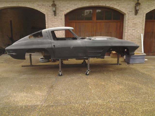

      Anyway, the car is ready to have the body pulled now. All plumbing is loose, radiator out, computer removed, wiring disconnected, etc. Also managed to remove entire dash and prep for new paint and pads.
      This was back in early June.
      Here was my copilot the other day. We took the risk of getting a ticket and drove 5 miles from my home to my garage where the remainder of the work will be performed. My lab thought riding in the car sans glass was awesome! I don't think I have ever seen her so happy. The looks we got from other drivers were priceless.

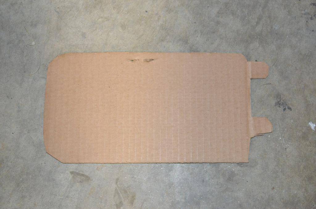

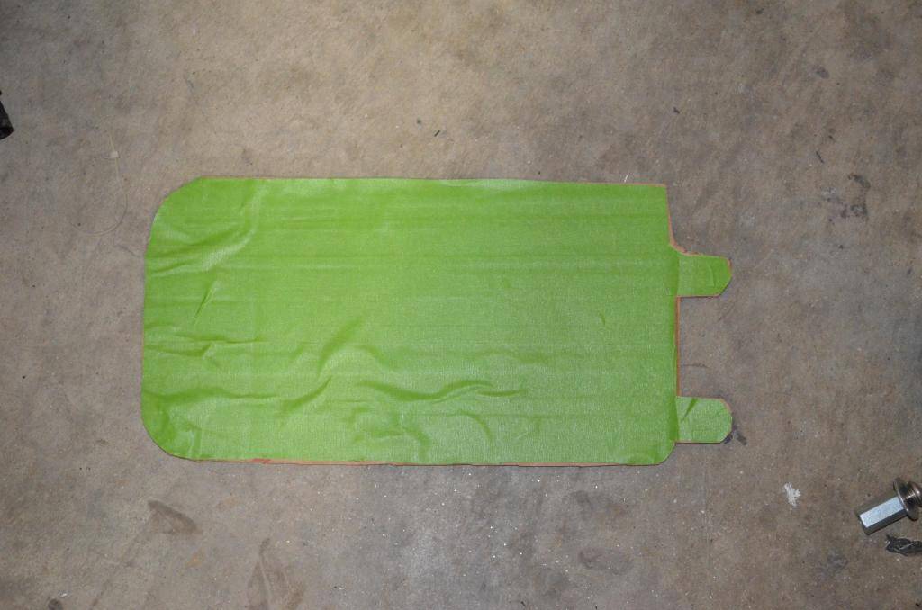

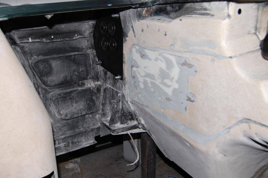

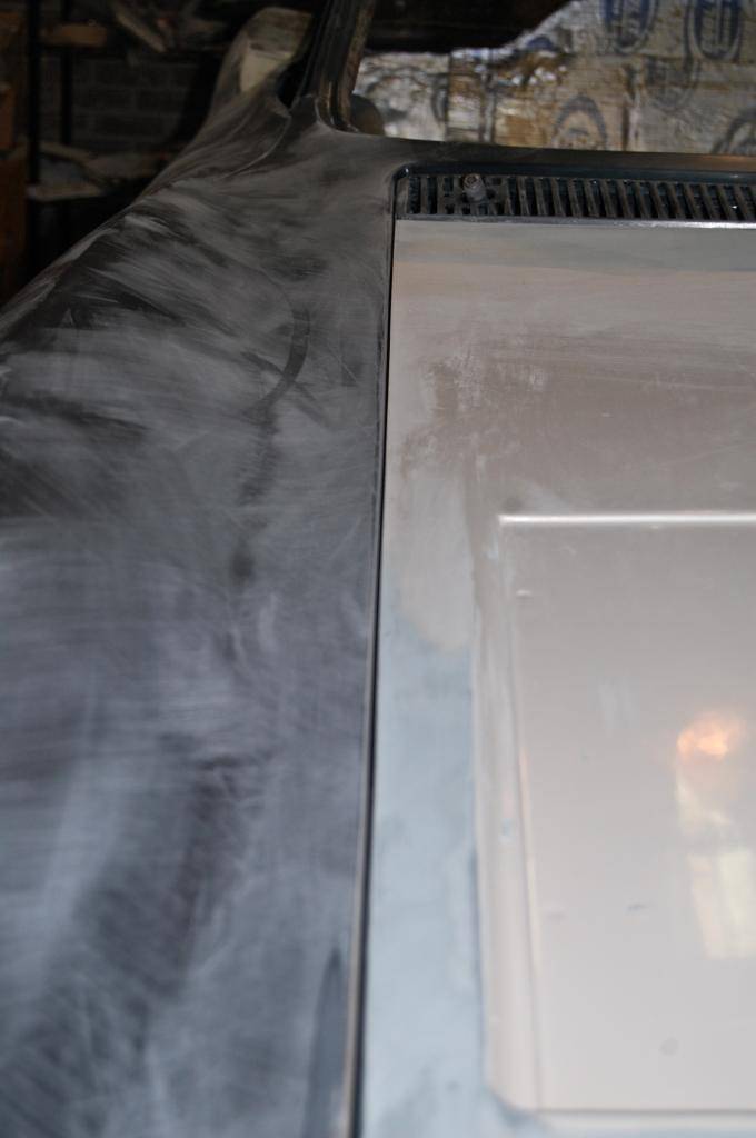

      I was watching overhaulin' the other night and saw how they were using tape to create a form for fiberglass, so i tried it on the firewall where the heater box hole will no longer be necessary thanks to the newer vintage air unit. It worked well, but i ended up needing to still put a layer of glass on the backside for support. I've been working on these cars for over 20 years, but i am still learning about body work and paint, so maybe some of this will help others.
      Clean slate
      My opponent
      Template for fiberglass mat made out of tape, which i then transferred to cardboard.
      Glassed in and firewall sanded around area to be filled. Eventually it will all be stripped to bare glass. I will be painting the entire engine compartment to give it a finished look. I wasn't thrilled with the black rattle can finish of the last restomod.
      First skim coat of evercoat filler.

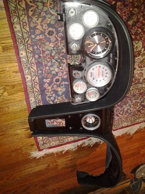

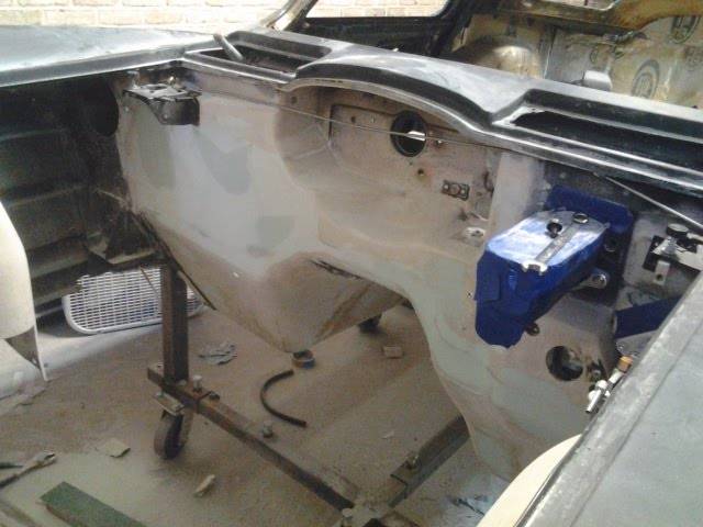

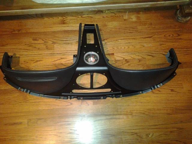

      7/17/13 Took a day to work on the dash since the pads arrived.
      57 hours
      Im starting to work on some of the interior items in anticipation of the SRIII chassis and 63 hood arriving soon.
      I wet sanded the dash, primed it in areas where i had rubbed through eliminating drips, and then repainted it with SEM hot rod black.
      Wet Sanding
      New Black Leather Dash Pads with French stitching option
      Here (on the left, not the other gauges) you can see what the Autometer American Muscle gauges will look like with the original clock. I sold the cluster shown with the stock chassis. The new one will have the autometer gauges recessed behind the original cast in bezels.

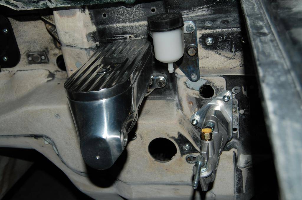

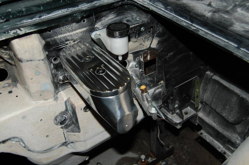

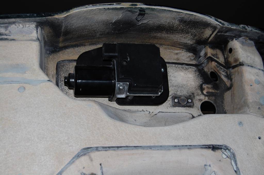

      I've removed a large majority of the old paint from the firewall and fender skirts, but still a lot to go before epoxy primer. I am also in the process of fitting the new components on the firewall and in the engine bay to insure everything fits correctly. Hopefully that will help the assembly process after paint go smoothly.
      Making sure everything lines up with the new vintage air system. Still a good bit of body work to do on the firewall where i deleted the heater box cut out.
      New wiper motor from Detroit Speed.

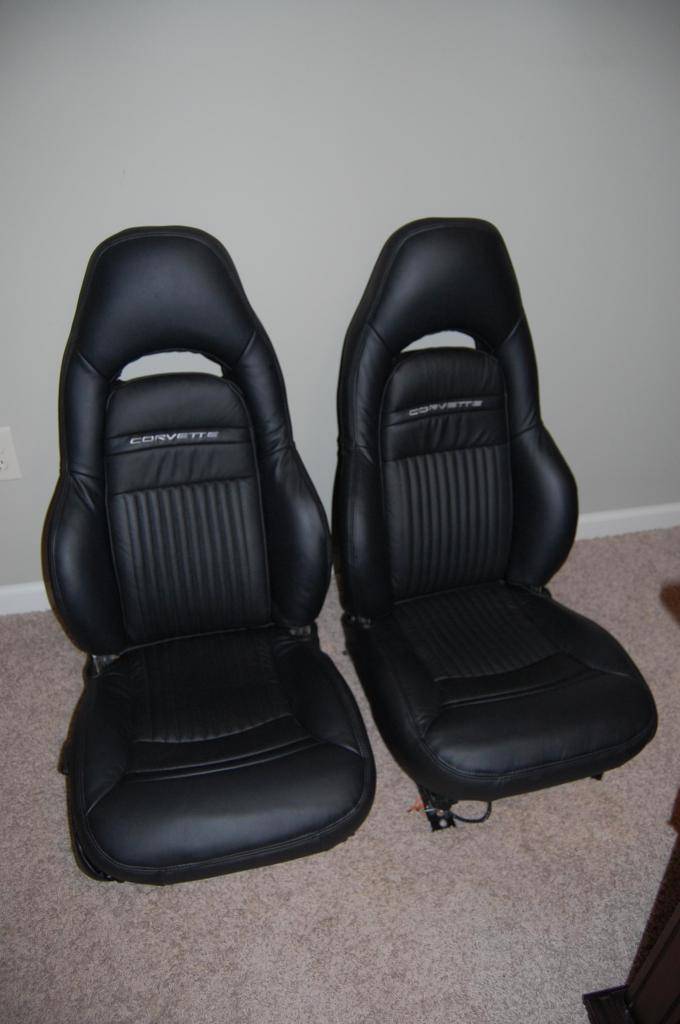

      Seats recovered in new black leather.

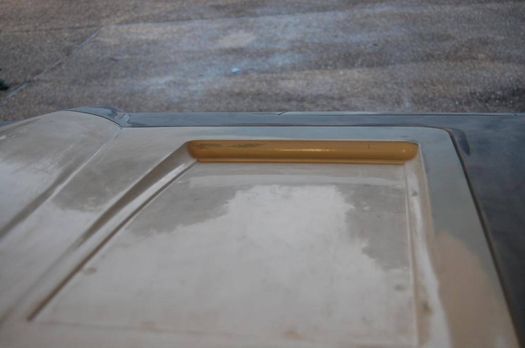

      And after what seems like an eternity, all of 12 weeks, the hood finally was finished and arrived today. Bolting it on made me realize that the hood surround is wavy from previous bodywork, so that is next on the list.

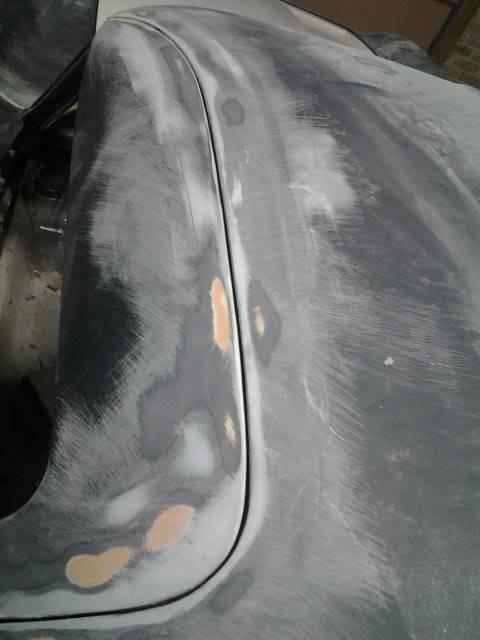

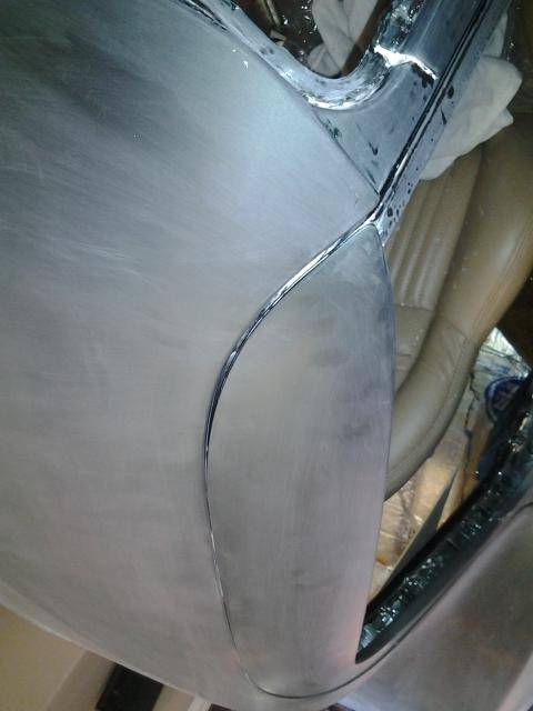

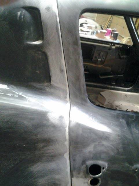

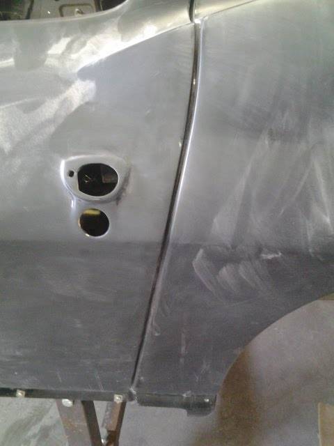

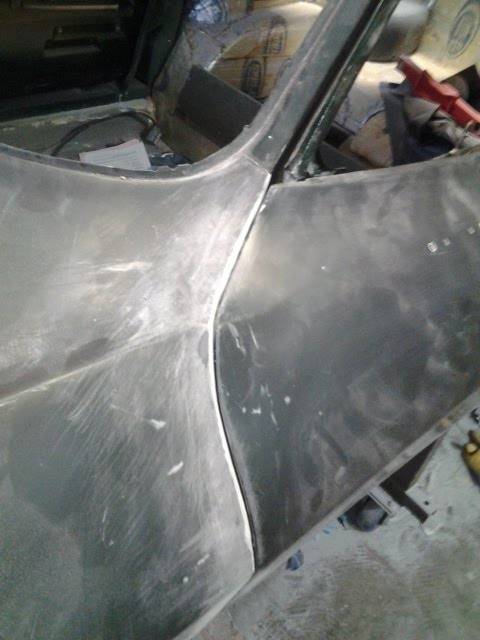

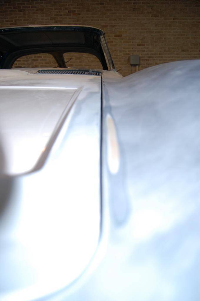

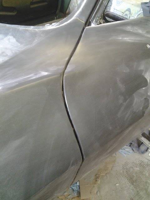

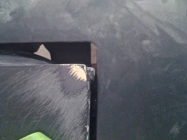

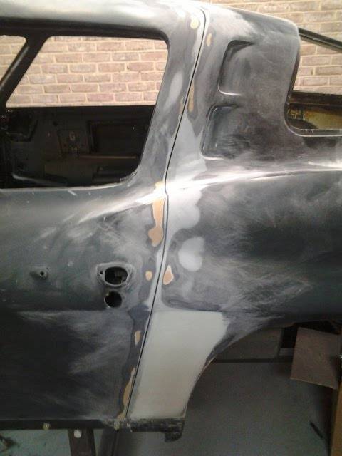

      Finished narrowing the gap on the driver's side door and fitting the door to the roof, quarter, and fender. That only took 9 hours total. This is the first time i have narrowed the gaps on a Corvette body, so I'm pretty proud. The passenger side is not nearly as bad, so it shouldn't take quite as long.
      The door stuck out past the roof panel just in front of the indentations previously , but that problem is now resolved.
      The door had a dipped down at the rear corner and sat lower than the body. It wasn't terrible, but it needed to be addressed.
      Front of door Before
      Front of door After. I will need to remove the door to finish smoothing things out.

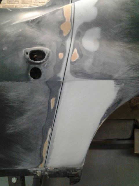

      Still a good bit of filling and smoothing to do on the passenger door, but the gap is already nice and tight after building up the jamb with evercoat vette panel filler.

      I used Evercoat Vette Panel Adhesive/Filler to build up the jambs. Don't use normal body filler. It isnt strong enough. Basically, take a paddle with the filler on it and scrape it on the lip of the door opening as if you were trying to clean the paddle off. Work your way down the door opening to the bottom.(add filler to door jamb, not the door itself). I tape off the areas where i dont want filler and remove the tape before the filler can have a chance to dry. This stuff is like concrete after it cures, so make sure you sand it right after it sets up. I use 40 grit followed by 80 grit. It takes several applications and lots of hand sanding to get everything just right. I folded a piece of 40 grit in half and let the paper do the work to adjust the gaps at the rear. I had to fold the paper 3 times for the front for clearance. Once i have the gap set, then i move into the rest of the door jamb and fill the rest of internal area in and smooth it out. Make sure you have your weatherstripping in place when you fit the doors. If not, then everything will be completely thrown off once you install it. This is a labor of love, so only do a little bit at a time to prevent getting overwhelmed.

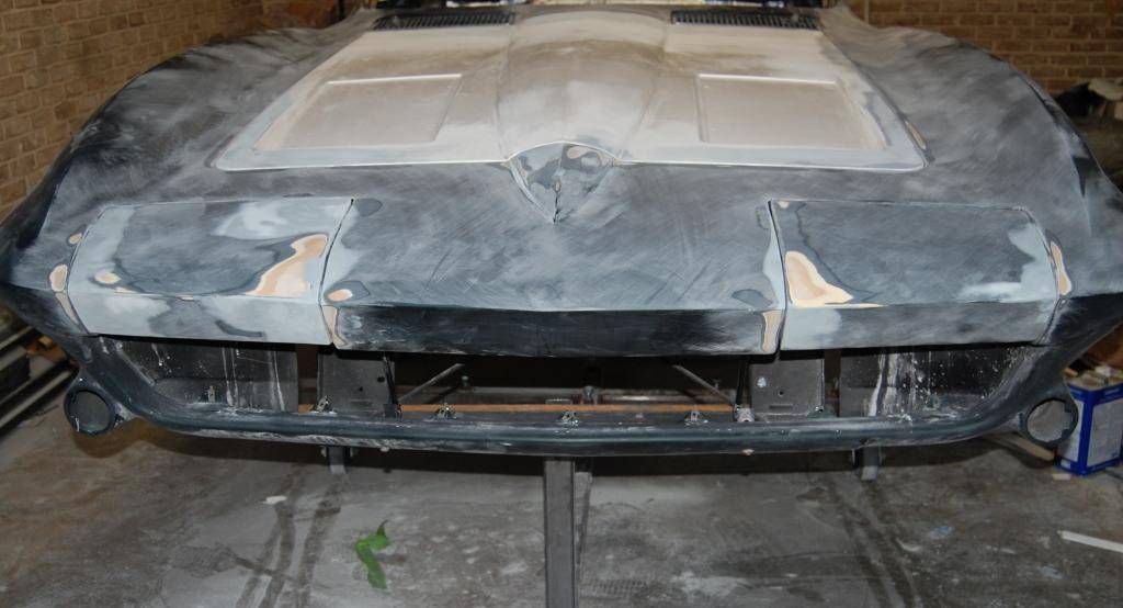

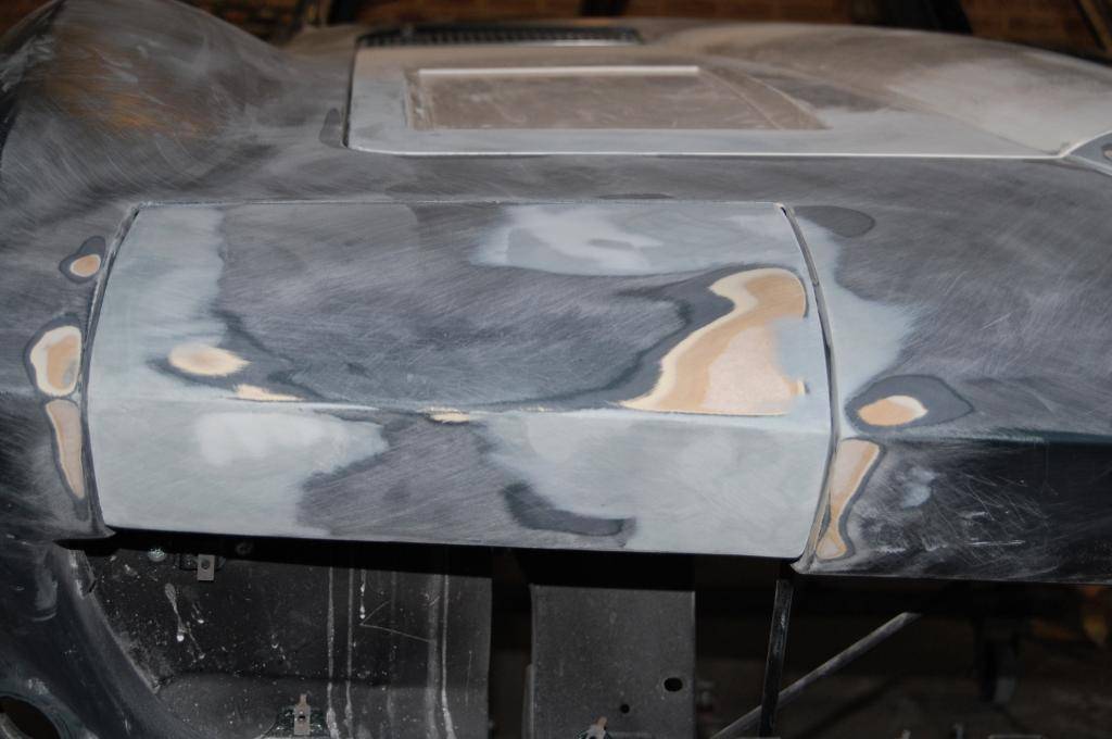

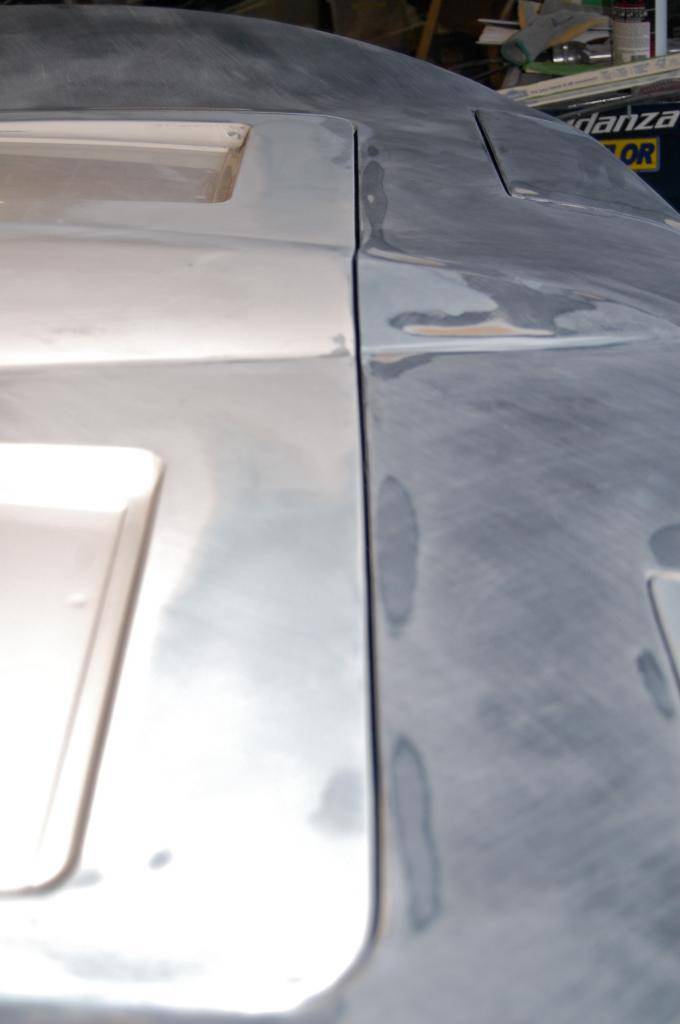

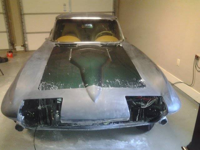

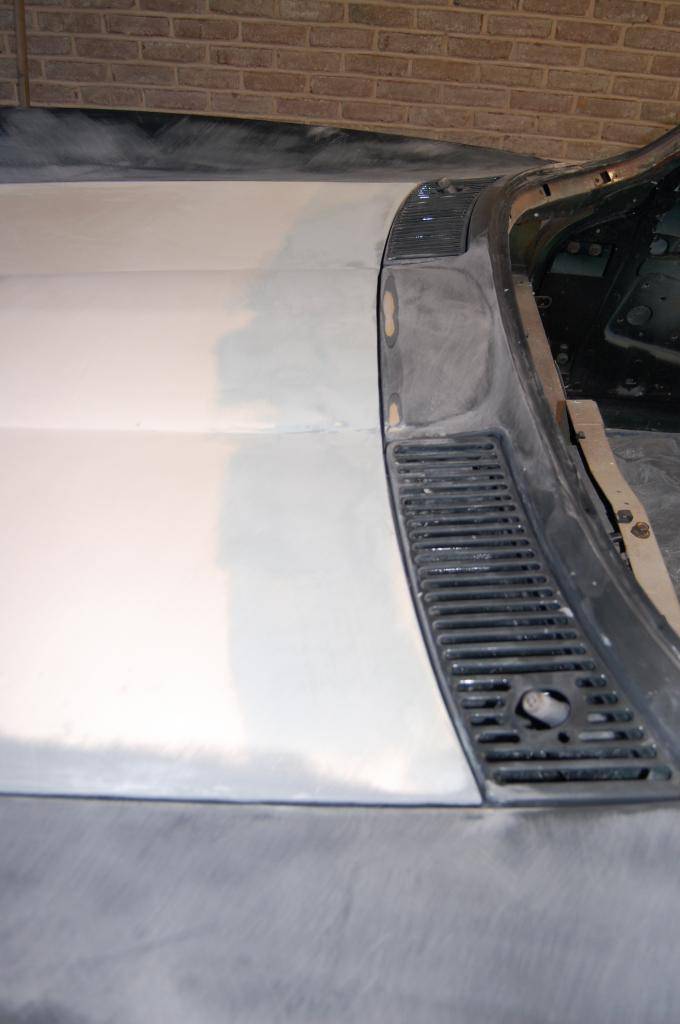

      119 hours Oh yes, i am starting to have a whole new appreciation for people that do body work day in and day out. Miserable!!! I have a vicious case of tennis elbow from fitting the hood! A lot more sanding ahead and then i need to finish fitting the passenger door. After that, the car will sit inside for 3 days to let the fillers completely cure under normal heat conditions. Then it will be time for it to go out in the sun for 3 days before the car is sprayed with Epoxy primer.
      IF you purchase a new hood, order it in two pieces and bond it together yourself with 3m panel bond.
      This was the worst fitting spot on the hood. This was not a low quality hood either, it is from sermersheim.
      Before
      After
      Before-Zero space on passenger side
      After
      Front Before-No space and sat way too low at front edges.
      After
      Driver's side before-too wide
      Driver's side after

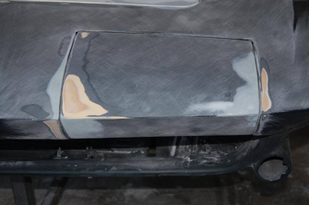

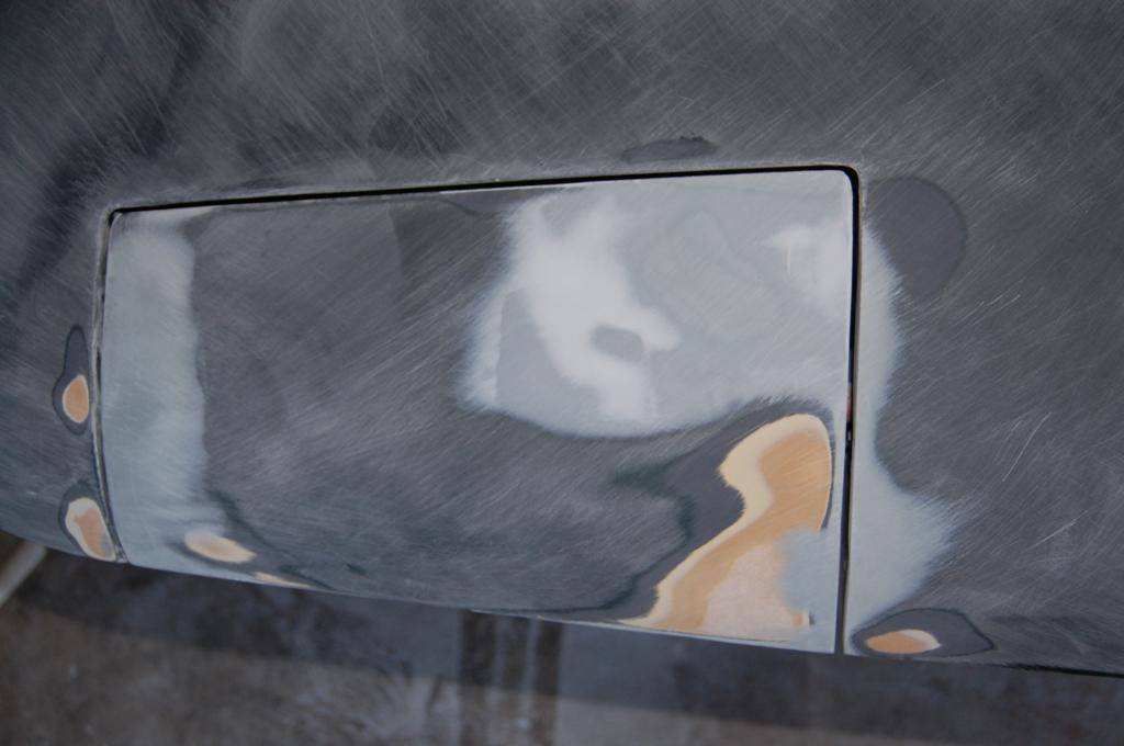

      Had an issue with the headlamp bucket...the casing was too narrow and the bezel was to wide. So, i has to shave the edge of the bezel and build up the casing. Once i had it properly aligned, i had to build up the inboard corner and the front of the casing at the lower nose portion of the surround.
      Before
      After
      Both Required attention, but the driver's side was not nearly as bad.
      Front of driver's door is finally finished
      And a few more of the front end and hood fitment.
