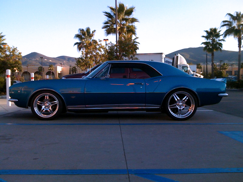

      Rushforth Rated-X
      Front: 18x8, 4 7/8" backspacing, 245/40ZR18
      Rear: 19x8, 4 1/2" backspacing, 275/35ZR19
      Front lowered 2", rear lowered 1.5"
      - David
      1967 Camaro - In remembrance of my friend Scott
