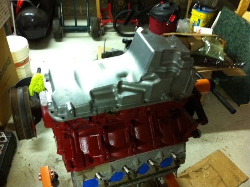

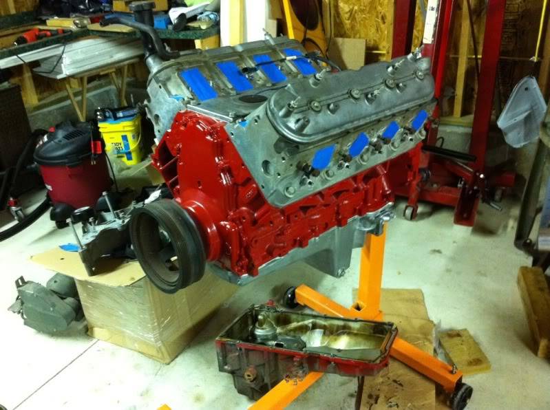

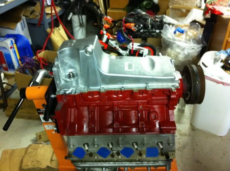

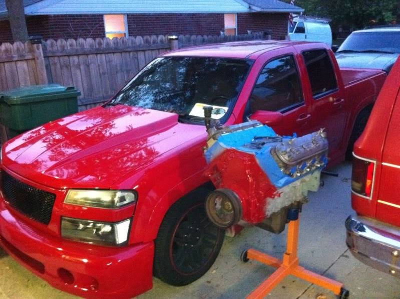

      Still need to paint the heads, valve covers, brackets, water pump, pulleys, etc....
      Not sure how I'll do the fast intake

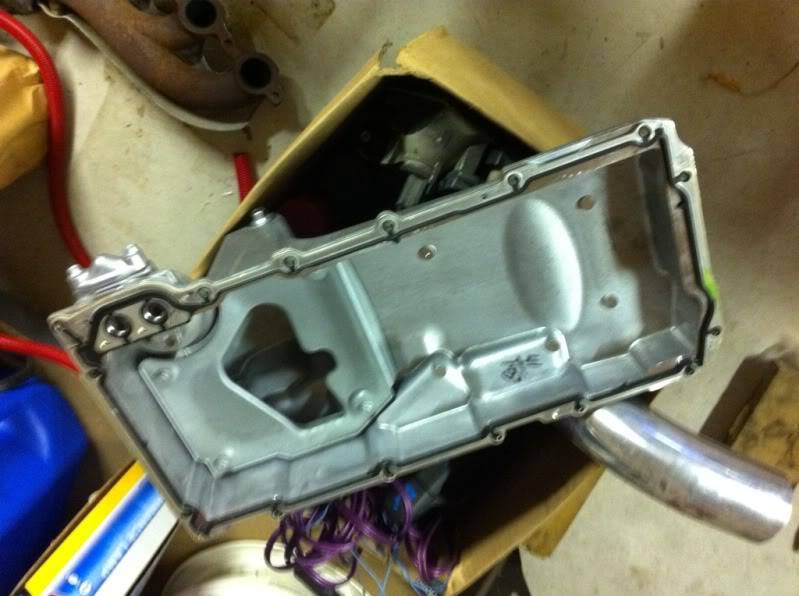

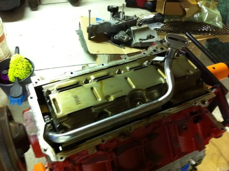

      Swapped out the oil pickup since I have to use a LH8 oil pan (colorado/canyon/h3) since the silverado one won't work, and the oil pickup was too long so I had to use a LH8 one. However I did get a new windage tray but I saw no need to swap it out.
      LH8 pan, it will be staying the cast aluminum color
      and another reason why I can't use the pan

      Couple new items that came today

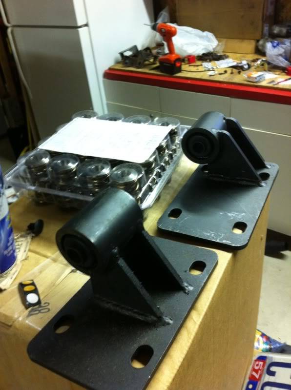

      Looking good Geeds.
      Is there any particular reason you went with aftermarket engine mounts vs OEM?
      Is the chassis/k-member different?

    11. #171
      Dayton Ohio
      1,283
      Quote Originally Posted by bonecrrusher View Post
      Looking good Geeds.
      I got them in a package deal with the cam, rods and springs.
