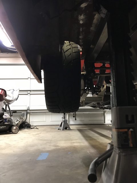

      My apologies for the lack of updates. I spent the holiday shut down from work doing honey do’s and modifying my daughters wagon. I lowered it 2 1/4 inches. Came out pretty cool. Need to give it an alignment and make a pad for her to sit on.
      This was the stock ride height. Name:  56598767664__563B6BB4-76BB-41B1-A983-F6F256A1FB16.JPG
      Hope to get some progress pictures for y’all on the truck after this weekend.

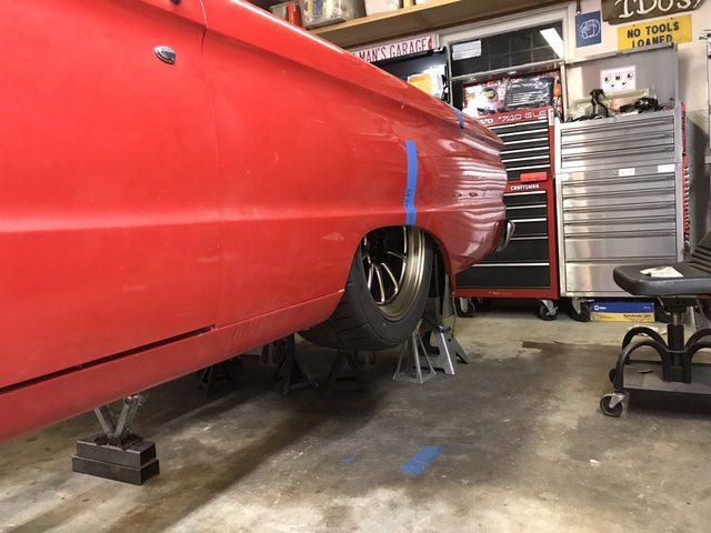

      Progress has been made!

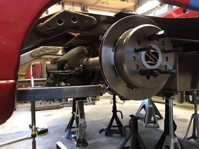

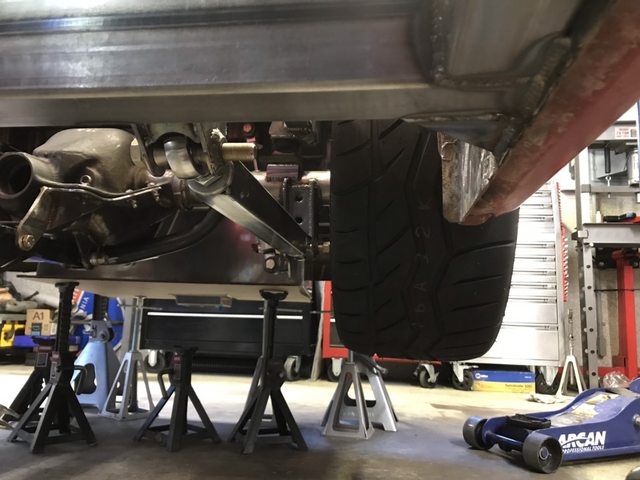

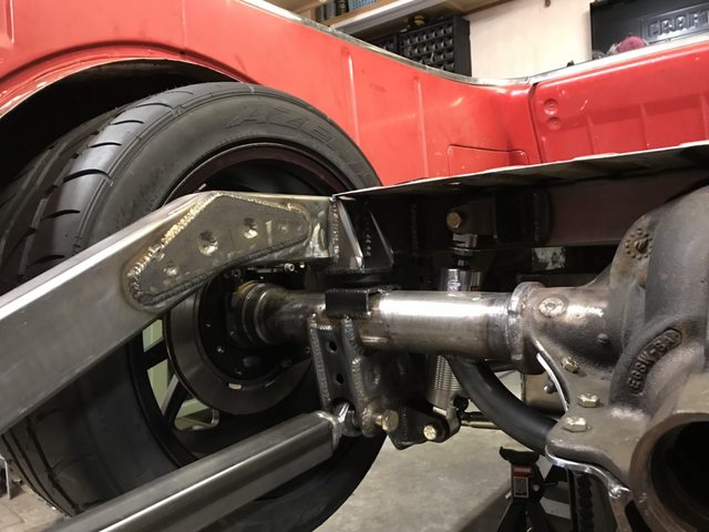

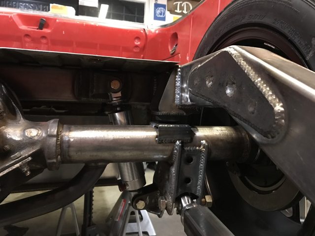

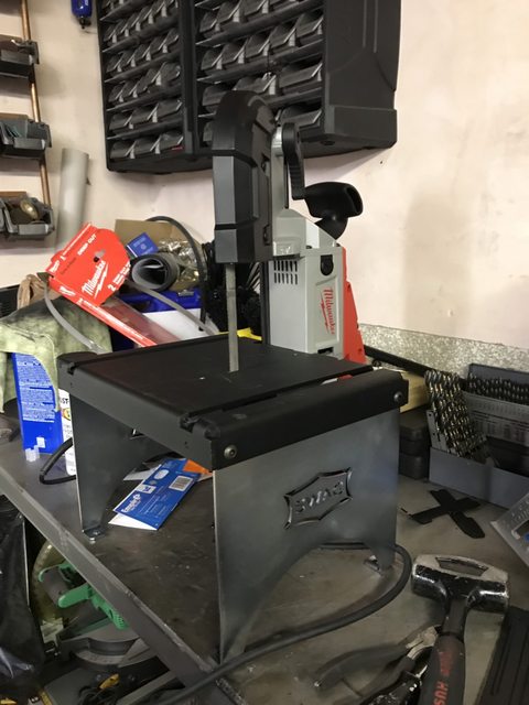

      I got the bump stops made and welded in. Let me tell you, the Swag Offroad Portaband Table (http://www.swagoffroad.com/SWAG-V40-...able_p_63.html) and Milwaukee Portable Band Saw is a life-saving combo. I wish I got these earlier. Don't mind the Christmas morning mess on my workbench, but I have to say this is one of the best Christmas presents I have ever received.
      After I got the bump stops welded on, I welded all the tabs to the rear end and sent it off to Bob Myers Race Cars to get straightened and to have him “Super Missle Weld” the torque arm tab to the cast axle housing.
      I promptly started installing the Strange axles and Wilwood brake kit. In the axle went, and let me say; on the floor by myself, that was a job to do. Once everything was in, I got a little excited and felt that the wheels should go on. Well, there was a learning curve, to say the least! Rancheros are hard to get the wheels on as it is, then set the ride height to your car at 6-⅝’s to really have some fun. The watts link and the rear shocks have to get pulled to get the rear end low enough to slip the wheels on.
      As all learning curves, I found the wheels are hub-centric, not lug-centric. The axles and the rotors fit snug and almost flush, so there needs to be a way to remove the cap and get a ring or something to extend the hub so the wheel has something to center itself with. I will sort this out and keep moving on the rear end.
      The next items on the list are to mount the rear anti-roll bar, mount the rear fuel cell, and then install the wheel tubs.

      Looking awesome , your shot of the rear wheelwell/tire & wheel reminds me of Aaron Kuafmann's Falcon .
      I have the same Swag / Milwaukee combo and I love it. I was ticked that the saw didn't come with a blade. If you don't have one already , I suggest getting a riv-nut tool. Another must have .
      https://www.amazon.com/Astro-Pneumat.../dp/B003TODXQW
      Mike
      Dude I felt the same about the blade. Got one ASAP!
      I just got a rivnut tool! Going to be using it like crazy. I’ll end up tacking them in just to be sure.
