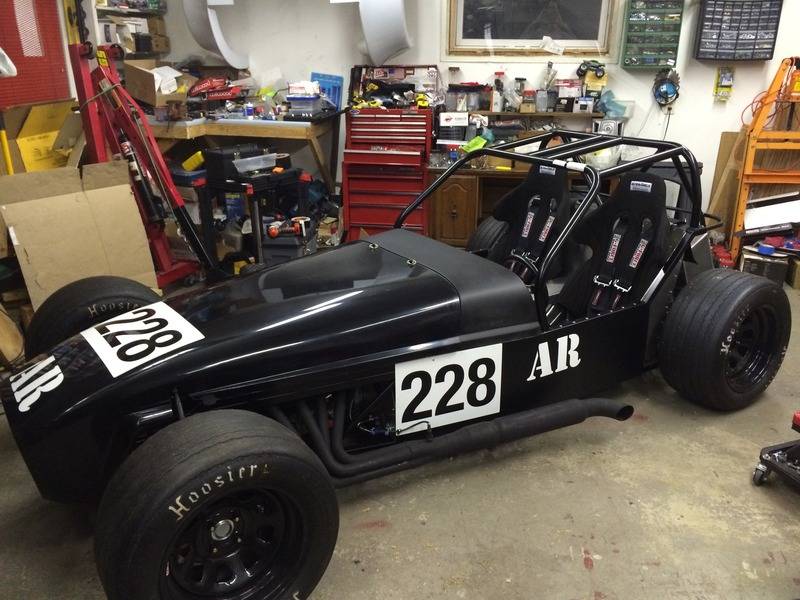

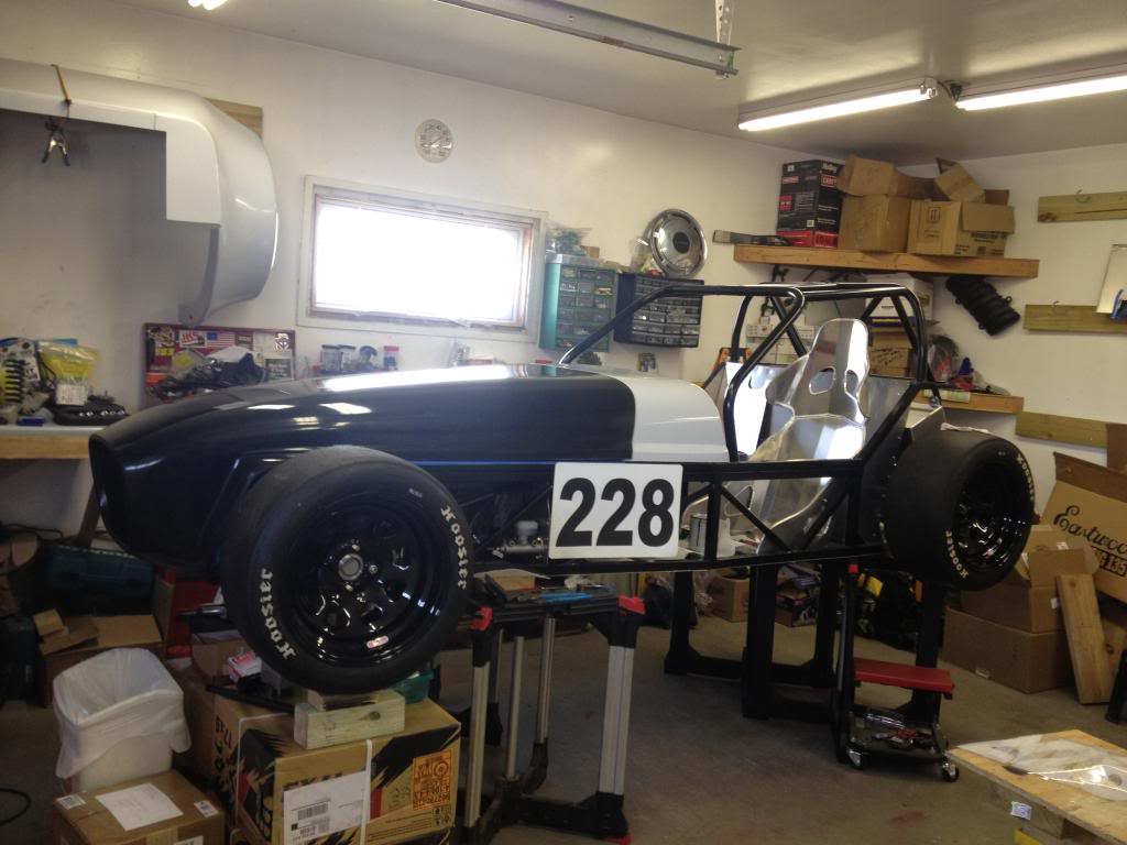

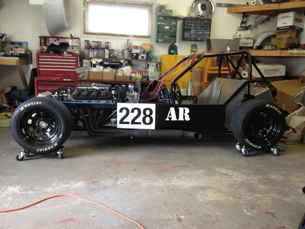

      One day, for inspiration I slapped on the hood and some of my magnetic racing numbers (that will be of no use to me on the fiberglass and aluminum skin).
      The bad news is the classic hood, does not clear the pushrod suspension...

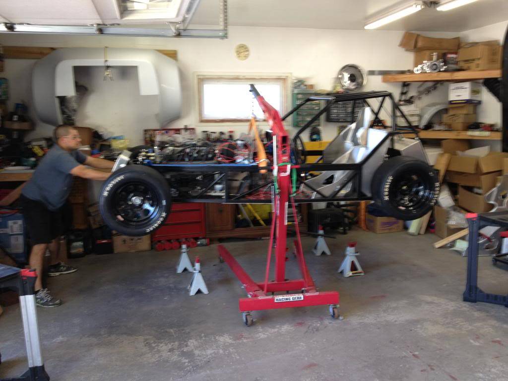

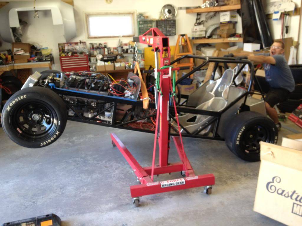

      A racer friend of mine came up from Chicago to align the car with me. So down from the tables!
      This one is fuzzy, because I took it quickly with my cell phone. He was more than a little nervous about me stepping back for a photo op at this point!
      Down safe and sound, time for a fun (giant wheel-stand) photo!
      Got it aligned, but... I chose the middle height points for the control arms. With the oil pan being the low point... I could not run over a 2x4 laid flat with my 23" race tires... Doh, one step forward, two steps back seems my pace...
      So, I had to take the whole suspension off and go to the highest (lowest pick up points - still not very high) settings. Now I need another alignment....
      I was inspired by having my number on the car, so I had the side panels vinyl wrapped and added the 228 placards and "AR" for my class (A-Race).
      Then I installed the side pipes and see they are a little close for comfort to the vinyl. I bent out the passenger side as it had even less clearance. Time will tell. I'll keep a fire extinguisher handy when I start her up! May need some heat wrap. Open for suggestion here.

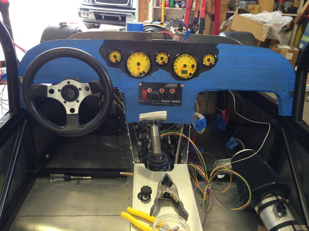

      As you can see, we also started the wiring. Since I decided to keep the air intake on the shelf, my battery placement was compromised. I wanted it under hood to avoid extra safety equipment. The solve was to recess it into the shelf, and actually bolt it to the passenger side of the trans tunnel. I used an Odyssey battery and their aluminum box. I suggest you go direct with them, they were a pleasure to deal with and give a great direct price!
      http://www.odysseybatteries.com/main...ccessories.htm
      I'll get a pic of that up when I finish up the wiring.

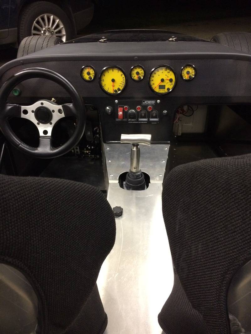

      I went with Speedhut's new CAN-bus style controls that pick up signal from the ECU, eliminating the need for extra sending units. I also ponied up for the GPS speedo. It has all kinds of cool toys like 1/4 mile times, 0-60, etc and will not be effected by differing street and track tire sizes. I chose to have the fuel gauge in the speedo. This should be cool watching one go rapidly down, while the other climbs! You can fully customize your set up. I went yellow. Hey, they look good on a Ferrari, and more importantly should be easy to see.
      The blue tape was to protect the dash panel, but may have to stay. I dig the contrast!

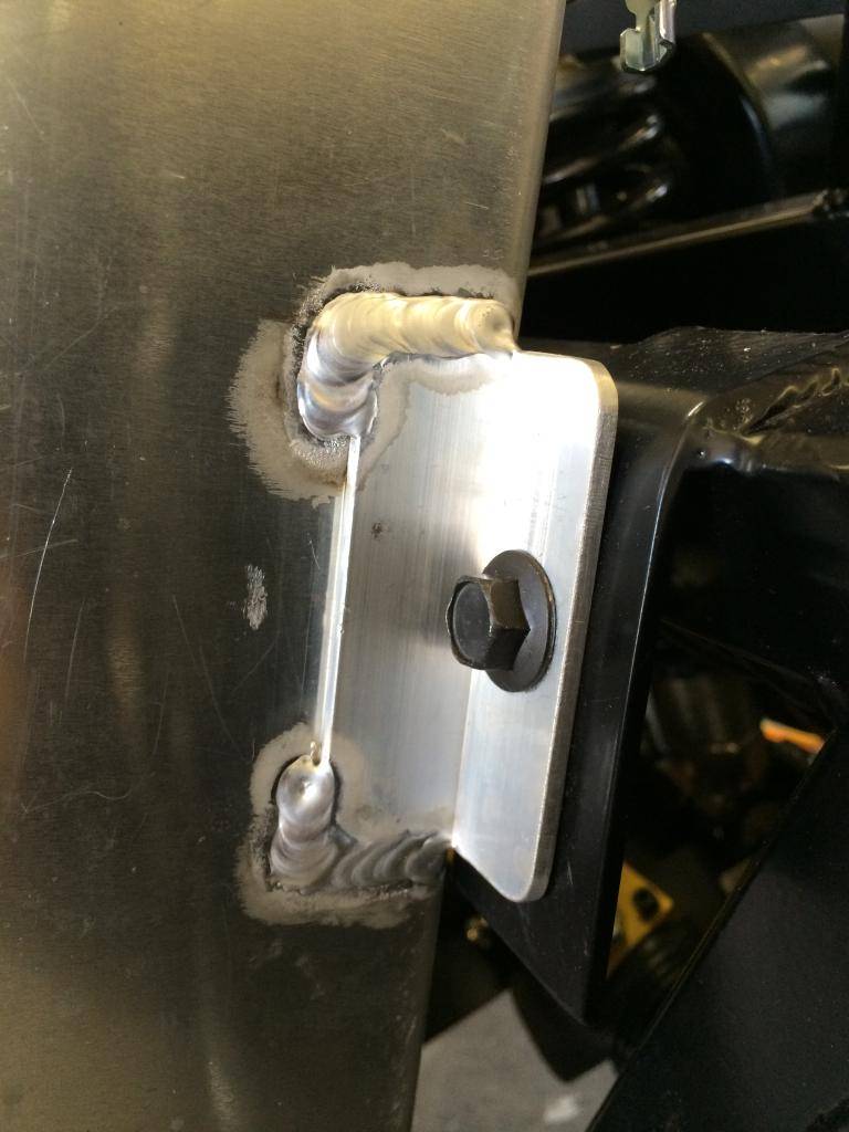

      So, as per past practice, another issue bit me. We added the radiator and struggled a lot to build hoses to fit the tight chassis. After paying for a bunch of AN stuff that would not clear, we ended up with heavy duty industrial hydraulic type stuff. The local industrial hose shop was a huge help. We filled it up with Evans water-less coolant. I come back from a few days of vacation and find some coolant on the floor. Just a couple drips mind you, but more than I would expect with all new parts... There was a pin hole near the welds on the tabs.
      After I quite sobbing, I tried epoxying it. However, not wanting to take 2 steps back, I tried to do it in place with out draining the coolant. That didn't work. The coolant made it's way through the epoxy and formed a new pin hole... twice! Today we drained the coolant, wire wheeled off the epoxy (Quick Steel) and re-did it without coolant. That seems to be holding. Wish me luck!

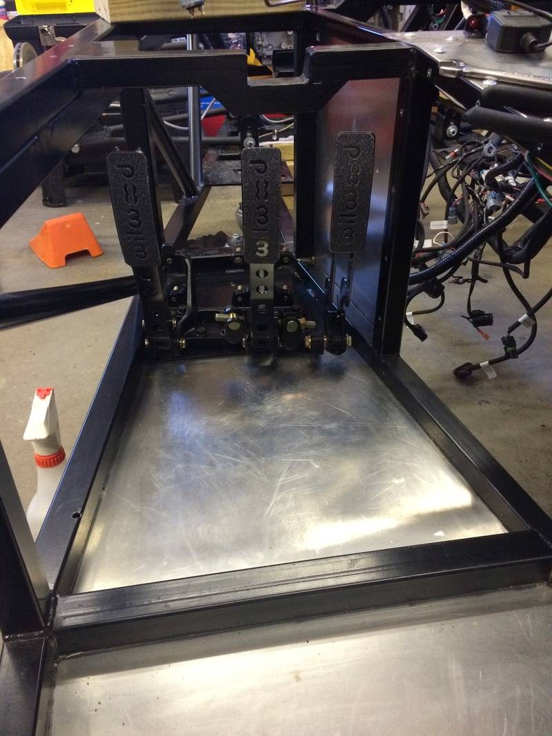

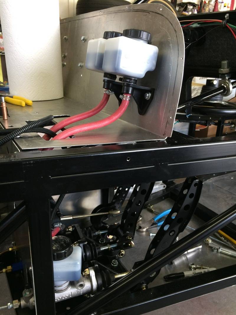

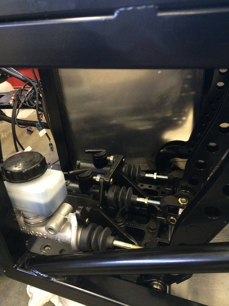

      After much thought I took a chance on Wilwood's dedicated pedal set up. I felt this was an area worthy of improvement. Firstly, I was experiencing front brake lock up that I could not work out with the adjustable proportioning valve (limiting pressure to the rear). I was also skeptical of the need for power brakes on the car. I was already in love with the manual steering, and wanted similar feel and feedback in the brakes. I also like the spartan nature and effort required to hustle the car around.
      Anyway, I probably should have taken better pics of the original set up. I was never truly satisfied with the pedal placement. Original set up included a Wilwood pedal for clutch, another for brake, and a custom set up from Brunton to allow a lot of accelerator pedal travel to actuate the "fly by wire" pedal/sensor, that was mounted up on the shelf. Their set up worked, just like I said, room for improvement.
      Here is the Wilwood pedal set up. It looks and feels more race car now!
      I did have to move the pedals rearward to clear the trio. I moved the seat back to compensate, and am overall happier.
      The main draw was going to manual brakes, and divorced two master cylinders for the front and rear brakes. This also allowed for a balance bar to further tune the bias. Willwood's tech line guy was extremely helpful! At his recommendation I went with a 3/4" front and 7/8" rear master cylinder. I kept the original wildwood master cylinder for the clutch (in fact we kept the hydraulics in tact with the motor pulled to avoid the pain of bleeding again). Engine out allowed for much easier brake line modification as the brake masters (Wilwoods new mini masters) were on the floor rather than the shelf.
      I relocated the accelerator pedal for the LS engine harness to under the shelf also. We were able to work out a ratio that allows 6" of accelerator pedal travel. A must to modulate the arguably overkill (no such thing) power level.

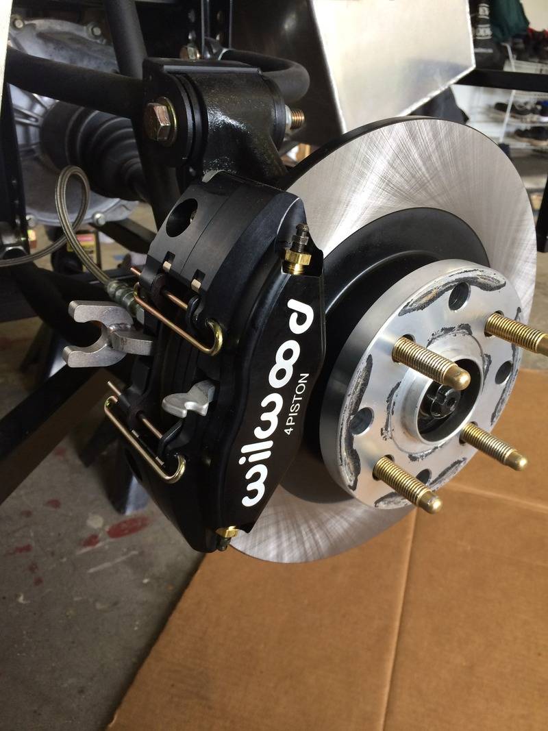

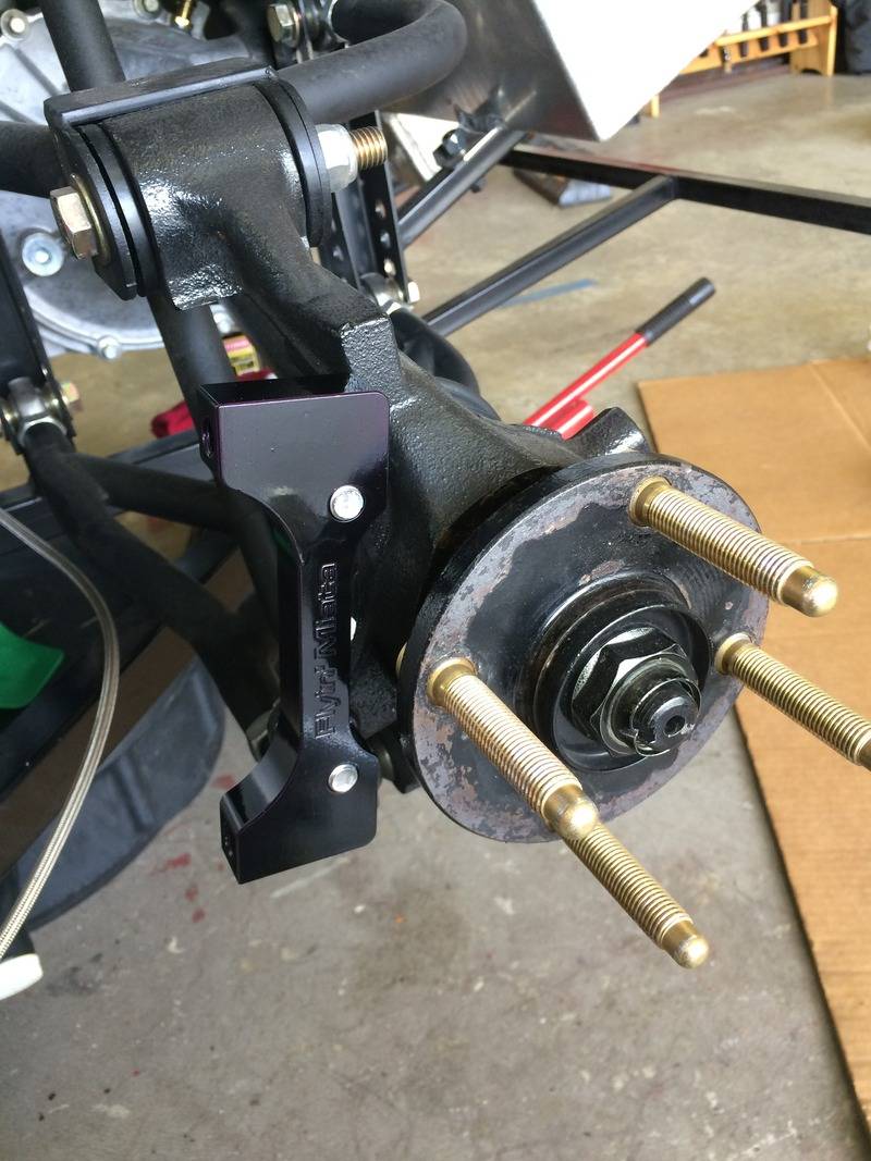

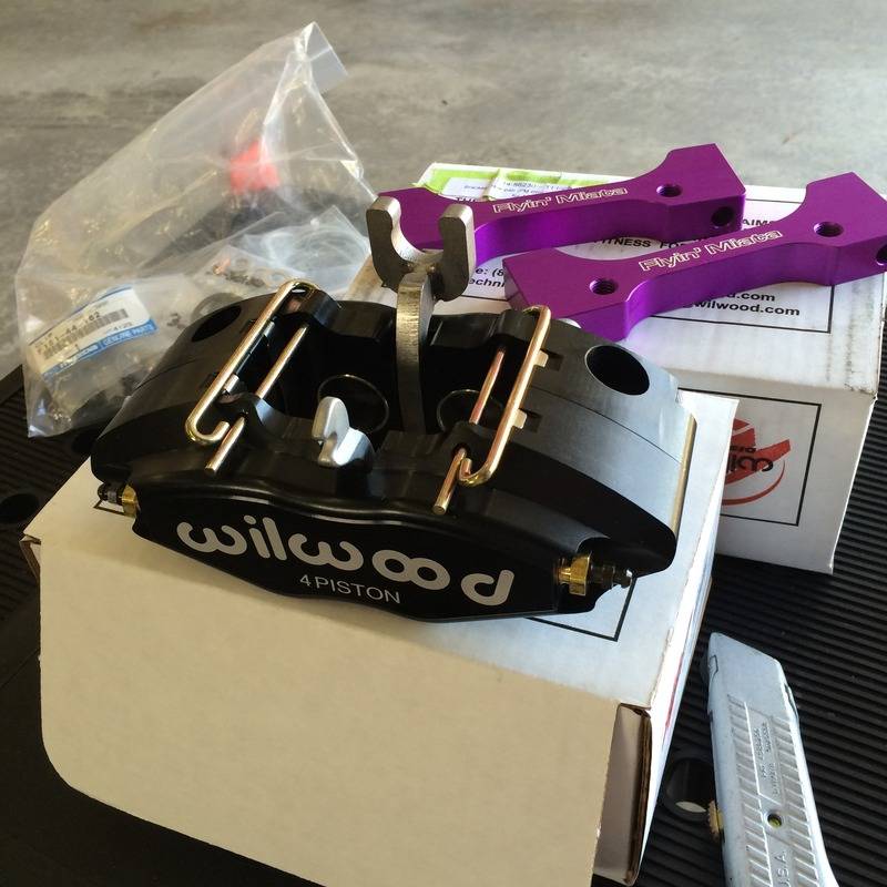

      Part of my brake upgrade also called for a cool kit I found at Flyin' Miata. They machine Wilwood 4 pots to accept an integrated emergency brake. This was a double score as I wanted more brake power, and the OEM Miata calipers oriented the emergency brake toward the tub of the car. The FM kit had the brake cable run straight toward the inside (perpendicular to the rotor).
      I am impressed with the machine work on the kit. I was also able to upgrade to the slightly larger (but still cheap) Miata "sport" rotors.
      The pretty purple anodizing didn't really fit my style, so I rattle canned them black quick prior to installation:
      I also took the chance to install some longer ARP wheel studs. They went in with the hub in place (there is a relief cut out) which was a huge relief (see what I did there?!). I also needed the longer studs. I have to run a 13mm spacer on the front and rear to get the steel wheels to clear the beefy Wilwood calipers.
      I am now running Wilwood BP20 pads front and rear. So far so good. No issues with fade whatsoever (during 20 minute HPDE sessions). Gotta love light cars!

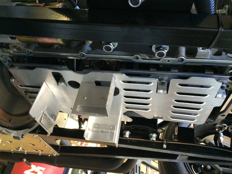

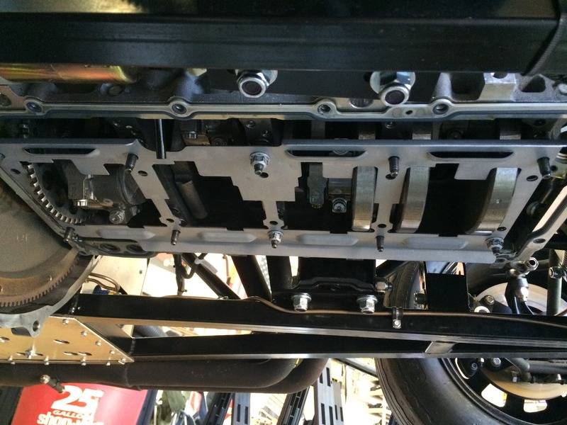

      Another off season add on was to add some oil control. I had not yet noticed an issue, but guys with fast C6 vettes and another Stalker owner have found the limits of the Corvette pan's baffling. Improved Racing makes a set up to help with this. I figured it was cheap insurance. I considered an Accusump (in fact I have a whole set up I purchased for another LS racer), but for now I want to avoid the complication and room it would consume.
      Of course I put off the undesirable task of dropping the pan until the day before my first event of the year (an HPDE at Blackhawk Farms).
      The Improved Racing baffle can be purchased with a crank scraper/windage tray for the 6.2.
      While I was at it I squirted the white cowl black w Plasti-dip (love that stuff) and threw on the seat covers (I raced it last year with bare aluminum seats). Looking sinister!

      I came back after a tire and brake change this season and have set FTD at both events running a 1:19.062 at the first event and a 1:17.321 at the next! I think with some aero, seat time and stickier tires that GTR's record may fall! Again, for reference the 2nd fastest car at my recent event was brand new Z28 (GM's new track toy) and it ran a 1:20.xxx. Man was it fun passing him and Z06 Corvettes in the HPDE that weekend!
      1/4 MILE DRAG STRIP
      I know these cars are not set up to be drag racers, but with the power to weight I knew it would be fun.
      In 2014 I ran at a cold autumn open track night. Tires spinning well past 1/2 track I ran a best of:
      12.336 @123.84 mph! *Not bad, but due to some issues I was not able to do a burn out, and the road race tires were not ideal. My 60' was 2.261...
      This year I went back, still on my vintage road race 25.5x10.0x15 Hoosier bias plies, but this time I had a warmer track and did a good burn out. *Best run was:
      11.429 @124.01 The big difference was the more respectable 1.815 60'.
      I have some drag radials coming. I'm hoping to be in the 10's next time around.
      WEIGHT
      A racer friend let me borrow his scales this week. My car is a M-spec w the classic hood, an LS3, and T-56. I'm a little heavy though with the 15x10 steel race wheels.
      1711 pounds with fluids (not quite full gas tank).
      Empty it has a 50.5/49.5 front/rear balance.
      With me in the car it weighs 1894 with a 47.7/52.3 weight balance.
