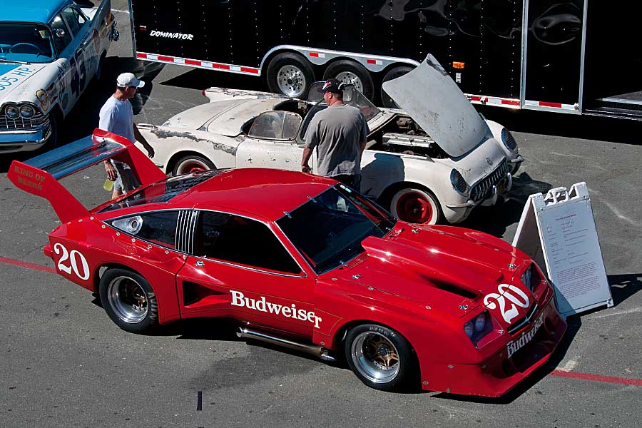

    8. #28
      Jun 2012
      South Lyon, MI
      1,244
      I really like this Monza. The new hood has a lot of venting for the radiator. I plan to copy this to some extent.
