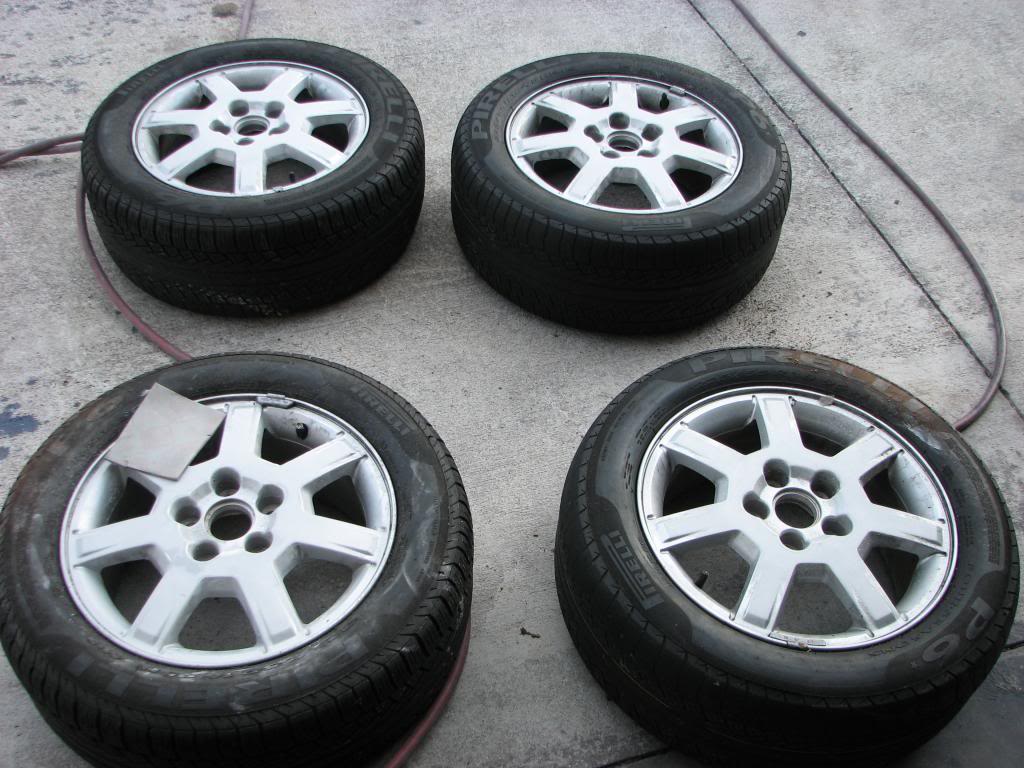

      I got this car for free from my Dad when my Yukon broke. He had just bought a newer DTS but luckily for me held onto this. While I was very grateful I knoew I had to do something about the looks. The car came wit some CTS wheels I had got for my Dad when it was his. But when the tires wore he just put the hideous stockers back on it.
      Here is a few pics of the day I got it.

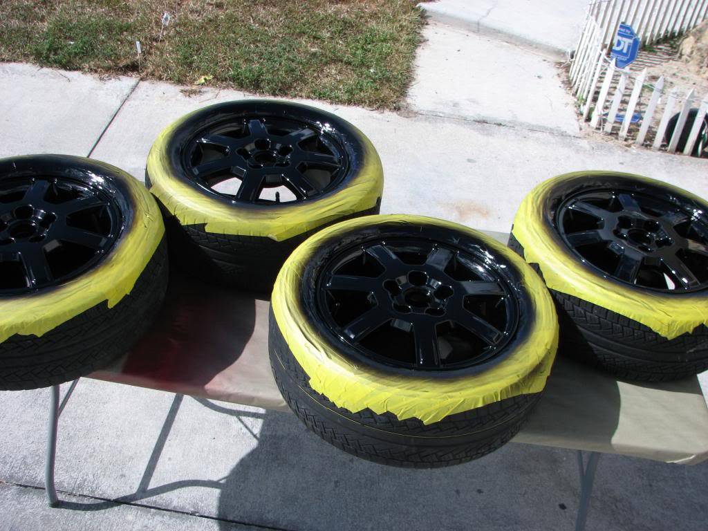

      Very first thing I did was get the CTS wheels out and painted.

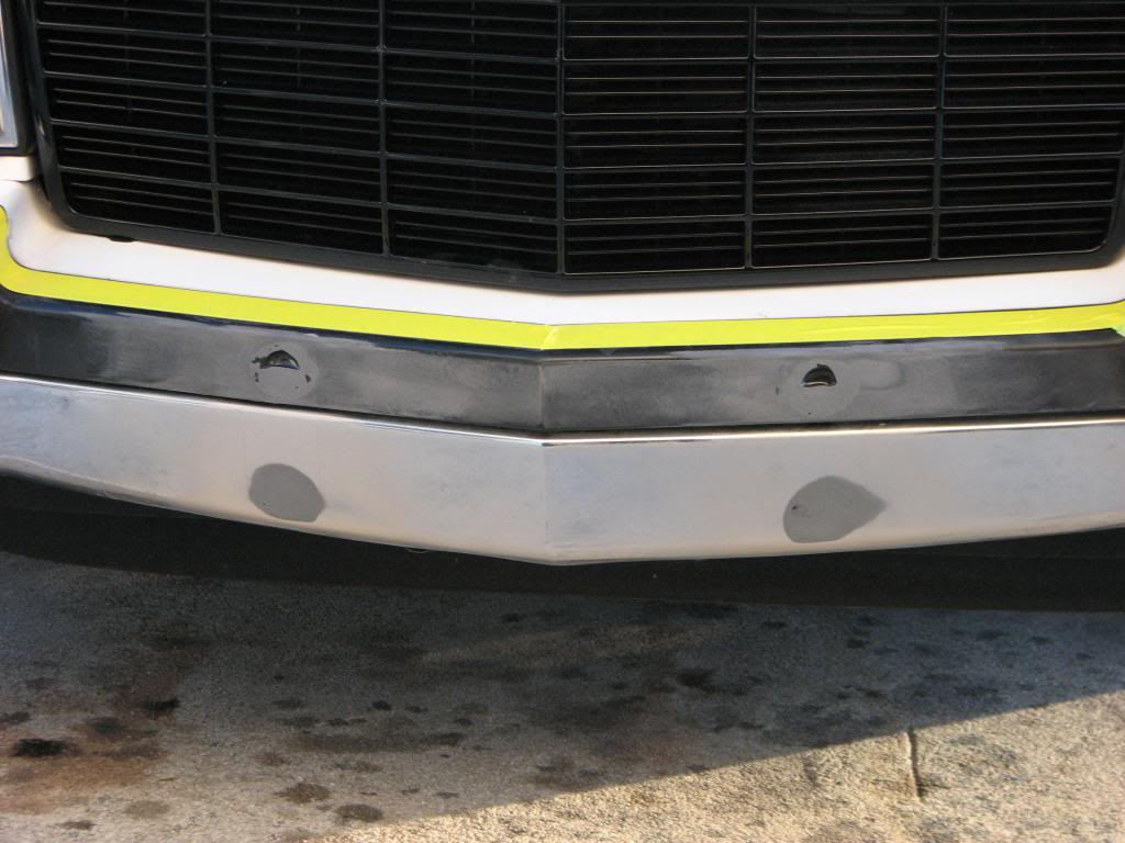

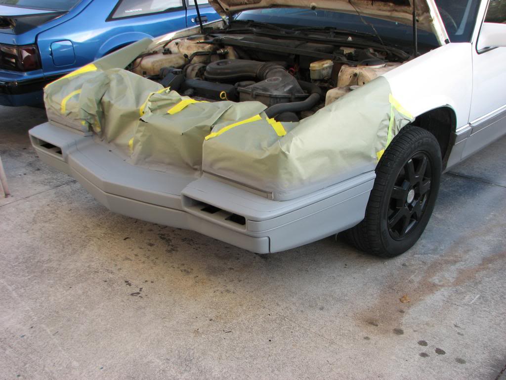

      I still need to drive the car everyday so I can only do small sections at a time. I figured Id start with the bumpers and cladding first. I began with the front bumper, I took off the push bars and began filling the huge holes left behind. I filled the holes with panel bond, sanded, then finished with another layer of putty and primed. After the primer dried I painted the bumper

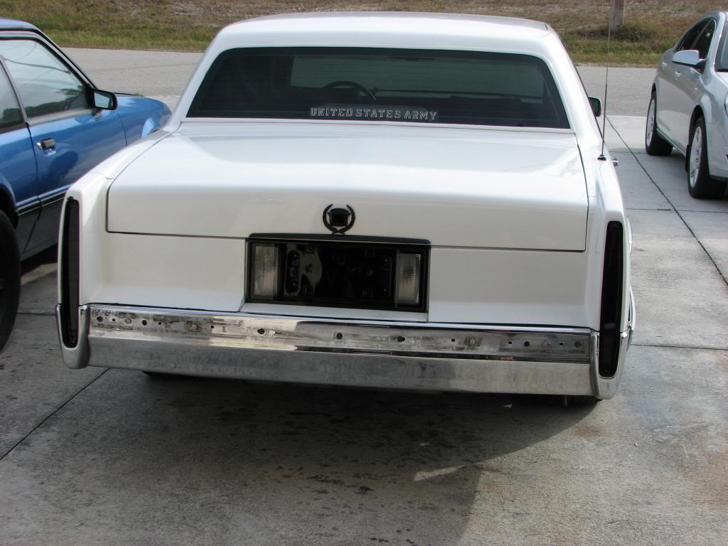

      After that was done I started on the rear bumper and side cladding.
      The bumper had this bar type thing that help some reflectors and it was in real shape. I most likely would have taken this off regardless of its shape, looks much cleaner without it. Only thing that sucked was the amount of holes that was behind it.

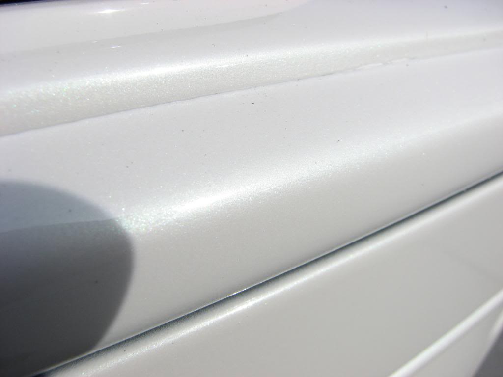

      Here you can kinda see the green flop in the pearl.
