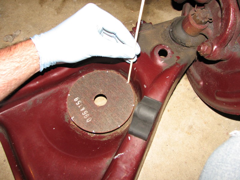

      The AFCO spacers are flat ended, but both the control arm and subframe have tapered spring pockets to accept the pigtailed coil springs. To determine the taper, I took a 4-1/2" cuttoff wheel, which happens to be the same diameter as the AFCO spacers, marked it every 45 degrees, and measured the depth of the taper using some wood skewers. I found the taper to be approximately linear, going from 0 to 1/2" depth around the 360 degrees. You can see here I measured from the lower control arm; the subframe pocket appears to be the same and should be based on the symmetry of the spring.

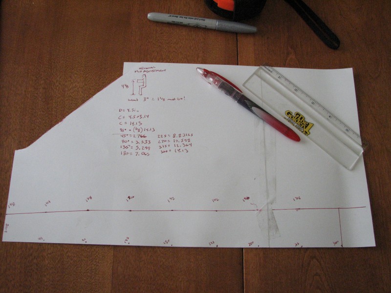

      Next I laid out a template on a piece of paper. The circumference of a 4.5" circle is about 14-1/8", so I had to tape two pieces of paper together to get enough length.
      I cut my template out, wrapped it around the spacer, and marked it as shown below. If you do this be very careful to verify the taper goes in the right direction.

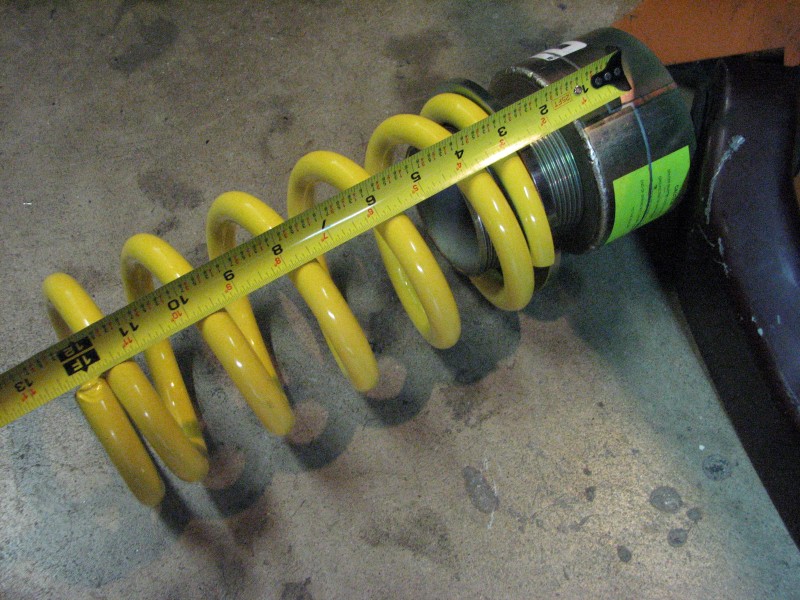

      I decided to lay this out so that when the adjuster was mid travel, I would have a 2" lowered height, trying to replicate Hotchkiss 2" drop height coil springs. The Hotchkiss springs are the same rate (600lb/in) and have a 12.5" free length. To get this, my taper removes from 1-1/8" to 1-5/8" from the AFCO spacers. I can adjust these a full inch in either direction, which translates to about 1-3/4 inches of ride height in either direction (lower control arm ratio of 9/16). So I should theoretically have any where from 1/4" drop to 3-3/4" drop depending on where I adjust them.
      Before cutting, I verified the total free length of 12.5" with the adjusters mid-travel

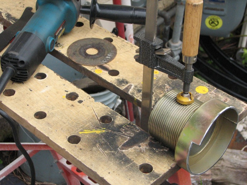

      Then I clamped the spacer onto a folding workbench and made the cut with a cutoff wheel.
      Wala! It fits the pocket with even contact all the way around:

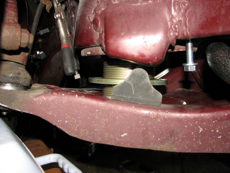

      From what I've seen, people usually put these into the upper spring pocket, citing interference when placed on the lower control arm. I decided to try mocking it up in the LCA and it appears it would clear just fine in either position.

      Another reason those are typically mounted on top is the lower arm travels in an arc, and the height of the adjuster magnifies that arc. You have the potential for the threads to rub against the inside of the spring as the suspension cycles. With the limited travel we see on modern PT type cars, it's not likely to be a huge issue.
      Are you planning on welding the adjusters to the lower arm? Have you tried installing the springs with the adjusters in place.

      Thanks Ray for the added info. I did cycle the LCA with the adjusters in place on the LCA pocket and the "nut" portion adjusted to the worst case position to replicate he spring (the OD is very similar). There was actually quite a bit of clearance as the LCA moved through its arc so I think you could run these on the LCAs if you wanted to. I just found it more awkward to install the adjuster and spring in that situation so I decided to mount them to the upper pocket with just the stud. Having the stud on the adjuster makes it easier to line up the rotation of the helix in the blind assembly of the subframe pocket. I have completely assembled one side with the springs and spacer (in the upper pocket) without issue.
