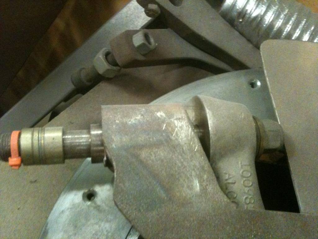

      I'm with you about a welded steering arm. I built this for a customer several years ago. The rack was lowered, requiring lowering the tie rod point. I wasn't comfortable with a long pin from the existing tie rod hole. I think it has way too much mechanical advantage on the spindle. This is a C4 spindle. I machined a pin that has the correct taper to seat in the tie rod hole. I machined the remaining pin straight to fit the hiems and spacers. The bracket I built is only a support for the pin, with a DOM sleeve that is an interference fit. I know it added some weight, but I chose this route so that all the parts were still common readily available stuff. The pin and bracket are not a concern for wear or replacement.
      That's a really good idea, Craig, I try to stay away from the hot rod stuff as much as possible (sorry if that offends) as much of it is quite literally for show and an occasional cruise. If a steering arm broke on a track...that's my a$$ in the grass and I'm too old for that sort of thing to be remotely funny anymore.
