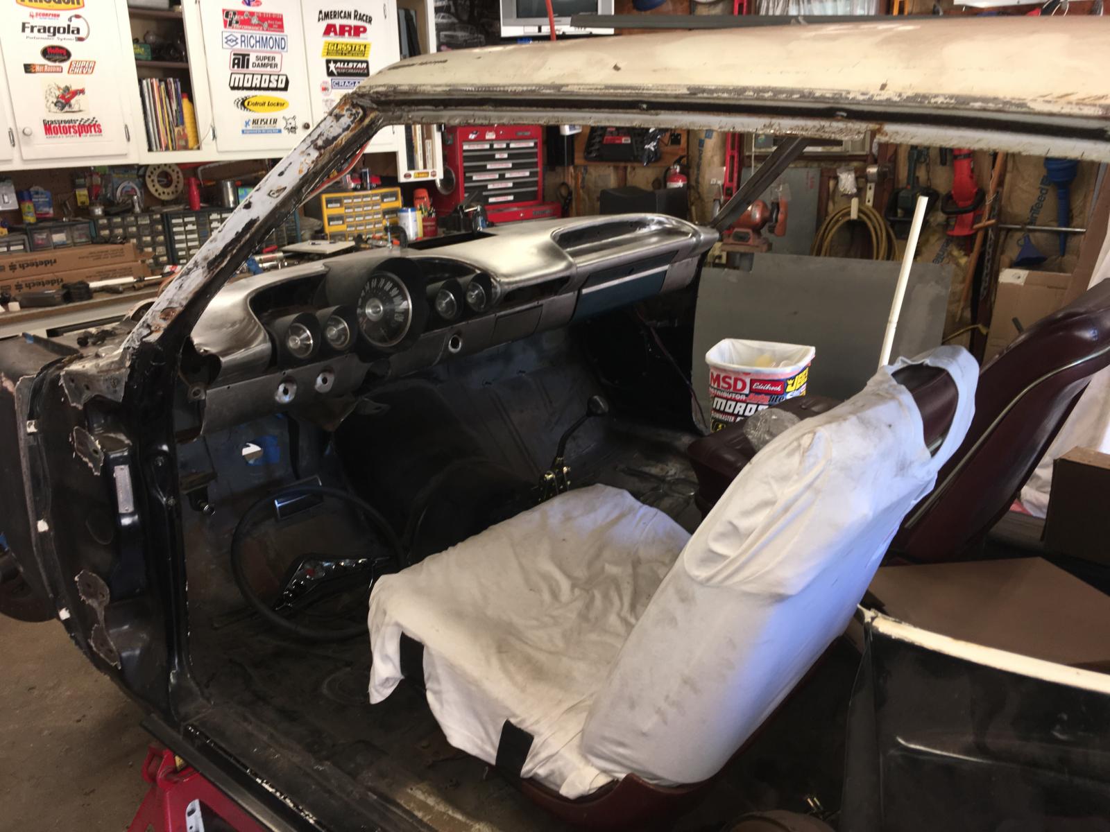

      Well, I’ve been back after it. I plasma cut out the stock dash and got the ‘59 Impala dash mocked up in place. My brother patched the floor shifter hole because I bought a Lokar floor shifter as I’m now going to build a custom center console.
      Also re-did the front shock mounts and then pulled all the front suspension off. The rear end is out as well so I can finish prepping for paint/Lizard Skin.

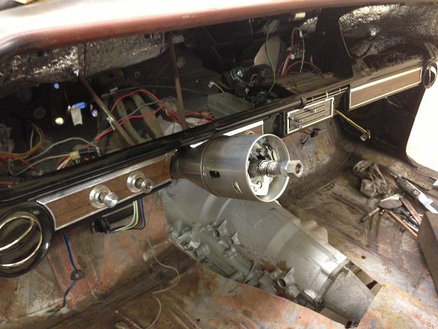

      Quote Originally Posted by Cowansauto View Post
      Is the column that you used a direct fit or a universal one?
      It is a Flaming River universal 30 inch which fit perfect with the stock dash. The collar hits the 59 dash so I’m probably going to have to go with a longer one or modify the dash. I just have to put the seat back in and mock it up. I don’t want the wheel too close.
