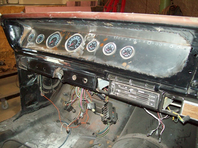

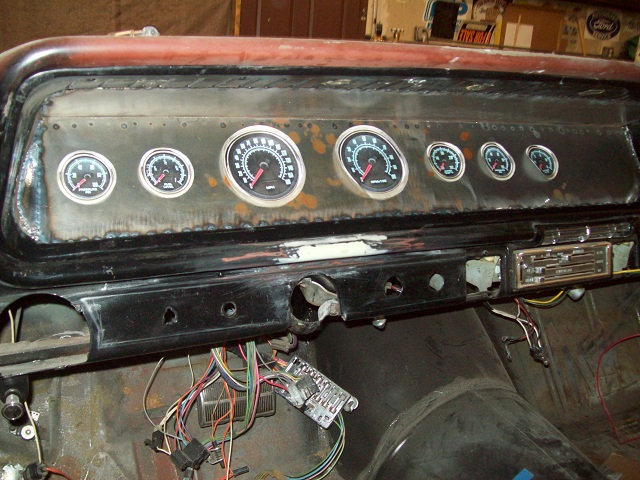

      Sheetmetal is welded into the gauge cluster opening. The long speedo cluster is going to be replaced with several round gauges and the ridetech air suspension controller will be in the space on the far right where the radio used to be. I removed the factory gauge panel on top of the console and I'm planning on fitting a double-DIN radio and custom housing between the bottom of the dash and the top of the console. Hopefully.

      I think once the dash is painted, there is going to be a sea of black paint. It's going to need some contrast to break it up. I was thinking of having a custom aluminum trim panel made to go behind the gauges (similar to the engine-turned panels on 70's Trans Am's-- only different). I'd like to use something like the bowtie pattern Chevy used on the 55-56 Chevy dashes.

      You can also see in the above pic where the notch was filled in where the factory column shift indicator was located. There is going to be one more panel welded in the dash-- the hole for the heat/AC control panel is getting filled as it will be replaced by a Vintage Air control panel.

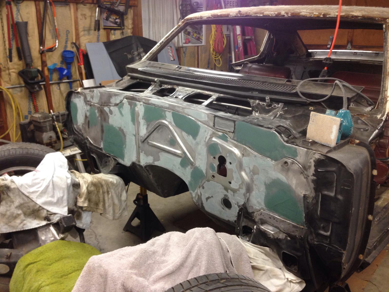

      After way too long I'm finally back at it. I've stripped the firewall down to bare metal. I've decided to keep the seam across the top and leave the stiffening ribs instead of making the entire firewall smooth. The brake booster/master cylinder will remain but the A/C box is gone in favor of Vintage Air, and the wiper motor was shaved.

      After slinging the first round of mud, I'm wishing that I would've cut out the whole firewall and made it flat. I'm already tired of sanding around all the nooks & crannies 

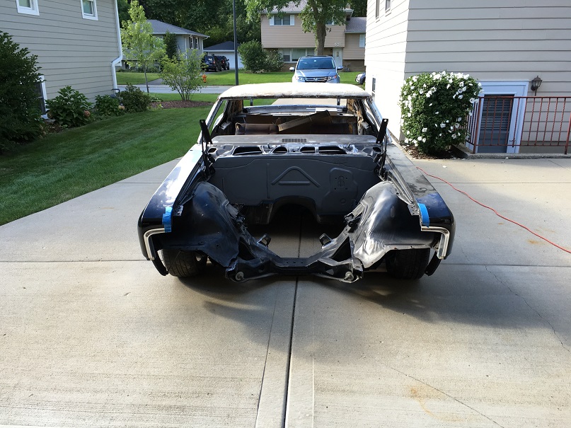

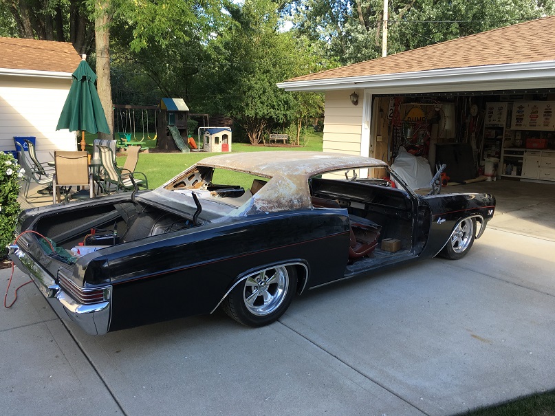

      I cleaned out my garage a while back and found my '66. I disassembled the doghouse (which was taken off as one unit) so I could gain some floor space. Once the fenders were detached, I hung them on the car for mockup. The inner fender rubs the tire on full drop, so I'll have to work that out. [EDIT: No problem, no shims have been installed yet and the alignment is way off. Tires should camber-in on full drop and right now the wheel is level on full drop and cambered out when raised. It'll be fine once aligned correctly]. It was cool to see it looking more like a car again.

      I also got the firewall in epoxy primer. Next step is to clean and paint the front frame and suspension (and firewall) so I can get the engine in the car for good.

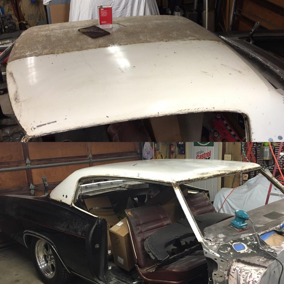

      I decided to remove the vinyl top glue because I couldn't look at it any longer. That 3M adhesive remover and a Scotch-Brite really did the trick, but it gives you a pretty good head rush if you don't have proper ventilation. Don't be like me- open the garage door. ;)
      3 guesses as to which color the car was from the factory. It kinda looks like a police car now, but I'll be painting the roof black before it goes back together. The vinyl top will not be making a return.
