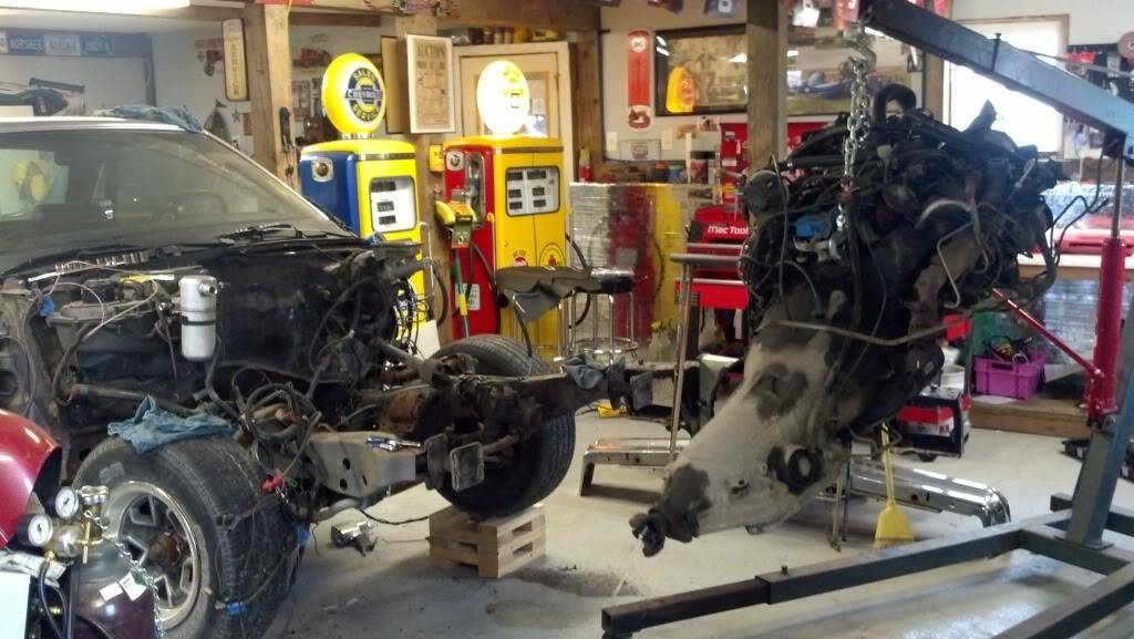

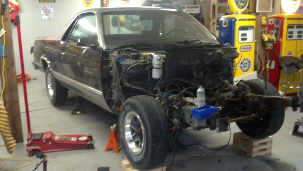

      Here we go again! I'm so pleased with the Schwartz chassis under the Monte Carlo, for the next build Josh chose to do an El Camino. I picked up a very clean 86 with 78,000 miles for the tidy sum of $3700. It does have a repaint so hopefully there are no issue when strip it. The frame is solid which is a good sign.
      The plan is for Schwartz to build the chassis sometime around April. Since the El Camino frame is a liitle different tthan other G-bodies, they will use the old chassis for reference. The frontend will receive an SS nose and cowl hood, the rear will get a rollpan. Josh will do the body and paint as before. Drivetrain will be LSX. Interior will have ProCar buckets and factory console.
      I sold the 305 out of it so it was time to remove the clip and get the drivetrain out. After 4 hours of bag and tag the clip was off.

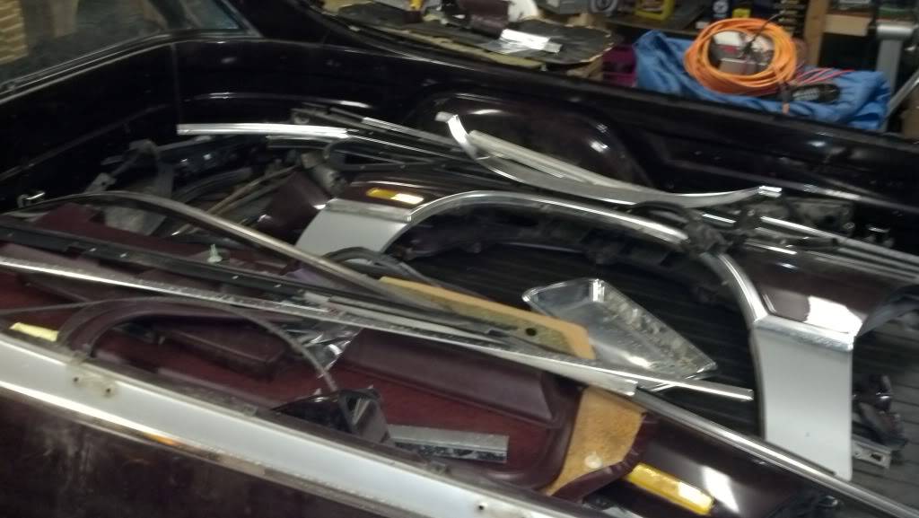

      Josh got some trim off today, gutted the doors and when I got off work we removed the doors.
      Car continues to appear very clean. Found several receipts dating back to 1990 thru 2004 when the previous owner bought it. The 78,000 miles seem accurate according to them.

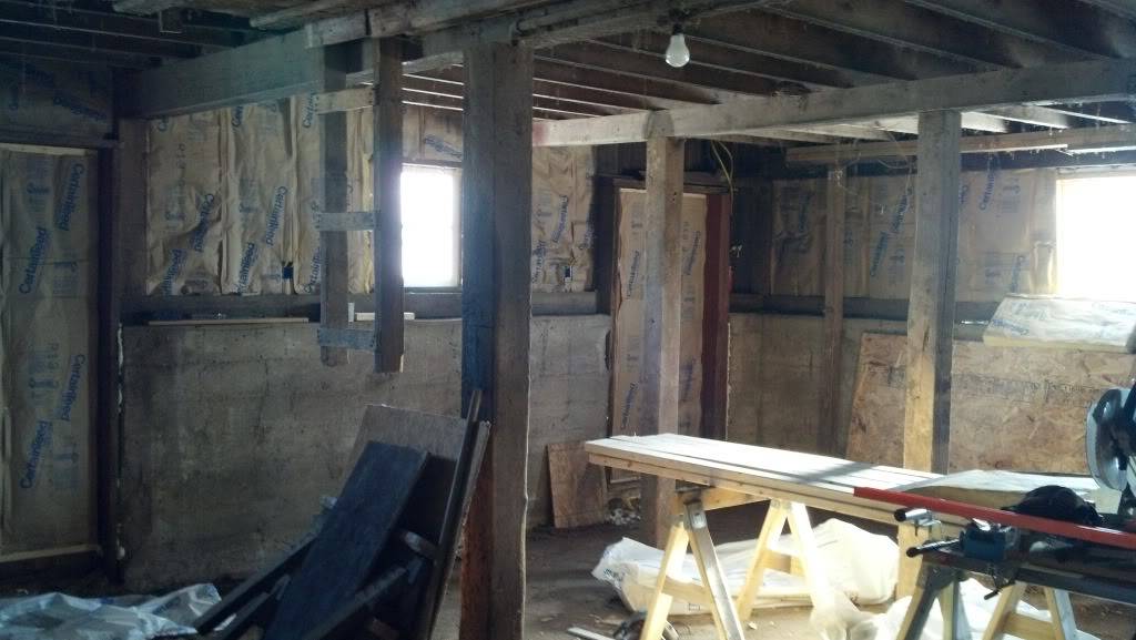

      Next weekend we will hang the ceiling in the other half the barn. I'm running out of room!

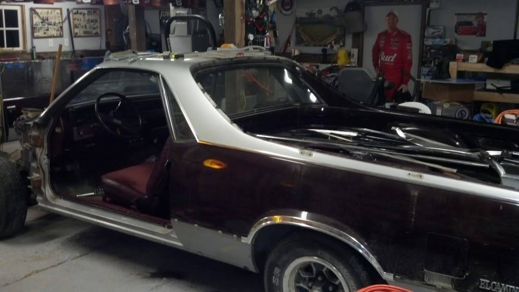

      Interior is out and most trim removed. I'll let Josh do the rear wiindow and the quarter windows. Floors are very solid. It will get media blasted near the end of the month.

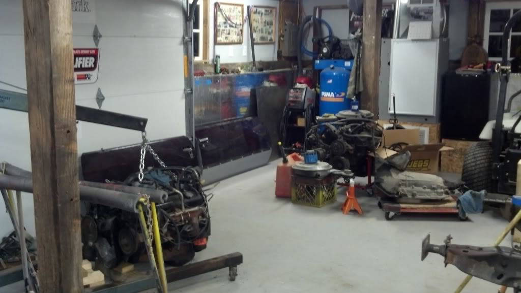

      Schwartz should be ready for it in another 6 weeks. It is ready to go to the media blaster anytime but right now it is blocked in the shed by my Monte Carlo. I spun a rod bearing a few weeks ago in Florida and have it tore down. As soon as I get it back up and running we'll get it media blasted.
