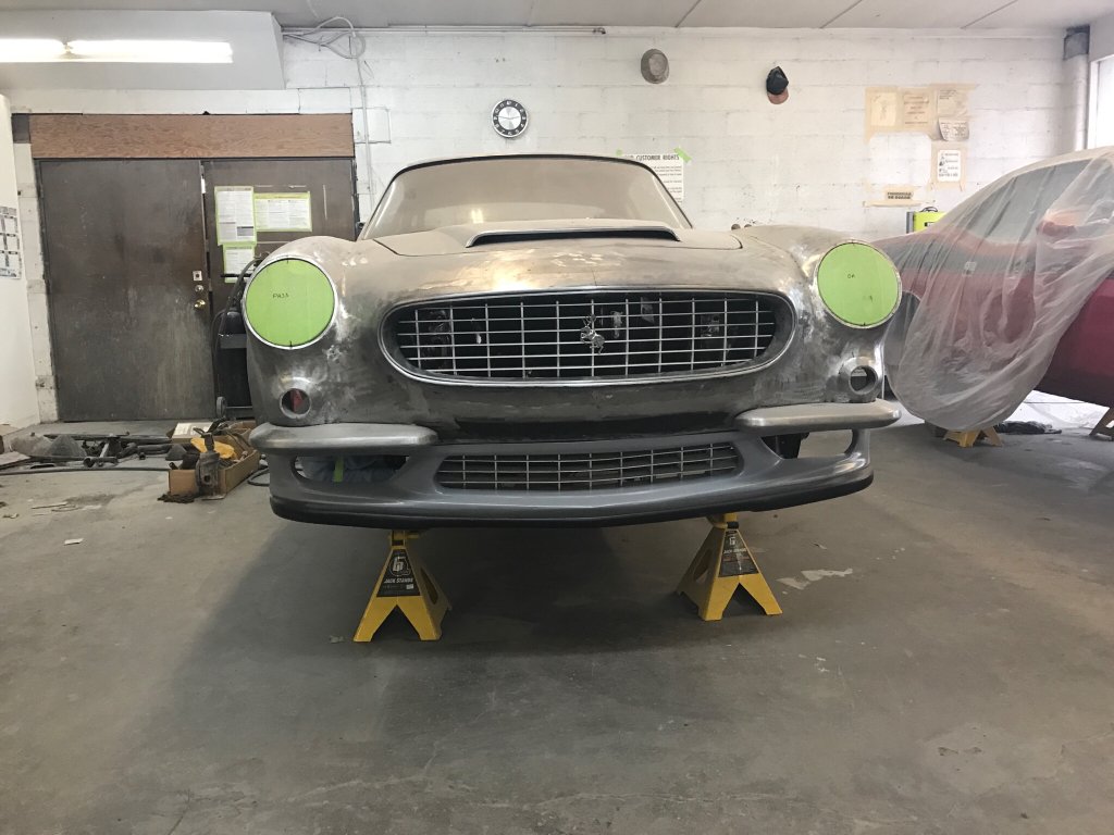

      The front valance has been shaped to better flow with the original grill. We painted the valance with gray epoxy and the splitter black so it would better blend with the car. I think it looks better with the softer edges. It will be nice when it is back on the ground.
      The gaps have been set in the deck lid and they started working on the latch for it now.
      I have not been able to get a profile view of the car for a long time so it was nice to get a glimpse today. When I stood back I did not like the lack of a point on the front bumper so they will be reworking it to better match the rear.

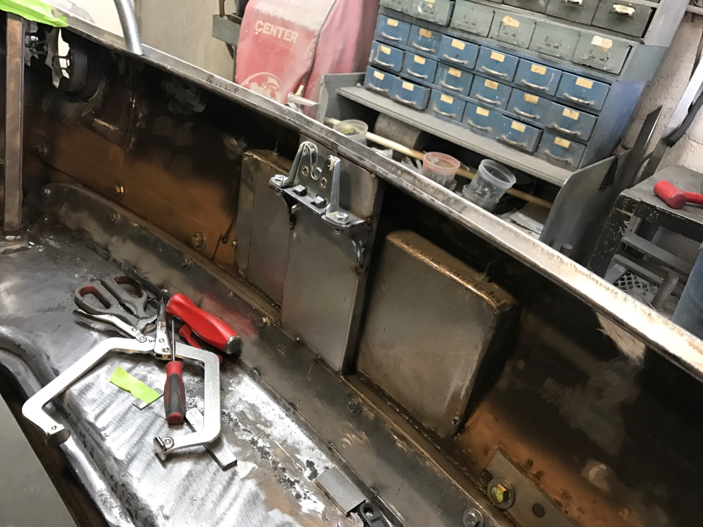

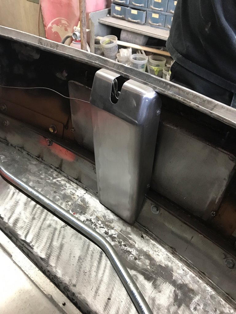

      The shop is still finishing up on the small items. They are about done with the trunk latch and as usual they are exceeding my expectations. They fabricated a nice metal cover that will be screwed to the latch bracket. It will hide the mechanism and will provide a mounting point for interior panels. There is still some finishing touches to do but that is mostly on the trunk lid itself.

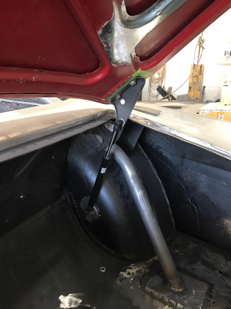

      The minor touches continue. They were able to put a flange around the spoiler mechanism to Jane interior panels. The struts were also minted to the deck lid. Due to the additional weight I will need to increase the pressure on the struts. It should work great when I have the right pressure struts.

      The bumpers are now done and the slight flare to the front edge of the rear fenders is done. I added another item to the to-do list and they have almost finished it. It was to add a turn signal to the outer valance opening. My original plan was to have the turn signals installed around the projector bulbs in the headlight. My concern now is that they would not be visible if the lights were on. The new turn signals function as daytime running lights as well as turn signals. The theme of the grill was continued to the lights. Parallel grill bars on the top and bottom but these will likely be painted black to match the splitter. This one is almost done. It needs a curved piece on the inside edge of the lense like it has on the outside.
