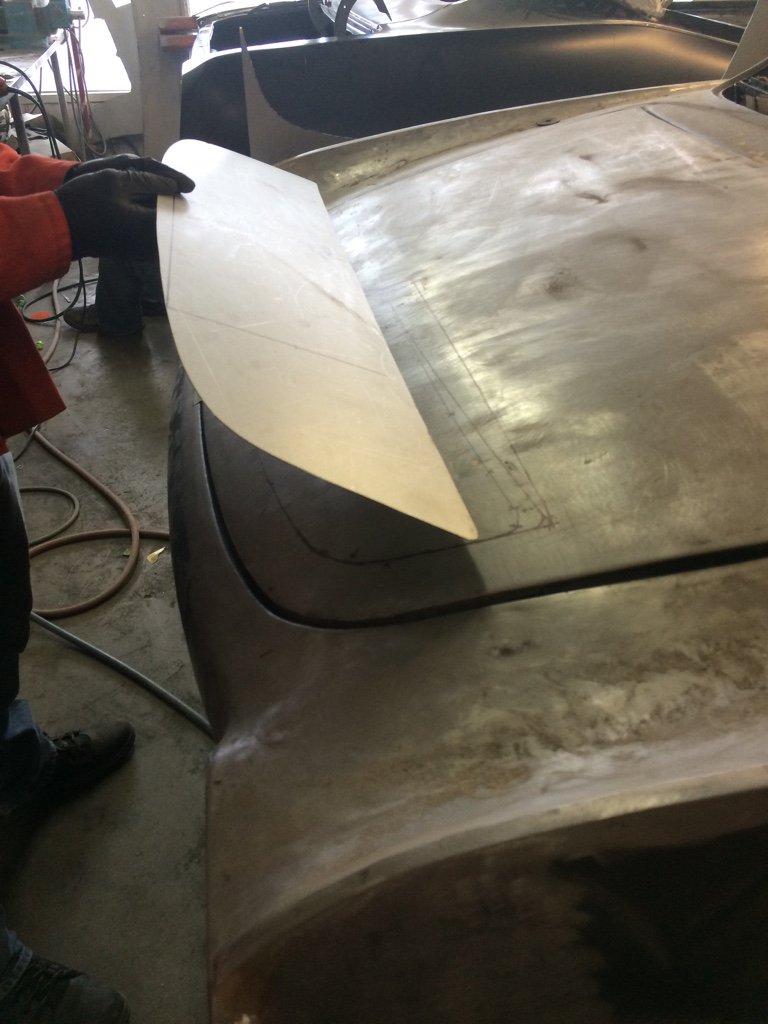

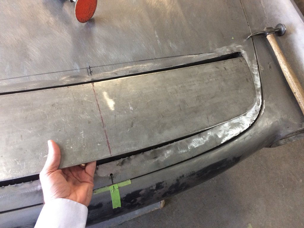

      The rear spoiler work has started. It looks like it is going to work of great. The spoiler has been cut out from flat stock and currently has 1/2" extra all the way around to form a flange to wrap wround the mechanicals.

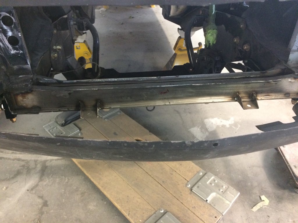

      I had some progress and a setback this week. The setback was some structural damage from years ago the twisted the front end slightly. It appears that the front end sheetmetal is pushed toward the drivers side about 1/2". That will have to be fixed before we can start on the front wheel arched and headlights.
      We were able to get the new swaybar mounted along with some tabs to mount the oil accumulator. The oil cooler will be mounted in front of the Accusump. The grill panel will be repaired and reinstalled after the front end realignment is complete.
      The rear spoiler is coming along nicely. The top of the spoiler is done and they are now working on the substructure. That should be done in a couple days. It should be pretty clean and stealthy when done.

      The spoiler is in. Still need to work on the gaps and inner structure but it is coming along.
      Here is a video of the spoiler being raised. Pretty cool!
