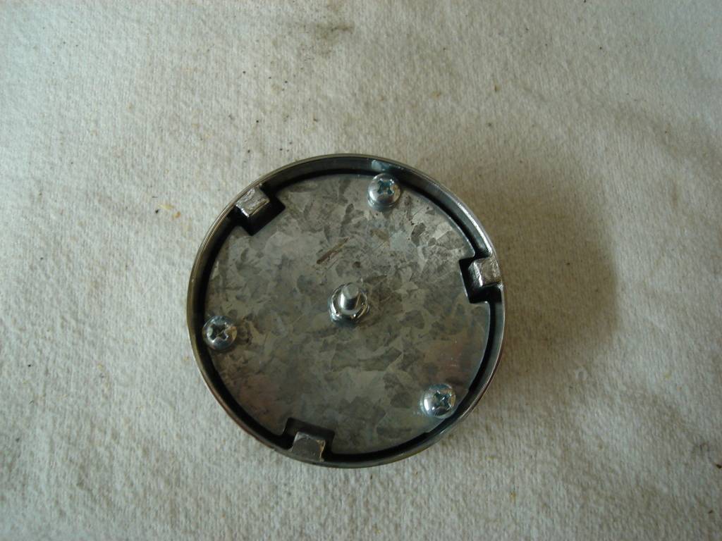

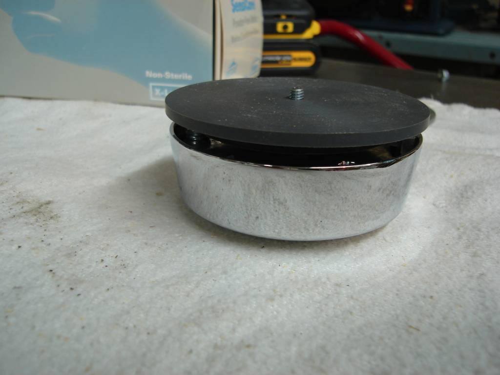

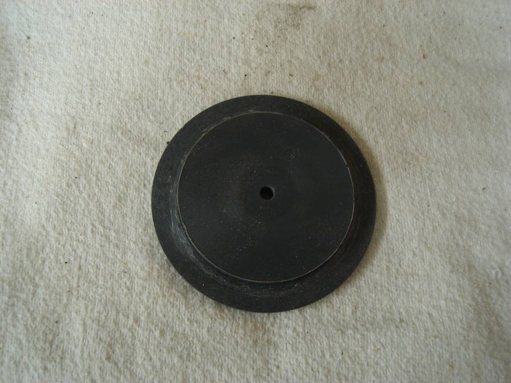

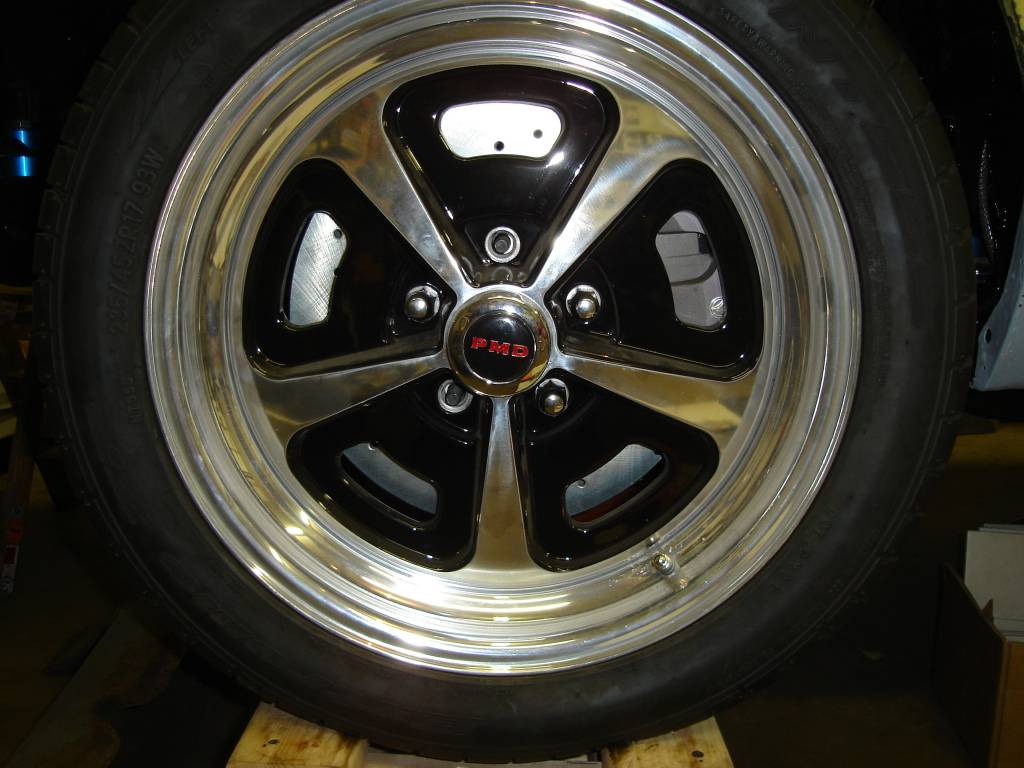

      The PMD center caps add a lot. Here's what I did. American Racing 500 rims.
      Back side of PMD cap.
      Centering hub designed to fit inside of the rim in two spots. This will keep the cap centered.
      I don't have a picture but I also had to flatten out the grease cap a little.
      I also added a little longer stud with a nylon insert lock nut.
      Cap installed.
