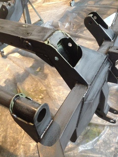

      Hey Gus, yeah a cheap gun is what I have used to get the SPI epoxy primer on and it worked fine, I am no expert painter but for the quality level I am after it looks ok.
      For the SEM Rust Shield frame paint (Gloss with Hardener) I struggled with finding a good spray pattern, it is a thicker paint and they recommend a 1.6 tip and I only had a 1.4 the stuff went on a lot different, very sticky and took a long time to lay flat. Maybe with the right equipment it would have been easier? Wondering if anyone else used this paint and if they had luck with adding reducer?
      Looks ok though, just don't get too close, haha!

      First of all, that is a really nice finish on the frame... glossier than I expected. Well Done!

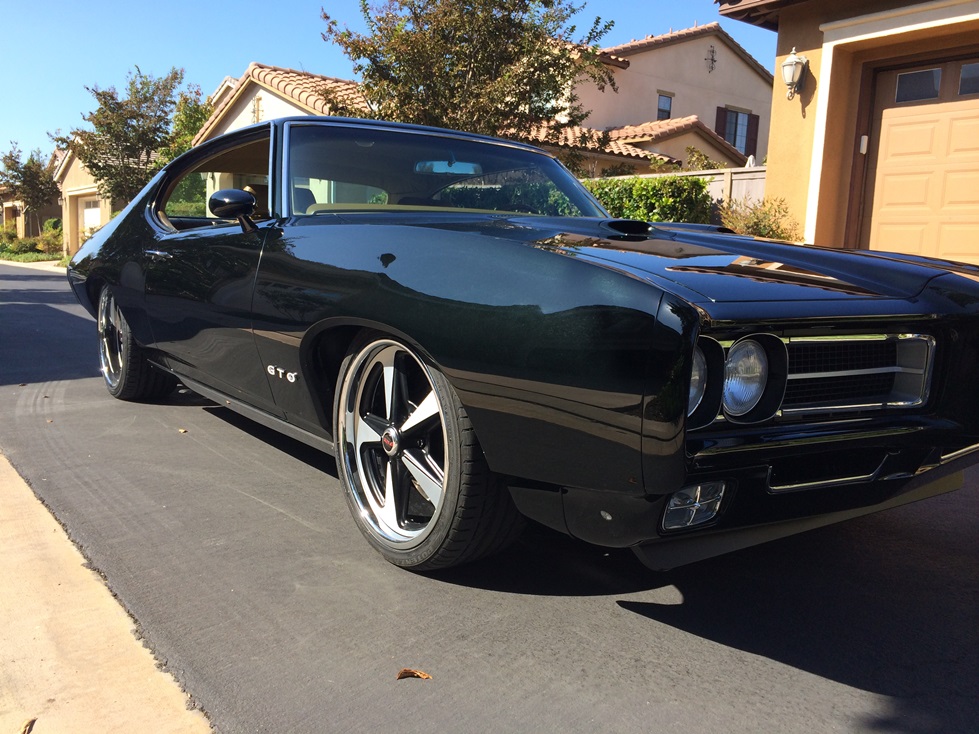

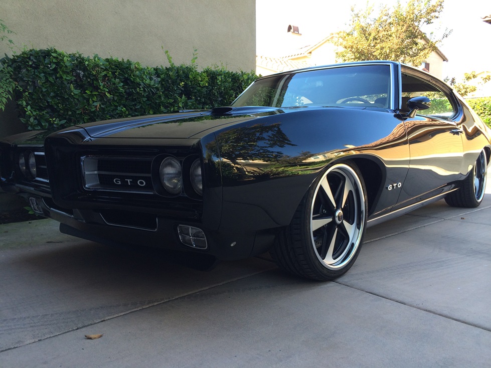

      Great progress, as usual. Sorry for being absent... been kind of crazy with growing the little human, work, etc... but, I was able to perform the first test drive and take project "Green Envy" to the gas station yesterday. I also unveiled it to my Dad for the first time. He teared up, which was the goal... ha, ha.. Below is a brief Youtube link of the start up, and backing out of the driveway. I still have some carb idle issues, alignment, and final polishing to do. But, it was awesome turning heads at the gas station. Which I wish I video'd too.. .because, when we pulled up, there were a few folks admiring a freshly washed yellow C7 Corvette Stingray. I ended that party. Ha, ha...
      http://youtu.be/rWDvi1H3ZSo
      Talk soon, Mike
      Attachment 104522Attachment 104523Attachment 104524
      This car is very sweet my friend ! Congrats on a job well done !

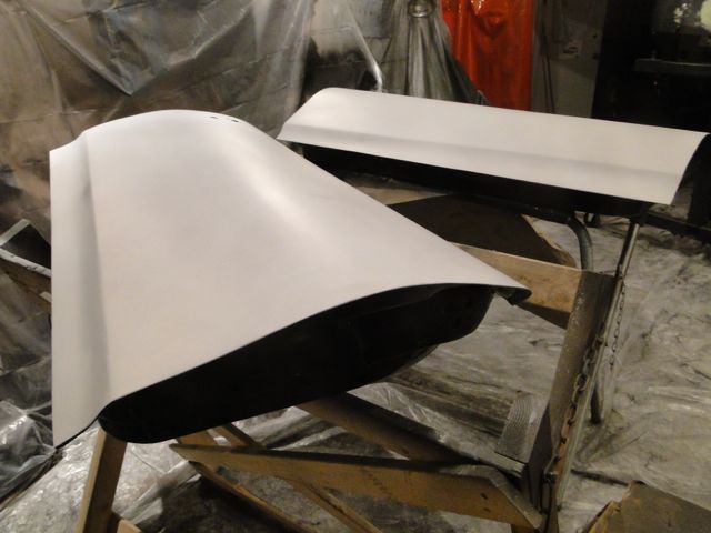

      Hi Roger, I hope to start on the dash in a few weeks after I get the body work sorted out, it should be a fun challenge.
      Starting to spray the SEM high build primer on parts, hope to get the whole body done by the weekend. ?

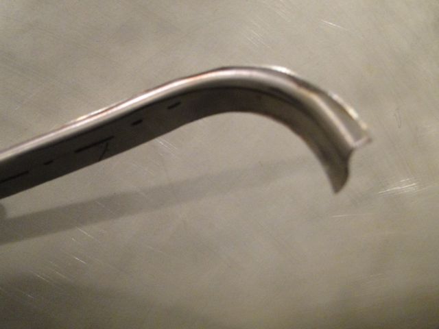

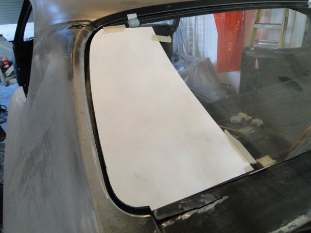

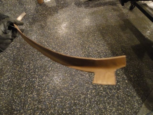

      Borrowed a friends shrinker / stretcher and made up some filler pieces to close up around the sides of the rear window.
Size:  57.1 KBName:  DSC01255.jpg
      Paper template helped get it close.

      Cut-off wheel to trim without changing the shape.

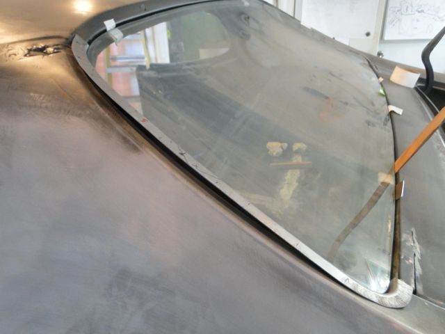

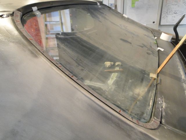

      With the stainless trim around the glass, what will go in the gap between the glass and the metal you just installed?
    18. #318
      Jun 2012
      N. Shore, Ma
      346
      Hey Andrew,
      I will have an 1/8" gap around the glass that I plan on filling mostly with urethane.
      The glass should be flush to the body after I weld in a 1/8" thick X 1/2" wide piece under the window, just like I did for the front.
      Plan on using the 5/16" Butyl tape, with a set of retainer clips top and bottom.

      Interesting. That will certainly alter the look of the car, although I rather like the stainless trim...LOL

      I'm hoping the flush glass is worth all the effort, its not like I can change it back that easy!

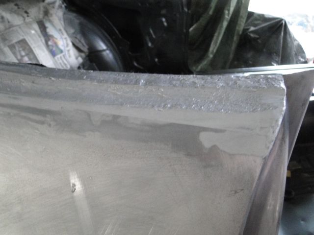

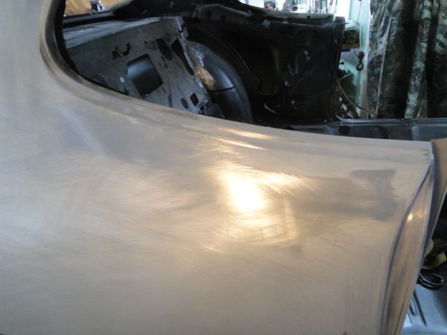

      Still fixing the new 1/4's . Not sure if these stampings were worse than the originals, some funny waves on top by the quarter glass seal.
      Easier to use the Metal to Metal filler than lead.
