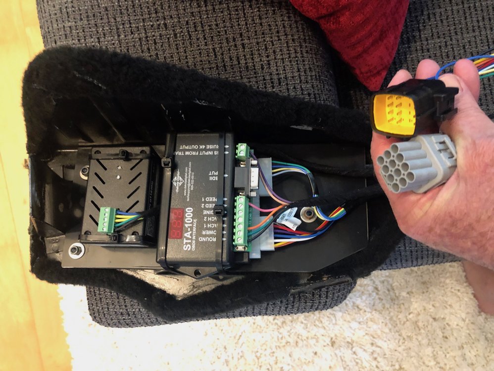

      One of the new wiring harness's fabricated by Carl & Stan along with cleaning up the 14 pin connector. Circular connectors installed on InfinityBox junction (inside to outside) and the 14-pin connector side is done and will connect to stock 928 harness that remains for the central warning computer etc. Spare orange and yellow wires are outputs from the I-Box inMotion kit that are not being used and will be sealed. T

      Thanks Dave^^the wiring wizardry is being handled by my bud Carl. Sourced a later model digi-dash cluster and an early 89 combo switch (no airbag) to control it all, then filled with LED's. Need to black out the Auto selects being this car is a 6 sp manual. A Protizomo LED dimmer was fitted behind the dead pedal along with a Dakota Dig cruise control interface. A 3D custom subpanel will be concealed on top of the tunnel in the center console for easy access from the footwell side panels. Thats it for now. T
