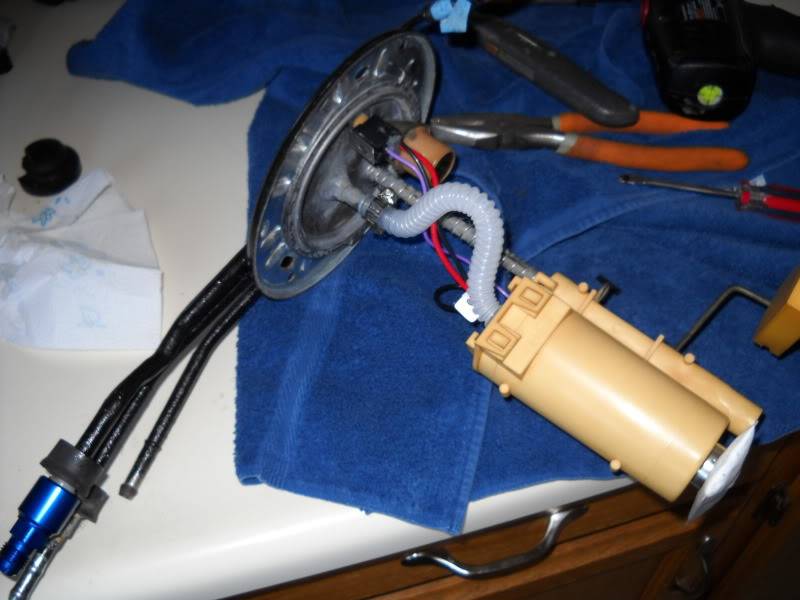

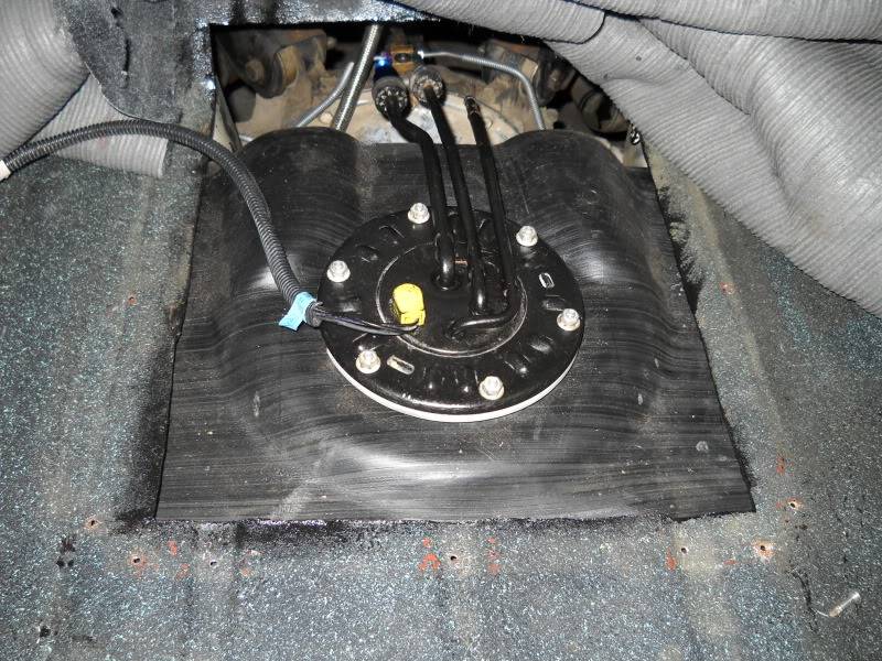

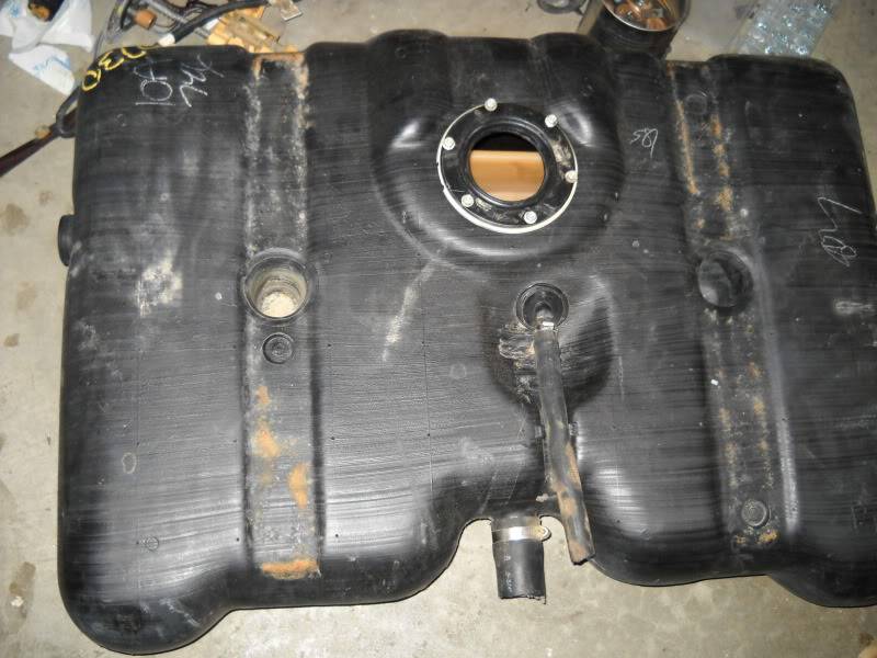

      95 Impala/Caprice tank fits the 68-72 A bodies, it's sumped and baffled. The fuel sender works on your existing gauge. All that's needed is the upgraded fuel pump and 02 corvette filter regulator. I've run it on under 2 gallons of gas. Used tank/sender $80
      (came with 5 gallons of gas I used in my lawn mower), Racetronix pump (includes improved wire harness) $125, corvette regulator $35.
      Do not go external on the A body tank. It's low and wide and will have starvation problems on less than 1/2 tank. Some efi aftermarket tanks have the same problem.
      Tank
      Pump
      Installed

      I had thought about those tanks too, I think I did the measurements and it was too deep for a second gen F-body, but I had seen people use them for A-bodies. That is a clean install. Do you have any measurements on the tank itself? What about the gas filler? It was in different places on these tanks depending on if it was a Caprice wagon or sedan right? One came out like yours does, the other would go to a filler on the quarter panel.
      Stephen
      Dec 2010
      St Louis
      453
      Yes, you need the one for the sedan. I cut off the original 442 filler neck and connected with a short piece of fuel hos. Filler is behind the license plate.
      No dimensions taken. I did trim about 1/4" x 4" of the back of the frame rails to fit it in easier, although others didn't have to. Sorry you f body guys dont have a cheap solution like this.

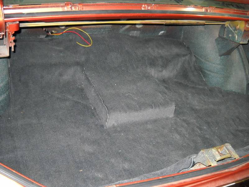

      The original tank had a depressed section for the outlet. The caprice tank is raised. I cut out a section of my trunk, also makes changing the pump easier. Bot you can buy some rubber coil ring spacers from Autozone that will space down the front edge so you dont have to cut the trunk.
      My trunk pics below.
