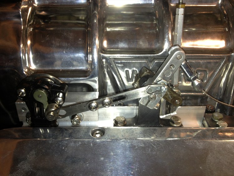

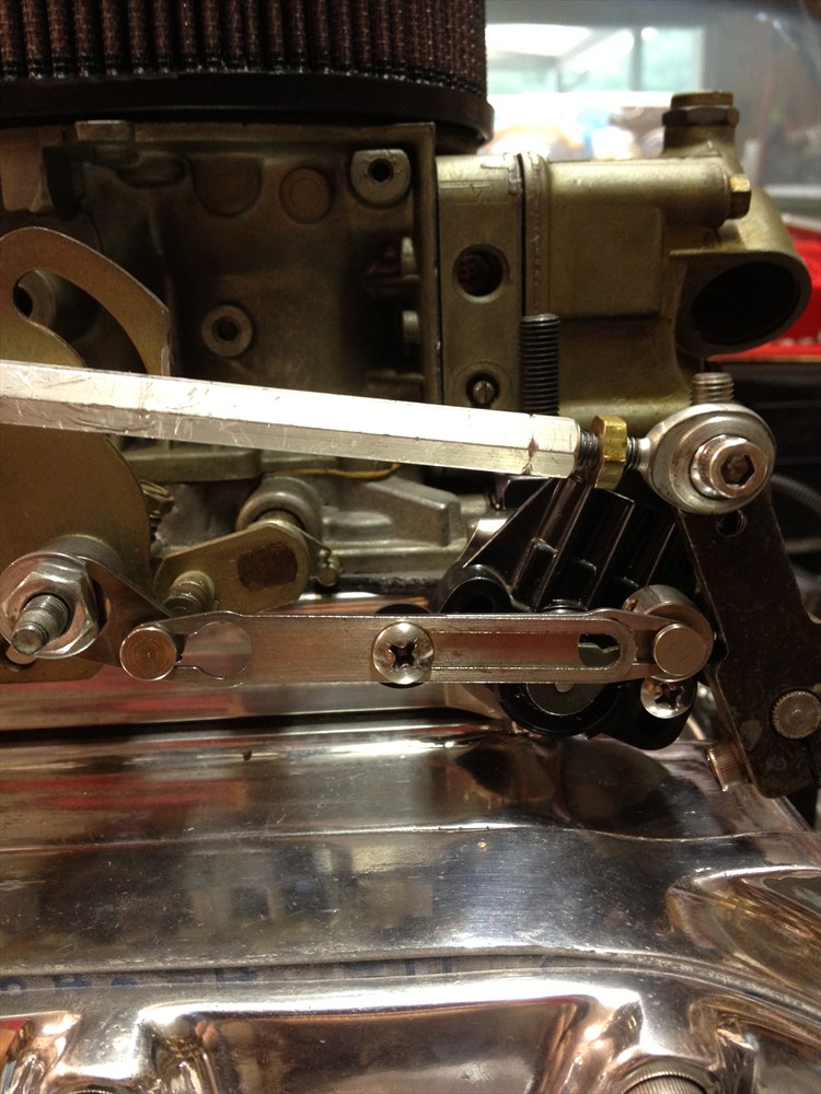

      Finally got everything to work together. I really wanted it below the hood line but I just could not get the proper ratio. Looks like I'll be putting the weather tight connectors to the test.

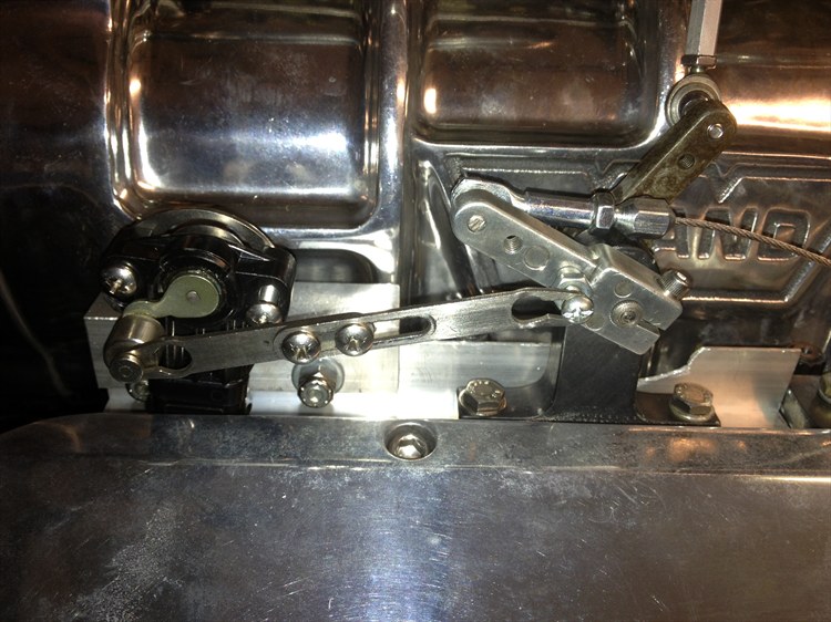

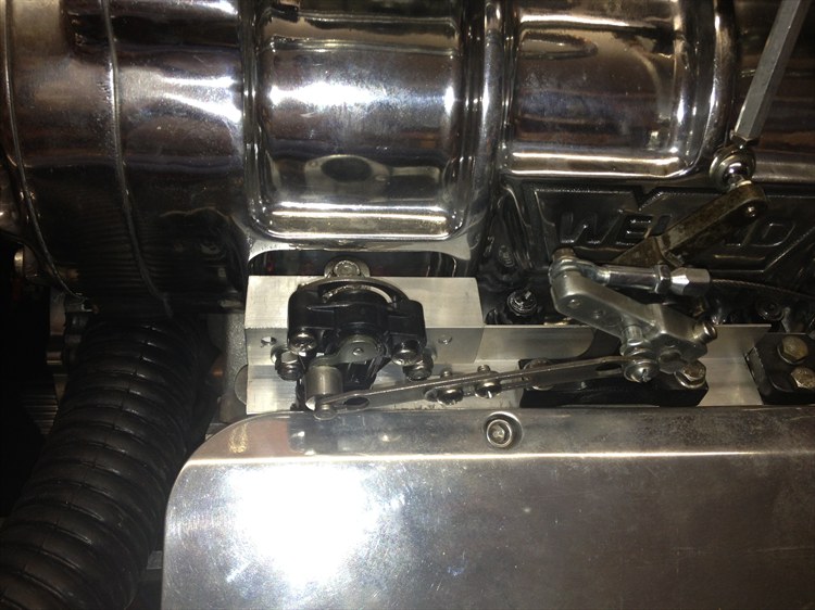

      Finally got it to work below the hood. A bit Rube Goldberg-ish but functional and the wiring is hidden.

      Is there any way to use one of the holes that is further from the hinge point? If not, then I suggest softening up the tables in the 50-70% range. As is, you have a rather steep motion ratio. The software CAN compensate, but I like to see a more gradual motion-- especially with that big honkin' blower. Sounds great!

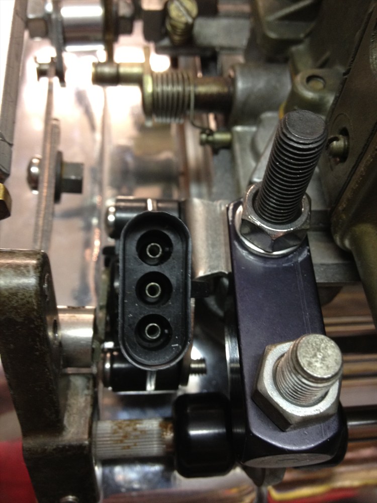

      I tried the outer holes but the TPS was "bottoming out" and preventing me from getting more than about half throttle. I had to drill and tap a hole much closer to the axis just to match the limited arc of the TPS. The throttle is pretty stout with 6 springs holding it back. Seven if you count the TPS.
