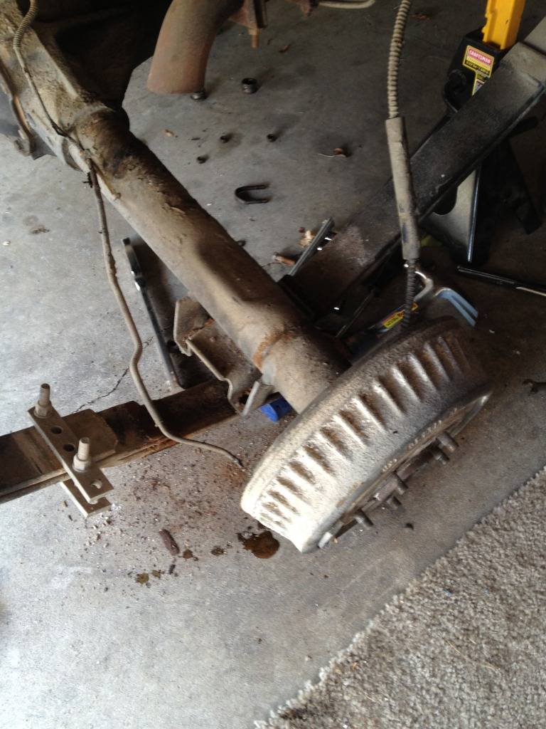

      I purchased this car in April of 1999 while I was still in high school. Originally it was thought to be a fairly solid car. However after siezing an outer wheel bearing on the drive home after purchase, it became apparent that it still needed some TLC.
      Overall the car wasn't too terribly bad. To get the project rolling and hopefully on the road while I was still in high school, my father and I opted to do a partial restoration on it. We removed the front clip, cleaned it and shot it in black. We also rebuilt the steering companents and added disk brakes up front.
      From there we focused our attention on the areas of the car that had notable corrosion. New rear fender linings, partial 1/4's and a patch for the drivers front fender. The patch didn't turn out all that great, so when the car went for paint, I had them rebuild the driver's fender. While in paint prison, we found more areas that needed attention. They ended up replacing the seal plate under the rear glass, the upper windshield moulding as well as both rockers. Everything else was good to go. After paint the car came back to me (2007 at this time). I put some work in to it getting it back together. As my career started moving I no longer had time to really work on it, so it went in to storage. Now I've got it back and I'm hoping I can get it road worthy as quickly as possible. My C6 I've put in storage in it's place, which I'[m hopeful will push me to get the bird done.

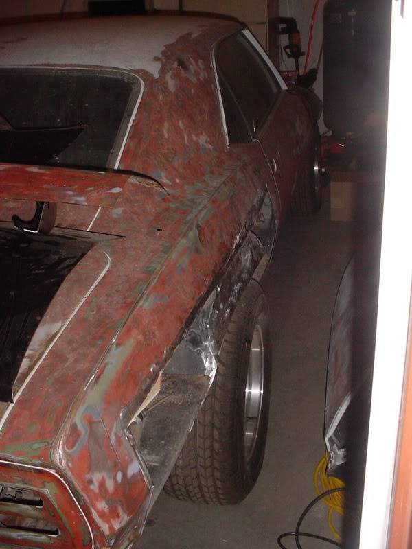

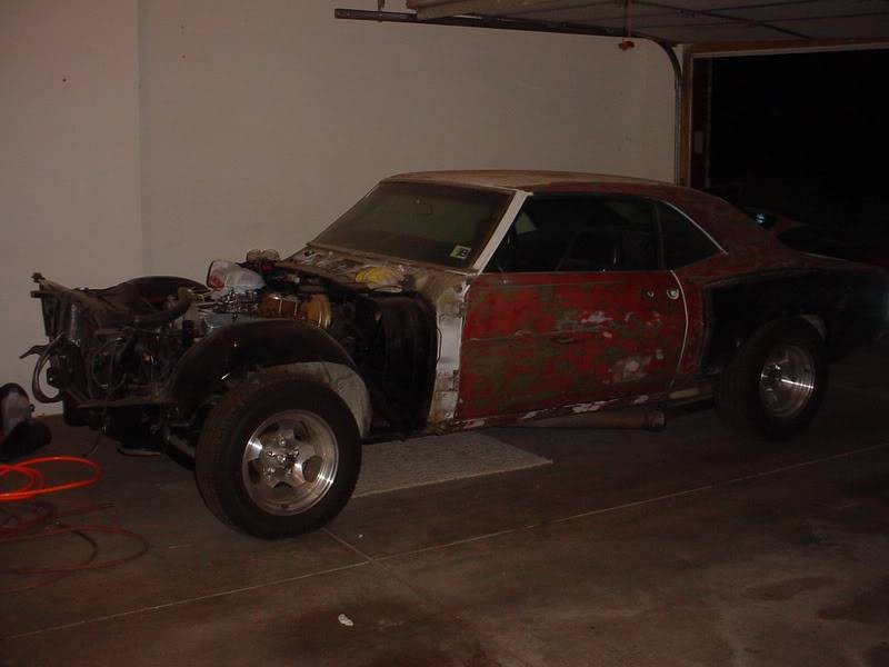

      I'll try to keep this thread updated as I go. Here's a few pictures of where it started and where it's at now.

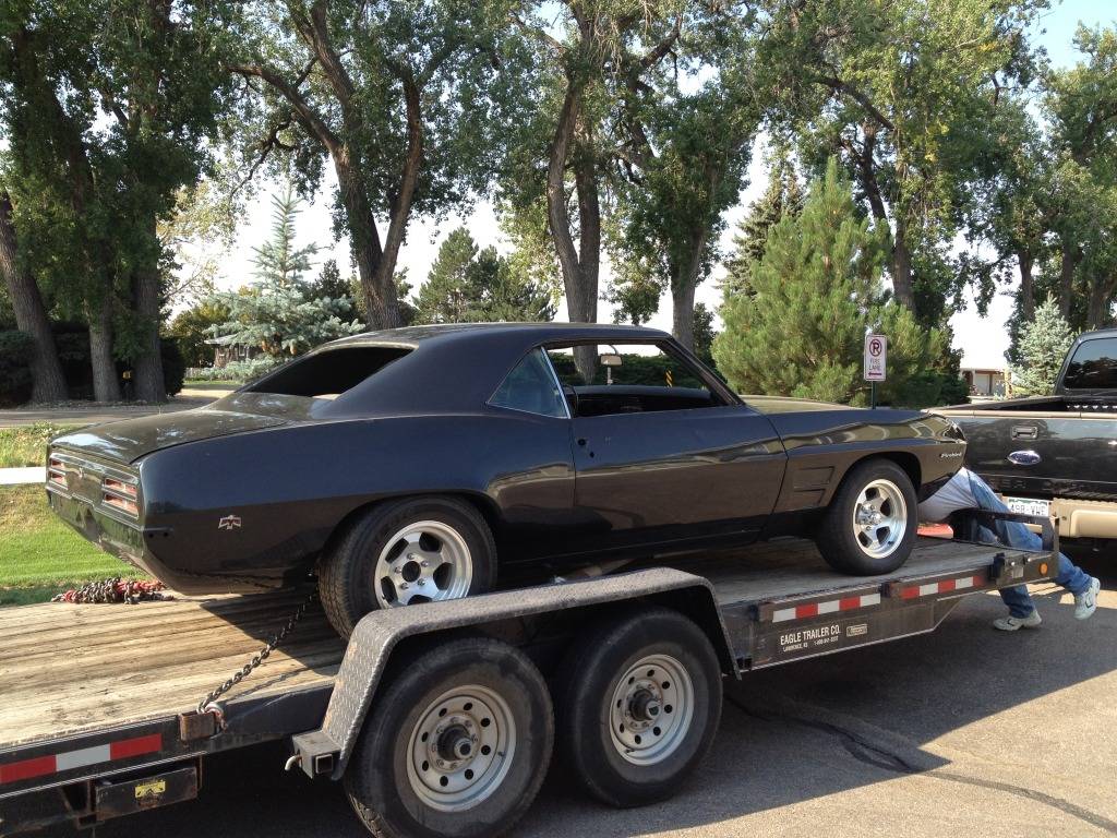

      The day I got it home, but after the wheel cylinder had been replaced.
      With the front clip back together. Starting the rest of the body work.
      Passenger side 1/4 replacement
      Prior to being sent off for paint. You can kind of see the patch that I did which didn't turn out so well.
      Finished with paint.

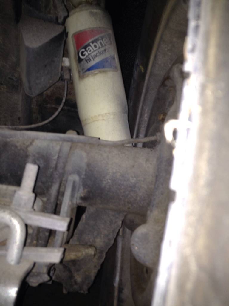

      In order to mount the shocks, the lower shock mounts were modified to accept the shorter air shocks upward in the wheel well. Whoever did this modification literally just used some steel bar stock and looks to have "eyeballed" it. You can see in the image below what I'm talking about.
      Sensing that wasn't the extent, I checked the upper mounts as well. Sure enough, they had been swapped out for mounts that accept a "T" style mount for the shocks. That means of course I had to order parts, which of course were on back-order. I did finally receive the new plates this week.
      Now all I need are the Hotchkis Bilstien shocks and I'll be able to get this bad boy in the car.

      Both driver and passenger side leafs had cracked and split under the leaf spring pads. As soon as pressure was released, they both completely snapped. I had debated not putting the new rear-end in the car and just driving it with the stock pieces for a bit. Boy am I glad I opted to replace it. Any real stress on those leafs and I would have found myself in an awful way.

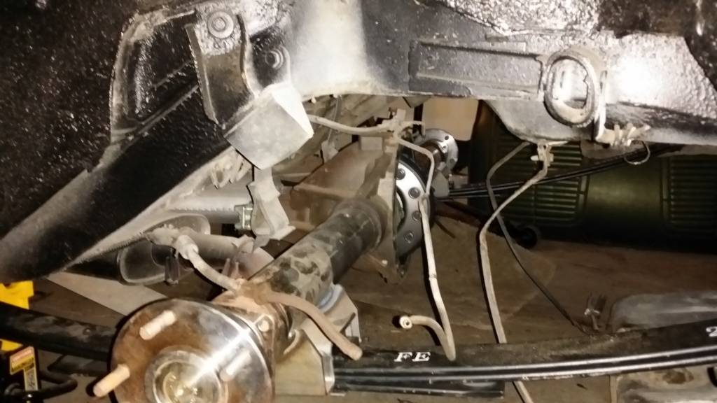

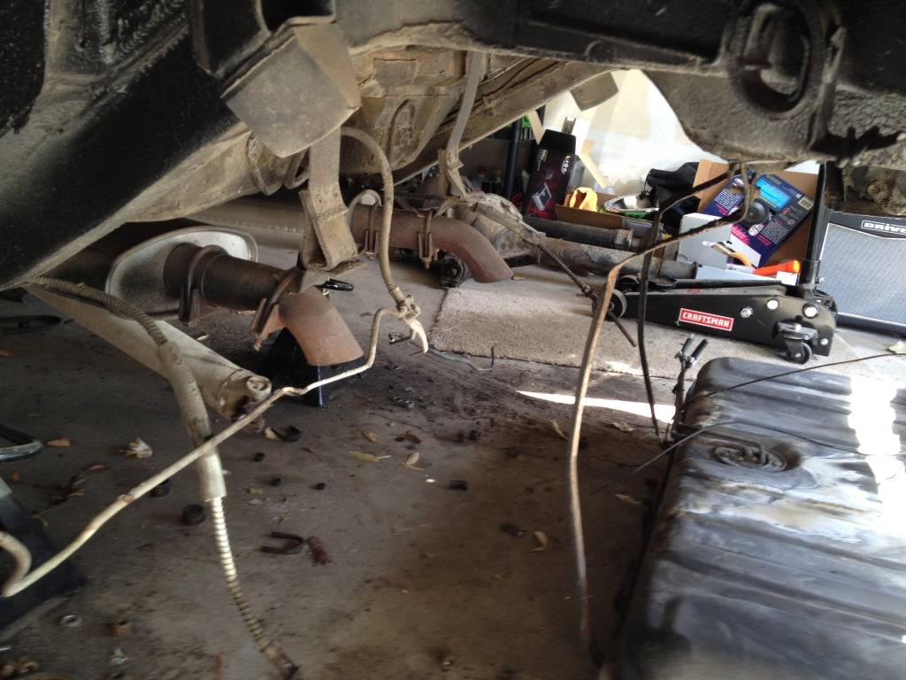

      So next up was the install of new rear suspension pieces as well as the Moser 12 bolt.
      I was rushed for time here so the rear end went in uncoated. A short term plan is to do the ridetech four link, so I'll coat it at that time when it comes back out.

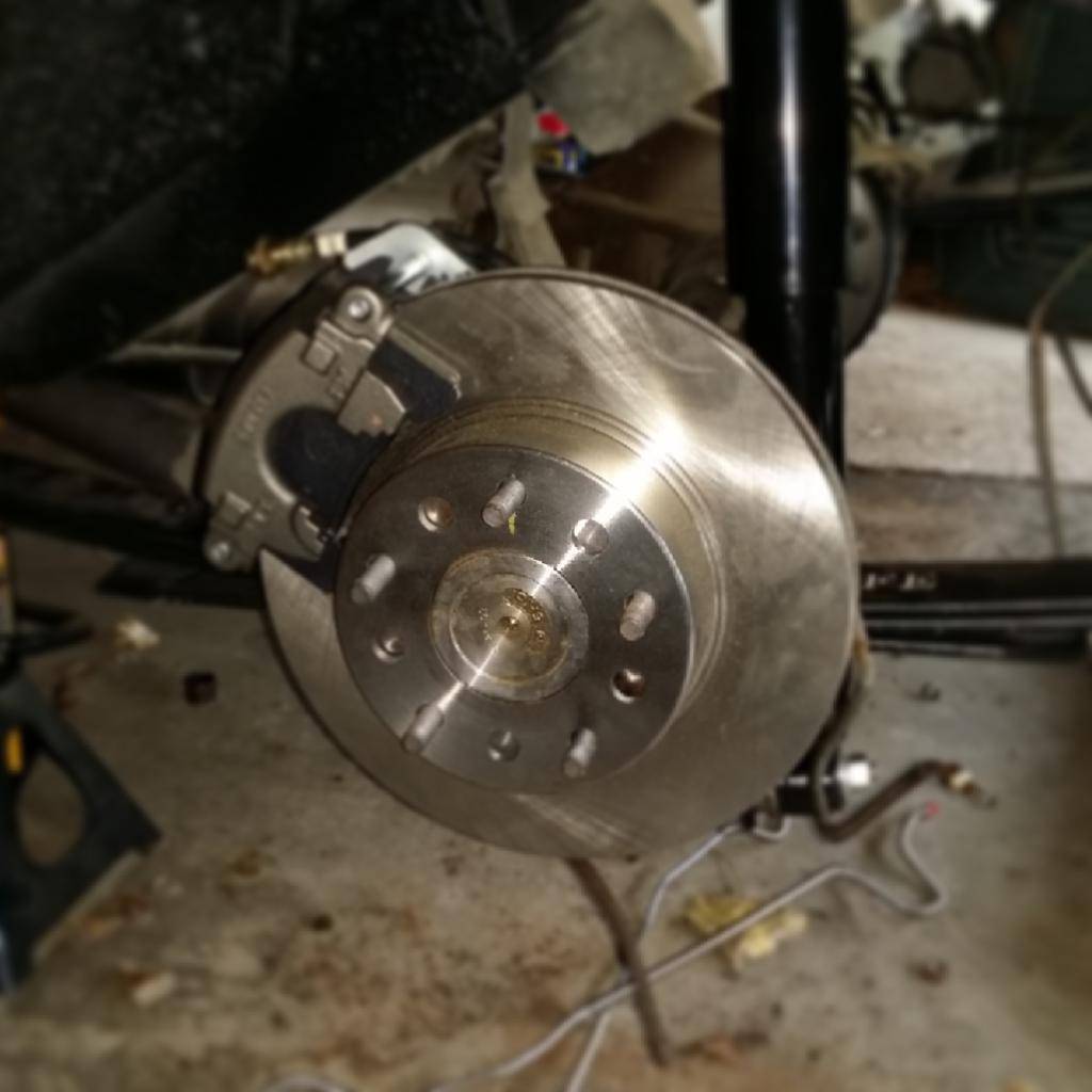

      I also installed rear discs at the same time along with new hard lines in the rear. Nothing fancy here, but functional.

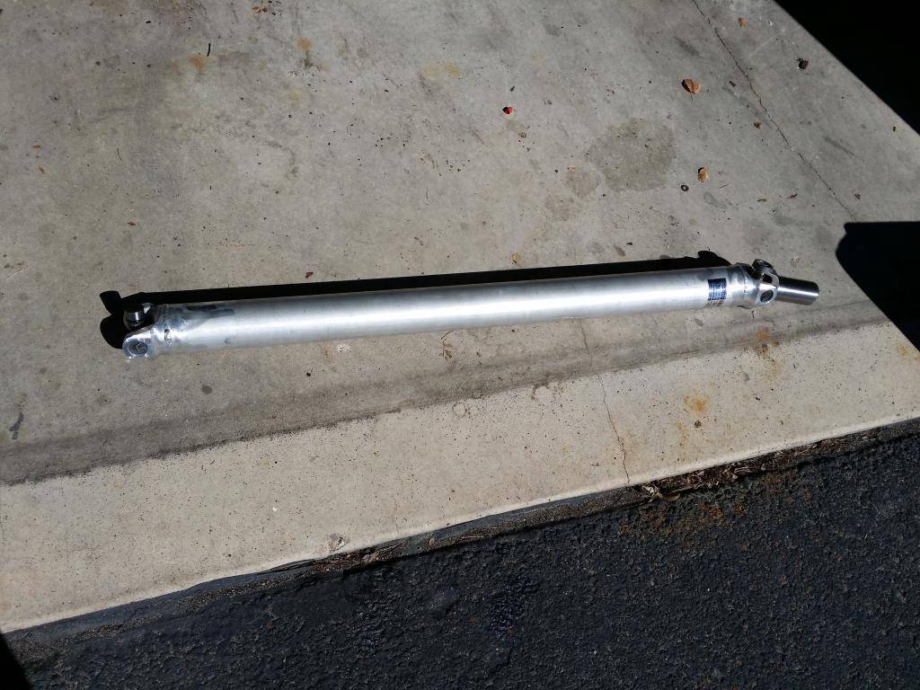

      The added size of the 12 bolt over the BOP 10 bolt also necessitated a change to the driveshaft. Originally I was just going to shorten the stock unit and put new yokes on it, but it was a bit beyond repair so I had a custom aluminum shaft built.

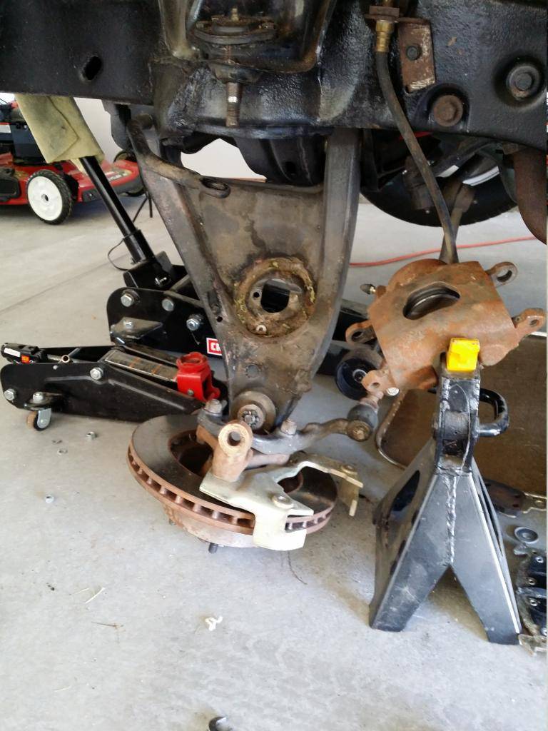

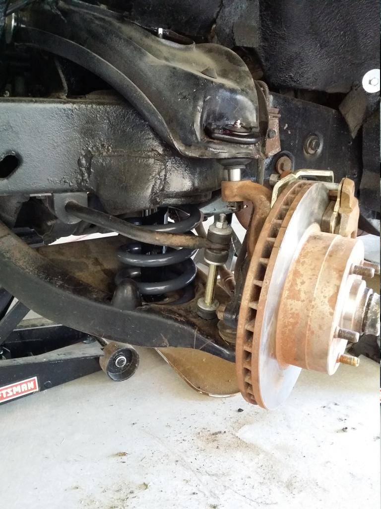

      To compliment the Hotchkis 3" drop leafs I installed a set of Hotchkis 2" drop springs up front and went with a half in tall UBJ on the factory control arms.
      Obviously this is still a very stock setup. It'll look better than it'll turn, but I'm kind of excited about that. My plan this summer is to get the car out for as many HPDE's as I can fit in and start tuning on it. I'd like to see how quick I can get the car as a fairly stock setup before I start putting more parts on it. Obviously I mentioned earlier that one goal is the ridetech 4 link out back. I'm clearly looking at the ridetech setup up front as well, but depending on what direction I end up going there will determine what I ultimately do with the rear. I'm hoping to be able to catalog the car's progress in lap times as I'm able to dial in and upgrade it's suspension.
      Along with the minor suspension upgrades I needed to do a bit with the brakes. The car was originally a four wheel drum car that I cobbled together a couple different upgrades for. One thing that it needed was a proper disc/disc combination valve, so I got that installed recently as well.
      Unfortunately I'm still fighting bleed issues with the master. I've bench bled it several times as well as gravity bled it and I've still got air in there. More than likely I'll take it to a brake shop that can pressure bleed the system and get me going.

      Where did you go to get your driveshaft made?
      -Bennyhaha
      Dec 2011
      105
      I had it made at a local drivetrain shop. Northern Colorado Driveline Services.
      http://www.ncdls.com/
      Turnaround time was just one business day. Local to me of course.

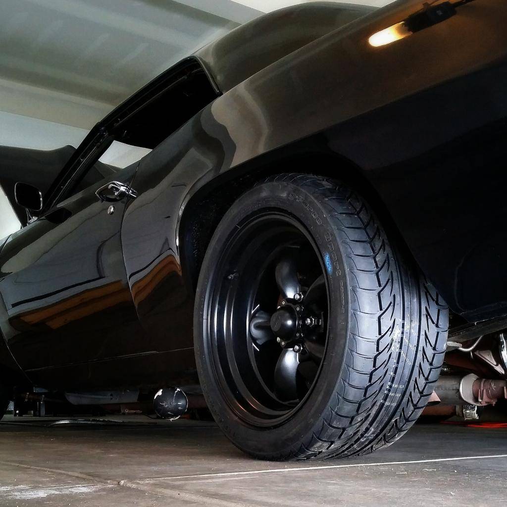

      It's been a couple cold months mixed in with the holidays, so I haven't had much time to do anything with the car. I do have a quick update now however.
      I ordered wheels and tires about a month ago and they showed up yesterday. I mounted a rear wheel to check fitment and all is good. In fact, I could have gone wider. These are a 17x9.5 with a 275/40/17 BFG Sport Comp 2. I've got a solid inch and a half inboard that I'm not using. I may check fitment of these up front and order a 10" wheel with a 285 tire for the rear.
      Glass service is coming out on Friday and will be installing front and rear glass. I've got to replace a single stud on the driver front rotor and then I'll be able to take it for a quick shakedown to make sure I don't have any rub issues.
      Getting ever closer!

      Nice teaser shot !
      What's in the front ?
      17x8 BS4.75 with a 235/45 ?
      I like the black wheels

      Very close. 17x8 with a 245/45 and a 4.75bs
      Every car is different of course, but I could have easily stuffed a 17x10 with a 285 tire in the rear with a 6.25" bs.
      I'll get quality pictures this weekend after glass is in and the rest of the wheels are on.
