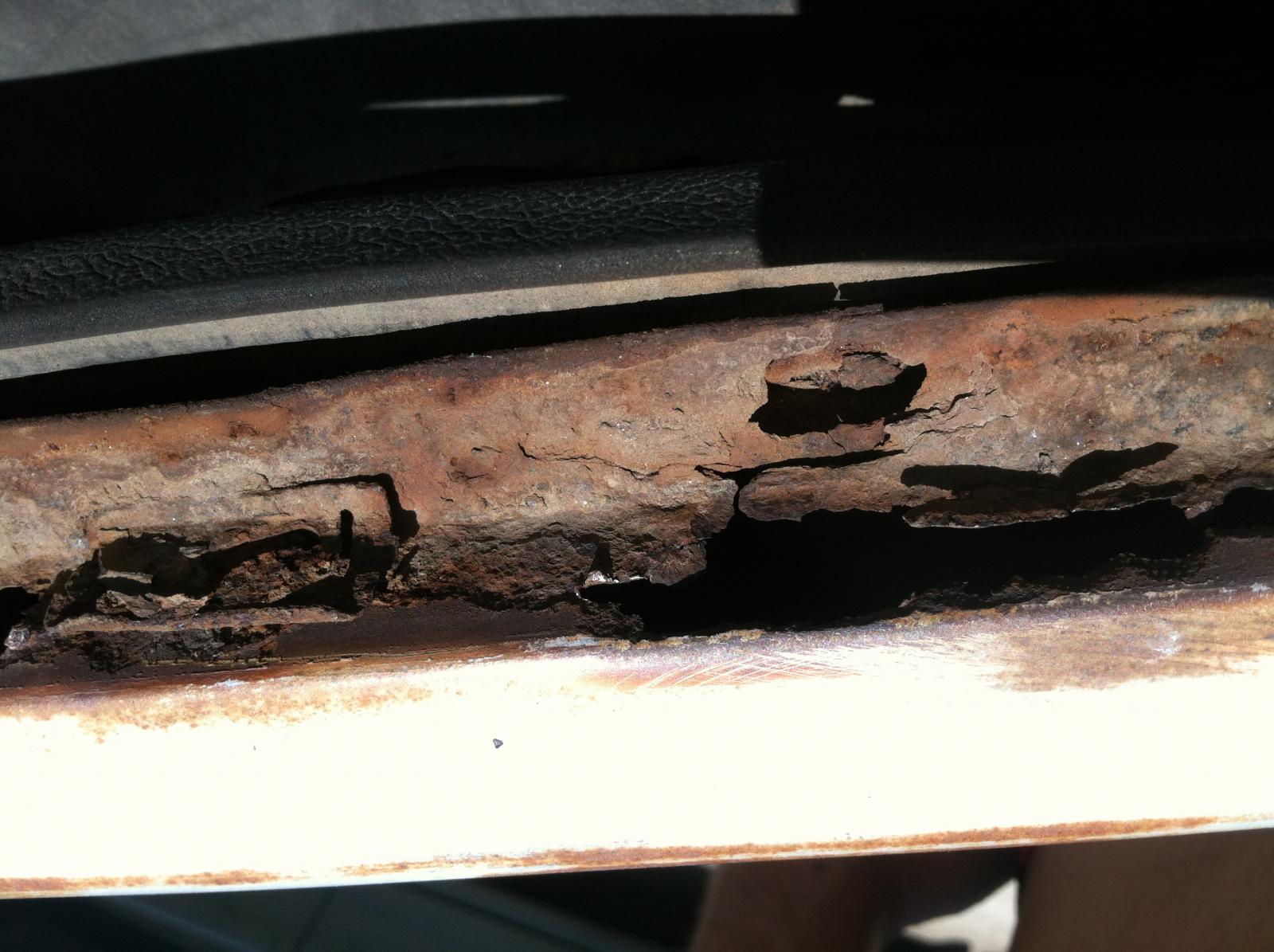

      WOW
      I went to Harbor Freight and bought the 4 tool trim kit and the seal cutter.
      It was relatively easy undoing the trim on the driver's side since it wasn't rusted. The passenger's side, though, I got frustrated and accidentally ended up putting a slight bend in the trim.
      The seal was cracked and flaking and sticking out at the bottom of the window, so I pulled a little piece out and stabbed the cutting tool in. I barely put any force into it and instead of cutting through the seal, it lifted the window! Literally 75% of the window wasn't even sealed! The only part of the window that was still sealed was the top, the rest of the window I could lift with barely any effort at all. It took longer to get the trim off than it did to get the window out.
      I'll try to upload some pics soon, but I think it's way out of my league. I mean I've seen worse, so I'm sure it's fixable, but it's definitely not going to be as easy as I thought.

      First time attaching pics this way, so hopefully they're not ginormous lol.
      Anyway, ideas on how I'd go about fixing this??
      Pics didn't look that zoomed in when I took them...and they were right side up as well...still, you get the idea lol.

      California
      1,368
      Bumpity.
      Anybody know what gauge the metal is? I was just gonna cut out a piece of metal, bend it to shape and just go to town. Since there's a stud for the trim in the rusted area, I was just going to get a nail that was roughly the same size and weld that in the replacement metal.
      Not sure how I'm going to do the lip that the window actually sits on, though.
      Thoughts?
