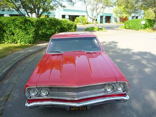

      All done after 7 years, frame off resto...
      What do you all think?

      VERY nice job Brian!!
      Welcome to the site.

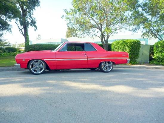

      nice car, few mods and keeping the exterior and interior simple is a great fomulat. bench seat gives it that sleeper attitude also. good job

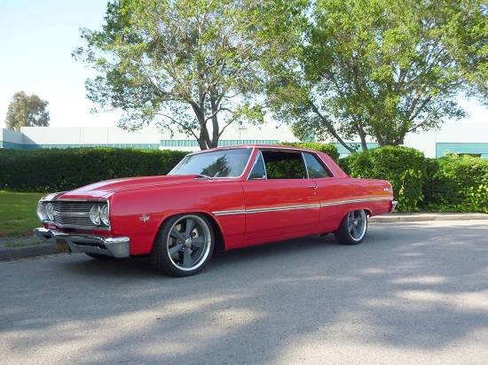

      wow! great work.... really like the wheels and over all vintage feel!

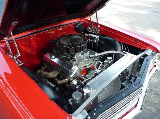

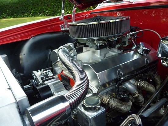

      Thanks for all of the comps.
      Here is the list of parts:
      Engine:
      383 small block chevy
      4 bolt main
      Crank, rods, and pistons are all forged Eagle Performance parts. The rods are h-beams. The pistons are 8:1 C.R.
      Victor Jr. Manifold
      Edelbrock Performer RPM heads
      Edelbrock roller cam
      Comp Cams roller rockers 1.6 Intake and 1.5 Exhaust
      750 CFM Demon carb
      407 HP
      409 Torque
      Computronix distributor
      Exhaust:
      Hedman headers
      Flowmaster mufflers w/ 3" exhaust
      QTP electric cutouts
      Wheels:
      Rocket Racing Booster wheels 18x8's all around 4/3/4 B.S.
      BFG KDW II tires
      Brakes:
      CPP Master cylinder
      HydraTech brake assist system
      Kore3 disc brakes
      C6 calipers in the front
      C5 calipers in the rear
      13" rotors in the front
      12" rotors in the rear
      Russel braided brake lines on the whole car.
      Suspension:
      CPP upper and lower A-arms
      Edelbrock adjustable upper trailing arms
      Edelbrock lower trailing arms
      VariShock coil overs
      Varishock shock abosrbers - rear
      Hotchkis rear sway bar
      air ride front sway bar
      Steering:
      ATS AFX spindles
      ATS steering arms
      AGR steering box
      Ididit tilt steering column
      Jones racing type II steering pump
      Rear end:
      Moser 12 bolt
      35 spline axles
      Wav Trac posi
      3.08 gears
      Cooling:
      Aluminum Radiator from AutoRad
      Aluminum sore support from AutoRad
      Electric water pump
      Fuel:
      Edelbrock electric fuel pump
      battery:
      optima red top
      Drive Train:
      Art Carr 200 4R
      Electrical:
      American Autowire kit
      LED tail lights
      140 Amp alternator
      1500 Watt stereo system
