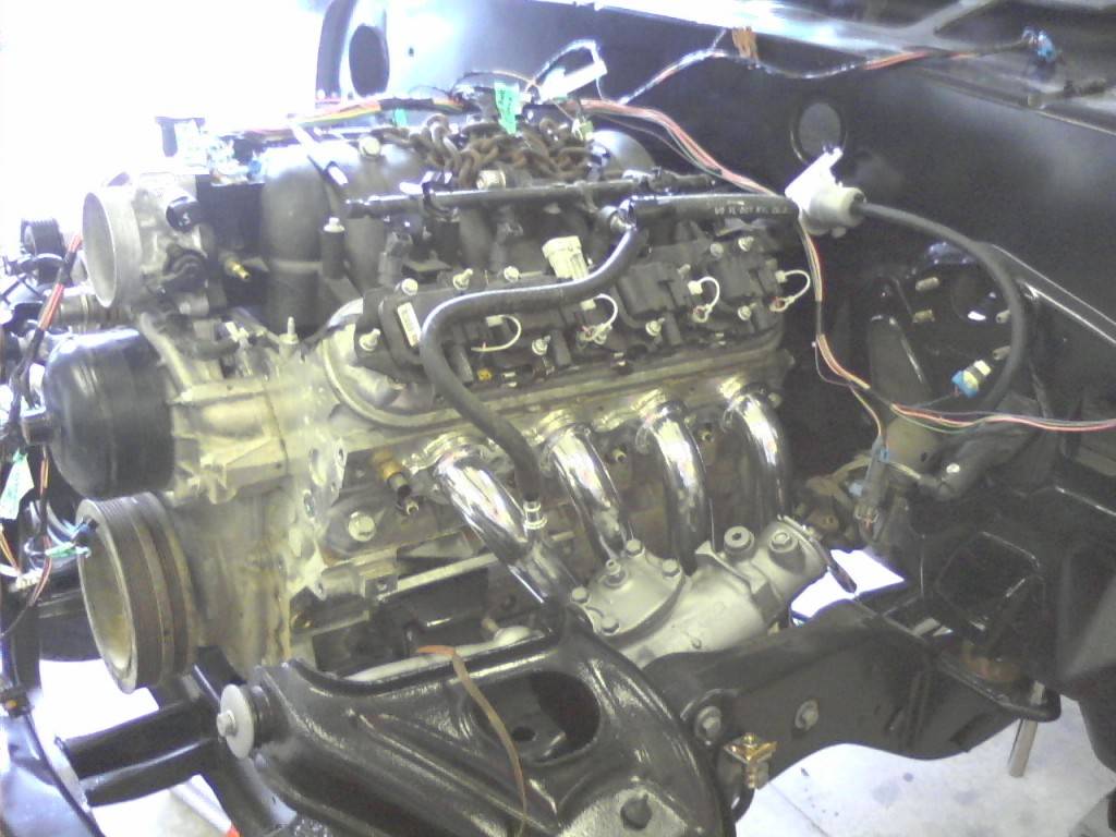

      Pics of the dynatechs from the bottom. The pass side is slightly lower than driver side. I have dirty dingo DD engine plates, small block short/wide frame stands, and stock rubber motor mounts. I am also using stock height aluminum body bushings.

      Looks good. Dynatechs next time for me, I think. The only problem there is that I much prefer a raw ss header over a coated steel version.
      Frank at Prodigy tells me that ATS mounts work well with the Stainless Works headers.
      ​John Parsons
