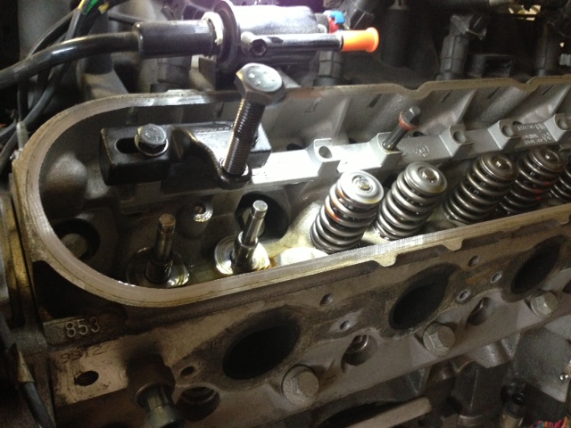

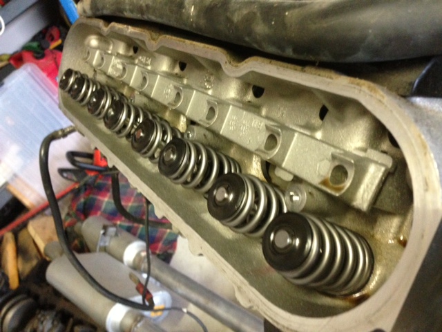

      Cam swap
      So i decided the little ls1 needed a cam swap... Got a comp cam kit (cam, pushrods, trunion rocker upgrade, springs, retainers, keepers and spring cups) Now im trying to track down a decently priced used LS6 intake with a ported/polished throttle body to slap on top.
Size:  156.9 KBName:  2.JPG
Size:  130.3 KBName:  3.JPG
Size:  130.4 KBName:  4.JPG
Size:  143.8 KBName:  5.JPG

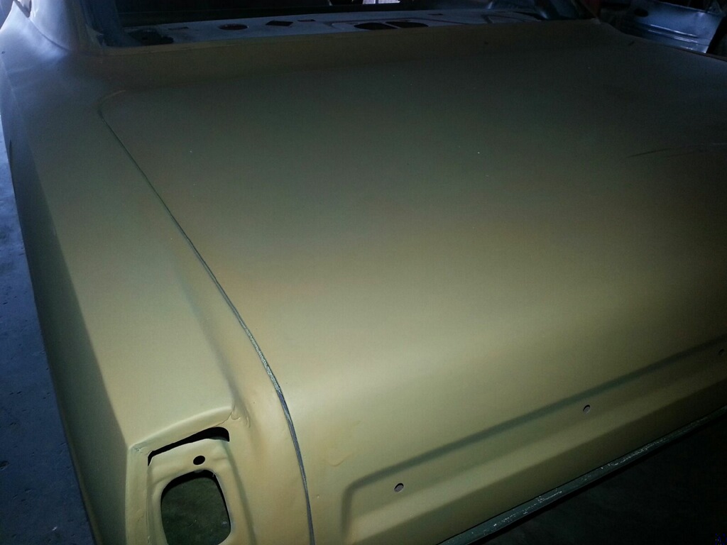

      Pictures
      A couple of pics with the car stripped back down
      Etching primer down

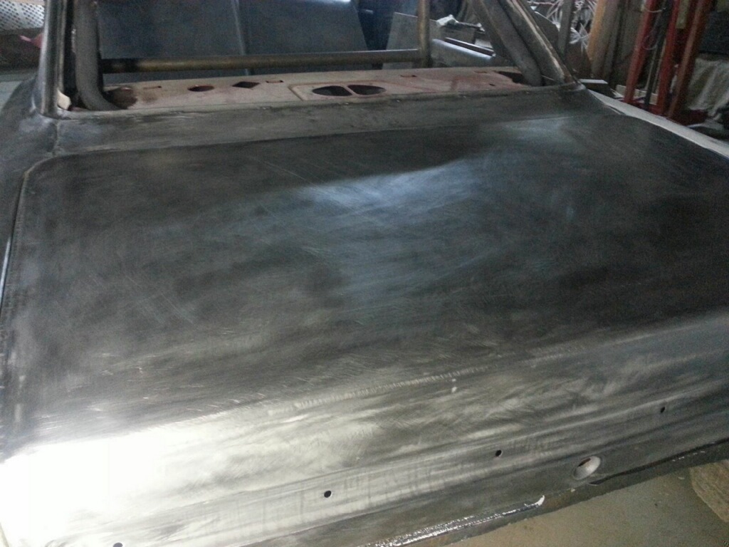

      Getting the body work knocked out

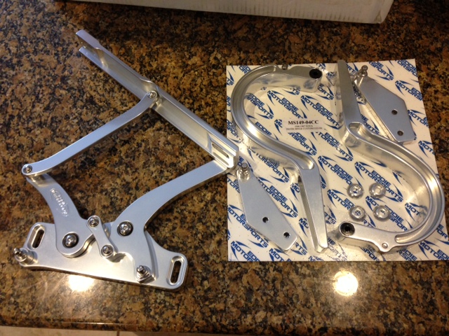

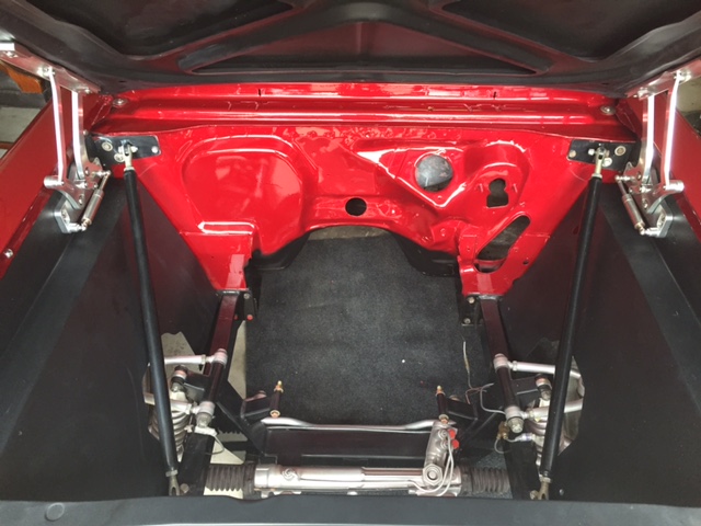

      I decided to kind of splurge a bit on some billet hood and trunk hinges.

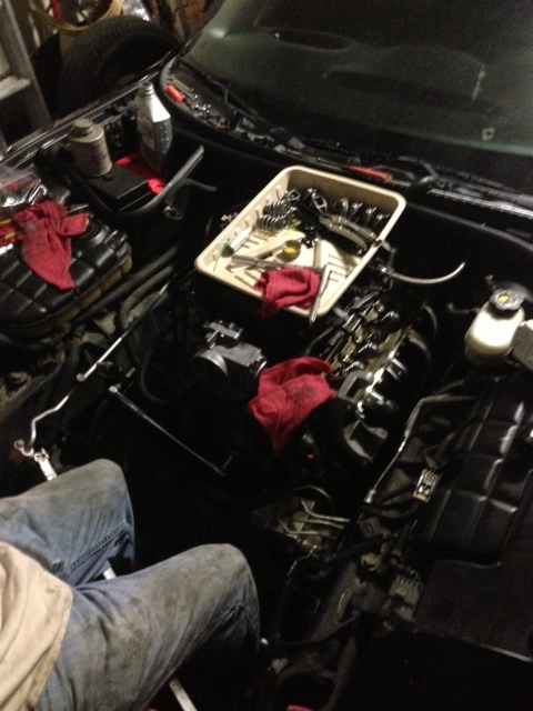

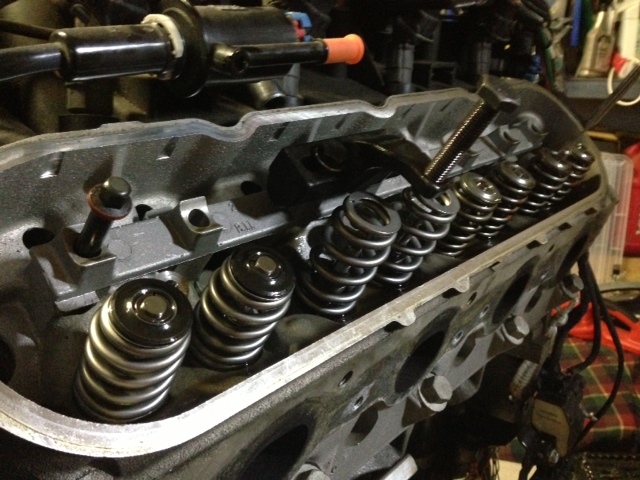

      And like i said from my last post i started tearing into my corvette. For any of you that have done heads and/or cam swap on a corvette you know how truly fun this job is...

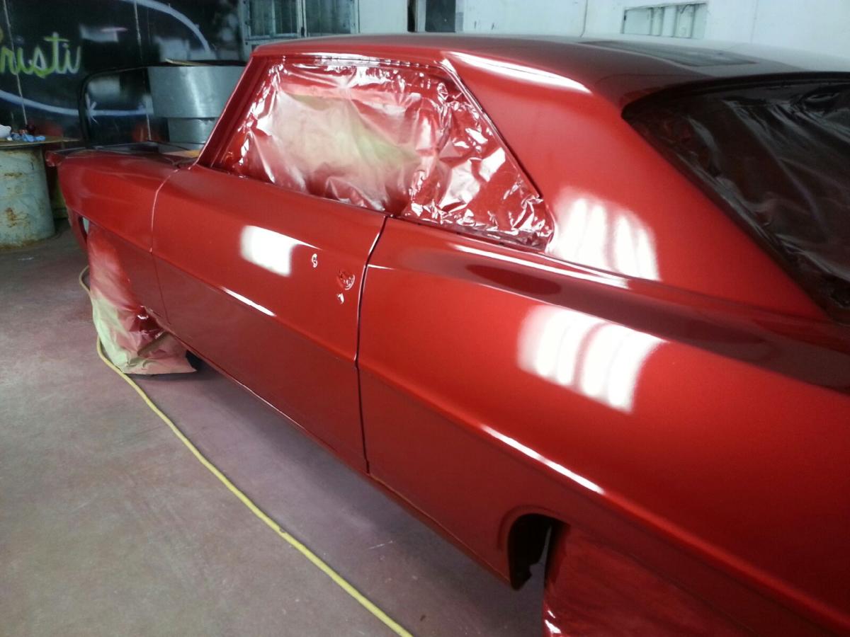

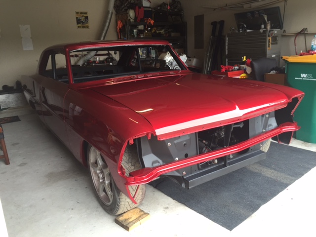

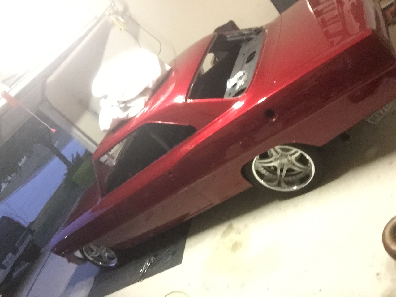

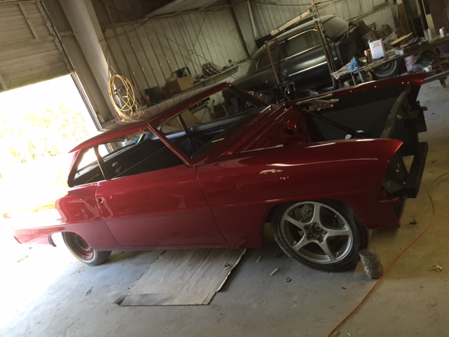

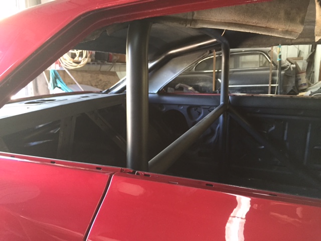

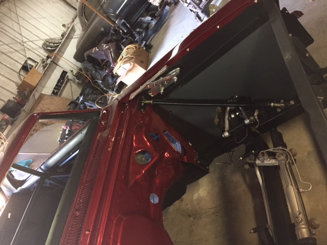

      Project update feb 15
      Wow, its been a day or two since I last updated this thing. ALOT of big life changes have came up over the last year. But after working a lot on the car it is finally back on the road!
      To start paint was finally finished up in October, here are some pics from when I picked it up.

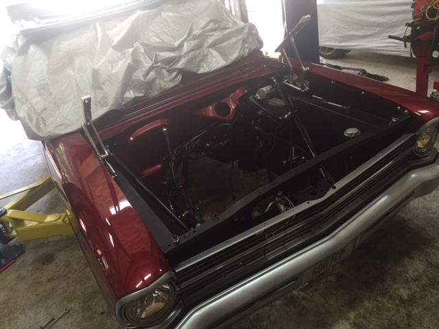

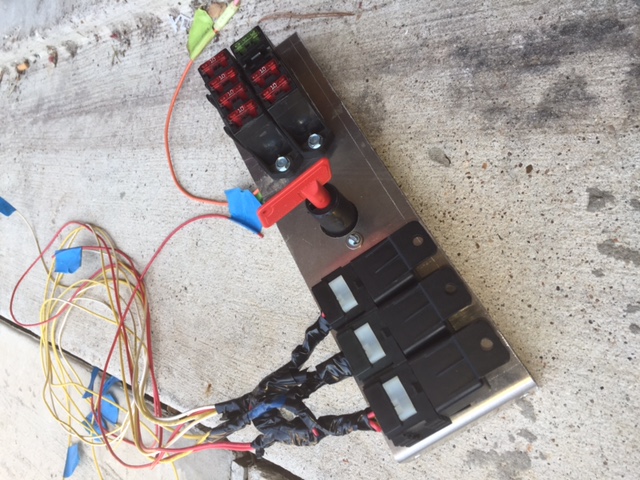

      I made a little panel/pcm holder out of an aluminum jegs electronics tray. The pcm sits directly below where the hvac controls used to be, the control panel sits in front of that. Planning to make a center console to conceal all of it but still have accessibility through a removable cover/door. Name:  image8.jpeg
      Here I was going through some final soldering/wire grouping to maintain some of the chaos of both chassis & drivetrain harnesses

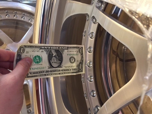

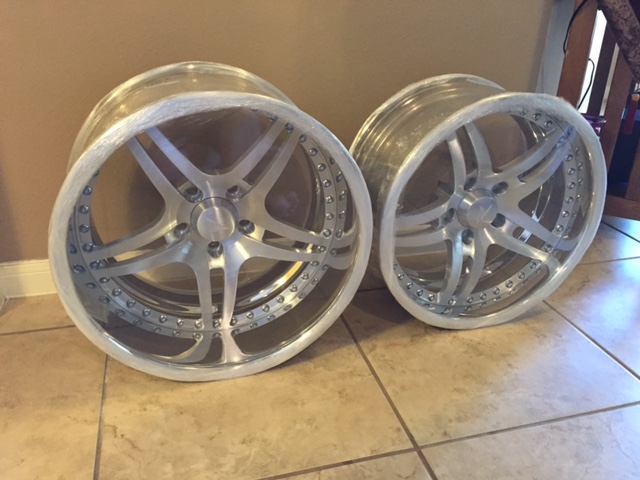

      Here are some real pieces of art! A huge shout out and thank you to Jason @ Rushforth wheels for working with me on my order. These have to be the nicest wheels i've seen in a while! (Rushforth "livewire" wheels with brushed/cleared centers, perimeter hardware and polished lips)

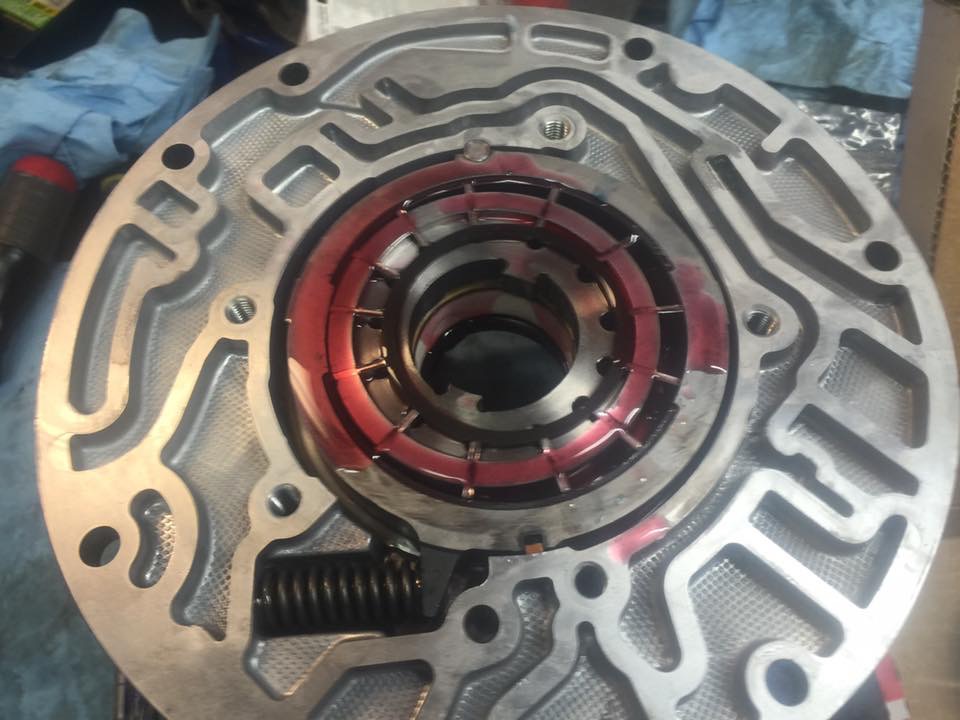

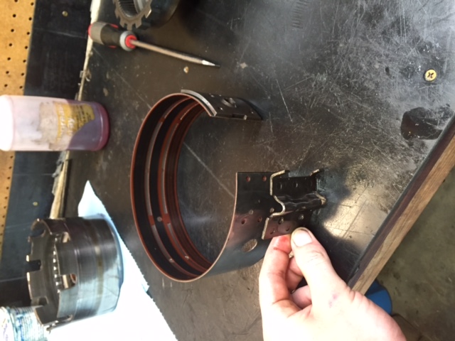

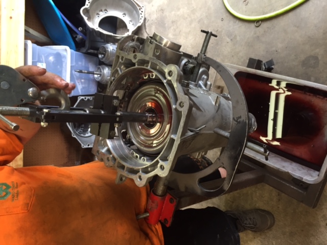

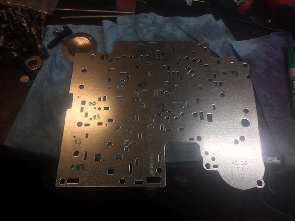

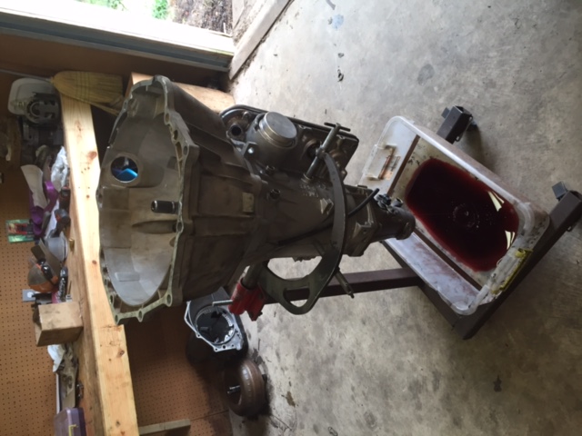

      Feeling confident and happy with the cars performance i signed up for the optima search for the ultimate streetcar in mid July for the Circuit of the Americas event in Austin TX august 6-7. I was still missing a few pieces of trim and hadnt finished the interior but felt confident in the mechanicals enough to beat on the car.
      I purchased a "built" 4L60E and converter from what i beleived to be a very reputable builder several years ago. I put around 2K MAYBE 3k miles on the trans with an appropriate sized transmission cooler and good fluid over the several years since i purchased it. During paint i sealed up the transmission and put it in the corner of my garage. After assembly i took the car out one day to a car meet a few miles away and when i went to back in I placed the car in reverse but it took extra throttle to get the car to move. It acted like the brakes were on or a band in the trans was applying when it shouldnt. When i drove the car home it acted fine for the first half of the drive but then started to not want to shift into 3rd at wide open throttle. I checked the shifter detents and all felt firm and clunked into each gear, i repositioned the shifter linkage to make sure it wasnt in a bind, checked hot fluid level, checked with a scanner to make sure there weren't any DTC or the trans was in limp mode. Next i dropped the pan and checked all solenoids and changed the oil and filter. Nothing seemed out of the ordinary but the problems still persisted.
      Being a few weeks before the optima streetcar challenge i decided it needed to be pulled and at least fix what was wrong with the trans. I called the builder and since it was out of the warranty date they said they would go through the trans and rebuild it completely for the cost of shipping and $900 or so in parts and labor. Not wanting to ship the trans to pennsylvania being so close to the race i got in touch with a friends trans builder here in texas. During dissasembly he sent me a few pictures that made my skin crawl.Name:  IMG_2402.JPG

      Transmission 2
      So after seeing the trans needed serious help i had the new Texas builder (Grimm Performance Transmissions) order parts needed. List included new wiring harness, clutch packs, bands, billet oil pump, Sonnax smart shell, valve body seperator plate and seals.
      All of the parts came in rather quickly except for the billet oil pump which delayed assembly a good solid 2 weeks. Once the pump came in he assembled the transmission, threw a quick coat of paint on it and had a friend go pick it up.

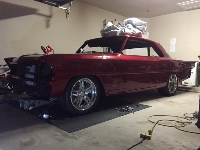

      Feb 2012
      Kingwood TX
      70

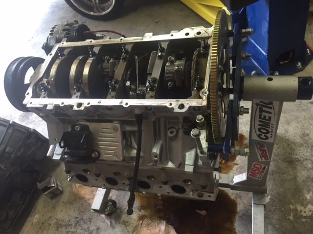

      Engine

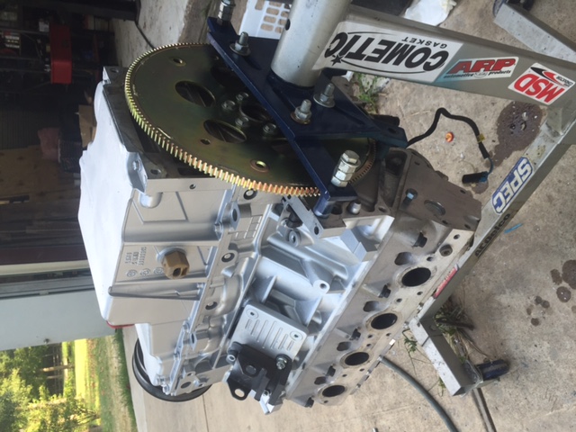

      While waiting on the transmission a buddy of mine suggested i swap a set of ARP rod bolts for stock LS rods i got in a trade into the motor since the trans was pulled. Being a weak point of the LS1 i agreed so we pulled the motor, swapped out the rod bolts, cleaned everything up and evened out the paint.
      Went ahead and bought a new beefier flex plate, a circle D 3200 single disk billet stall converter and some ARP converter bolts as well.

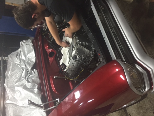

      Before we got the transmission in i went ahead and added a trans cooler in series with the current one in the radiator and a power steering cooler, lines and new adjustable pump since the LS1 pump seemed to be overpressuring the rack. I also cleaned up the headers, installed new spark plugs along with all new fluids.
