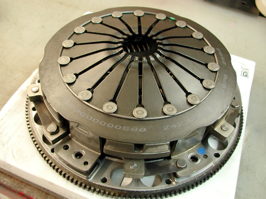

      The CTSV clutch looks similar to this:
      It is a massive dual disk clutch assembly that on the CTSV is mounted to a very heavy dual mass flywheel. I don't know the exact weight, but I would not be surprised if the flywheel and the clutch assembly is over 70 pounds. Compare that to the NASCAR set-up which is probably less than 20. Also remember that MOI is not only about the weight but also the diameter.
