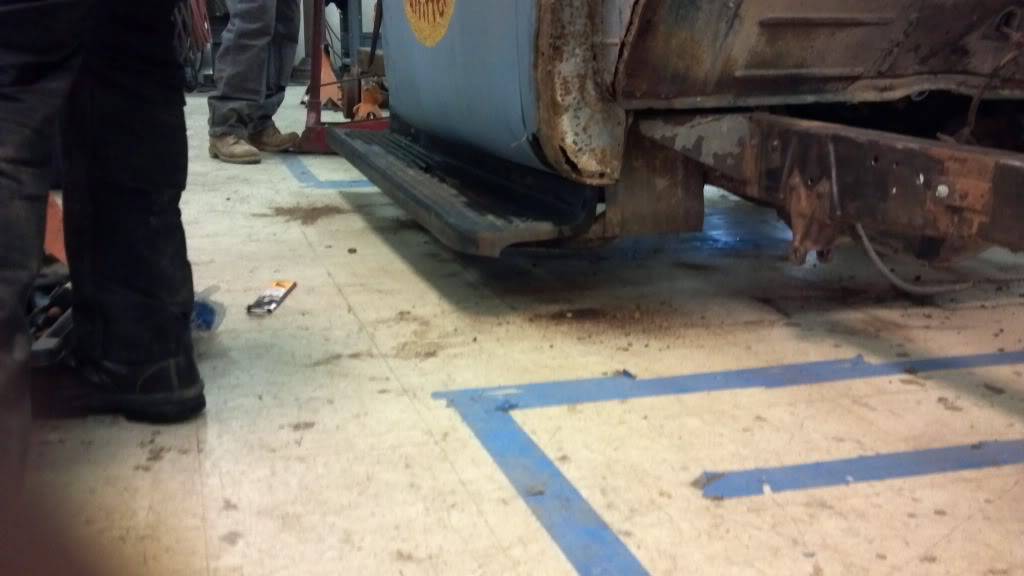

      My original plan was to just extend the hump in the back over the rear axle and use the original frame. After taking a few rivets out i decided to say f*** the rivets and build my own whole frame. Heres where the truck sit as of now.
      This is the desired ride height. The running board sits 5.5" in the front and 6" in the rear to give it some rake. The frame is 11". Now i just need to get all my measurements and start on the new frame.

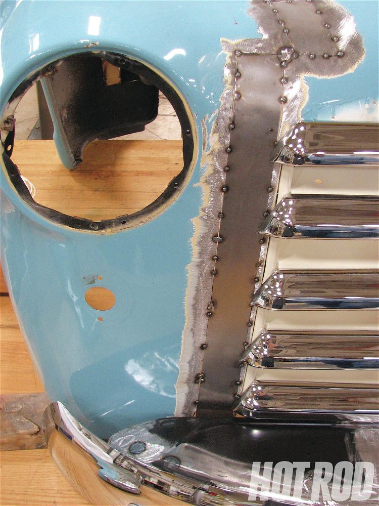

      Widened fenders:
      from here:
      http://www.hotrod.com/featuredvehicl...s_of_suburban/

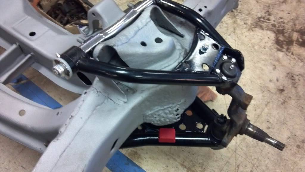

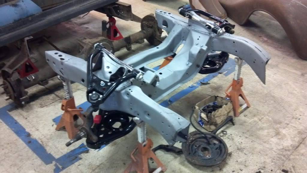

      I put the control arms on the subframe this week and cut all the metal for the frame rails.
      Also ordered a wilwood front brake kit.
