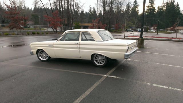

      Took her out for a quick spin. Pic-

      I'm a big fan. The color reminds me a lot of mine when I first got it.

      Very nice. Great job.
