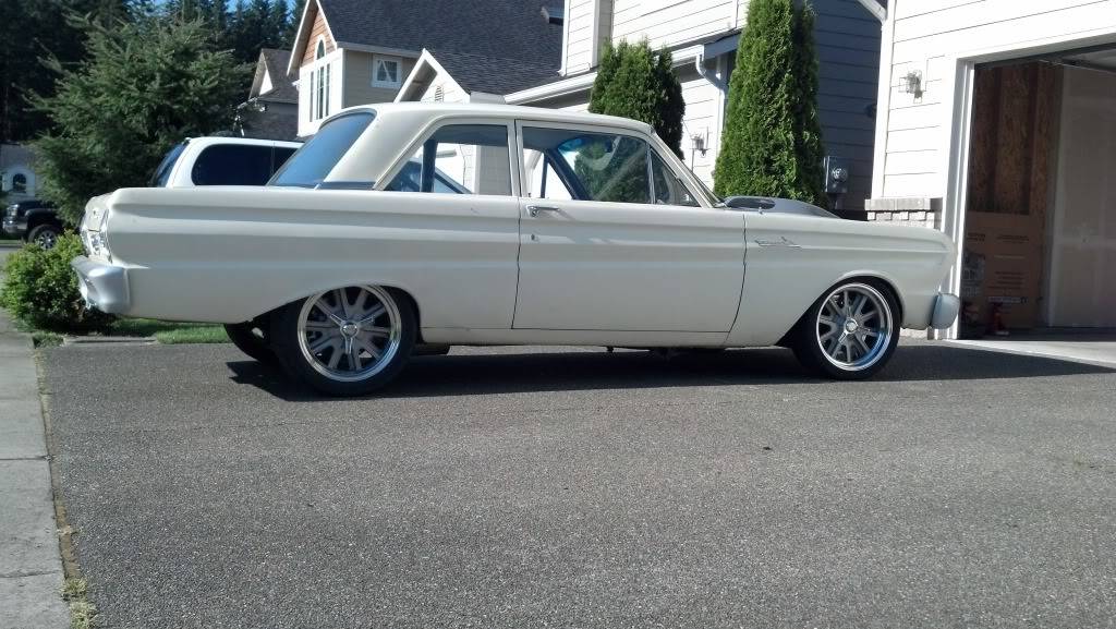

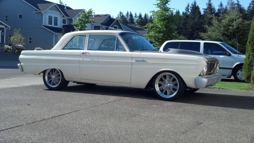

      Those wheels look super great - making me want to hurry my build up!

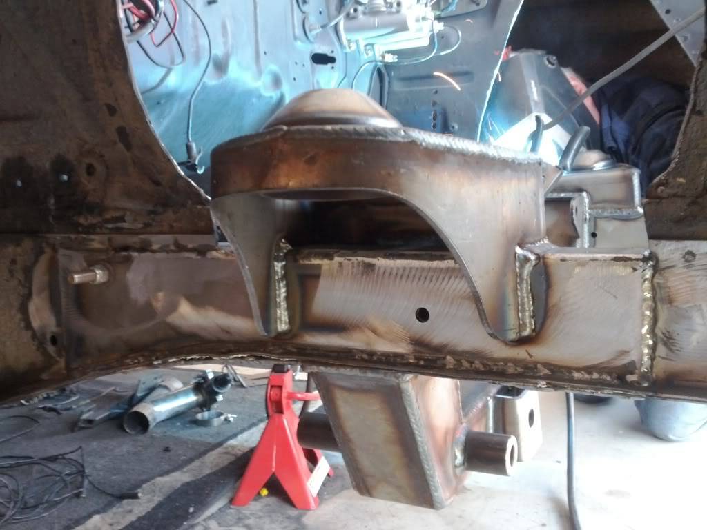

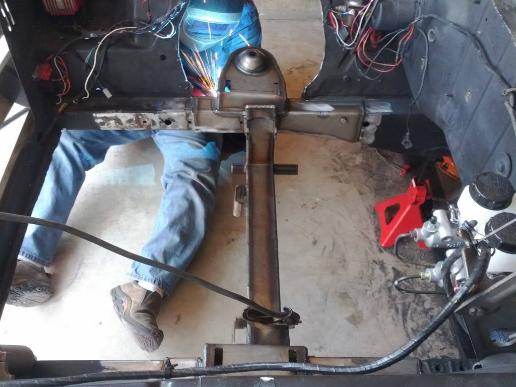

      Updates-

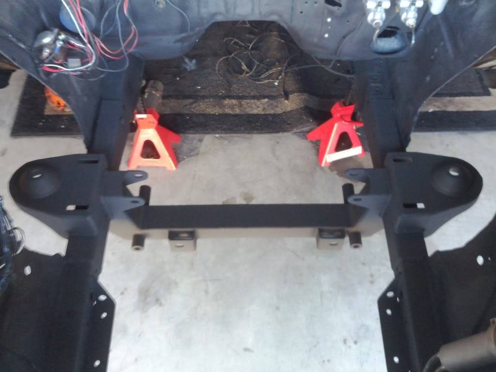

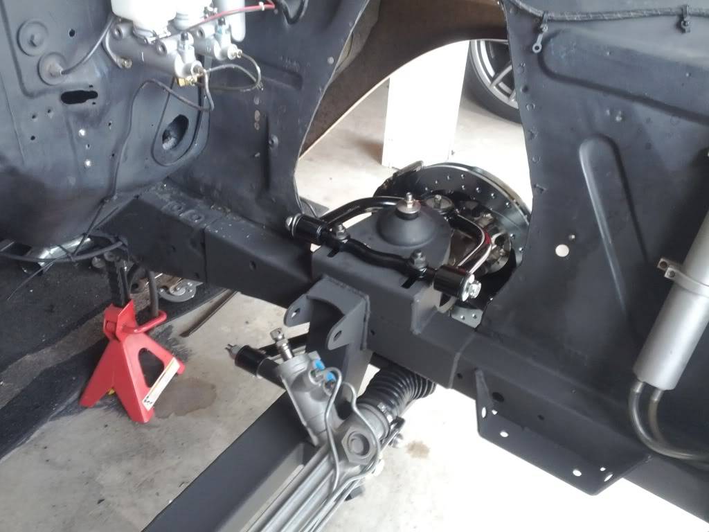

      Was able to get a mobile welder out to the house this weekend to weld in the front end. Turned out really nice.
      Hope to get the sway bar and brake lines ran this week.

      Stance looks great and the wheel choice is perfect!
      More pics for my desktop to keep me focused on finishing mine....

      The stance looks great, as does the wheel choice. How does it handle? I've been stressed too far with my stupid inner-rear fenders, which still rub my tires in turns with my Panhard tightly adjusted (full fuel tank, unfortunately). Let us know what you've had to do to make the rear tires work in a hard turn; the few of us who really push Falcons would like to know, if you've made inroads here (if not, it's cool). Soon, I'll be putting my angle grinder to work in the inner-rear fenders, as the rubbage (under hard turning only) has become a safety issue...

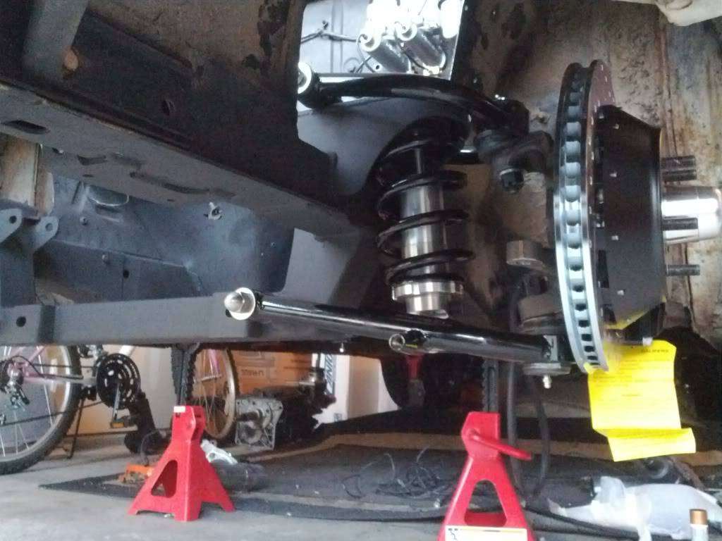

      Do you mind sharing your wheel specifications, especially the front offset/backspace. Also, are your front and rear coilovers set at the lowest point in your pictures? I just received my parts from TCI on Tuesday and the build is underway on my 61.
    16. #56
      May 2007
      Maple Valley, WA
      51
      Quote Originally Posted by 3rdgeneration View Post
      Haven't been on the boards in sometime. If you still need the info - Fronts- 17x7 3.5" Backspacing. Rear- 17x8 5.25" Backspacing. The coil-overs weren't at the lowest point in that photo, but they are now.

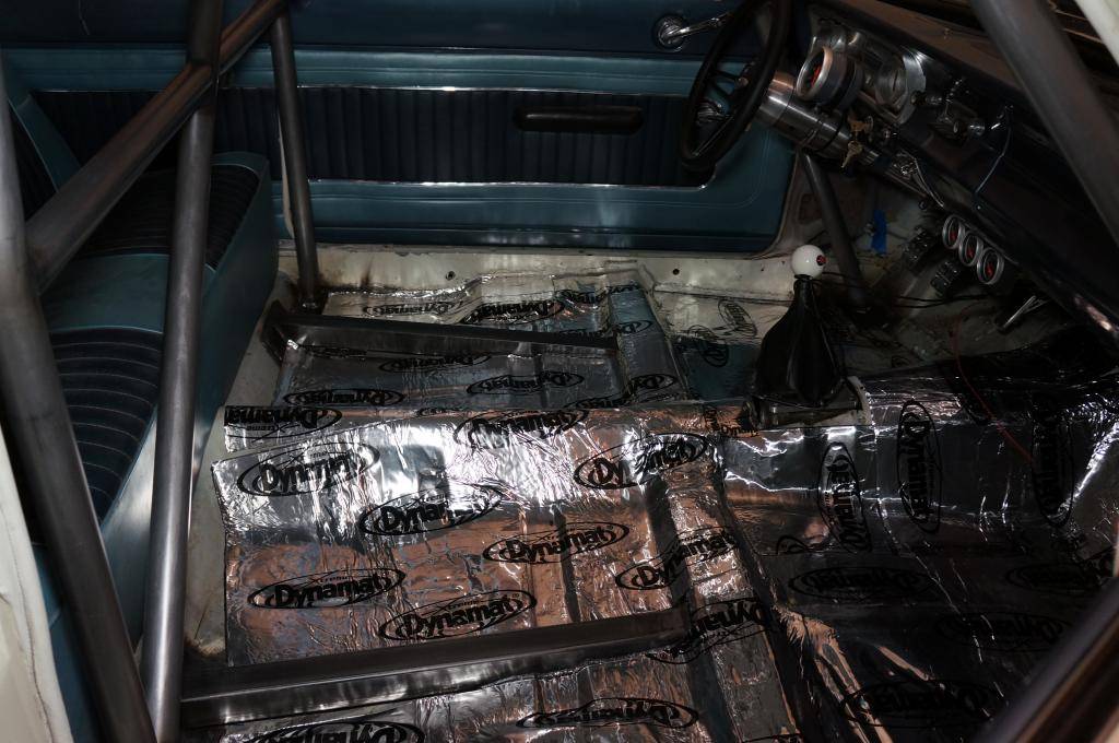

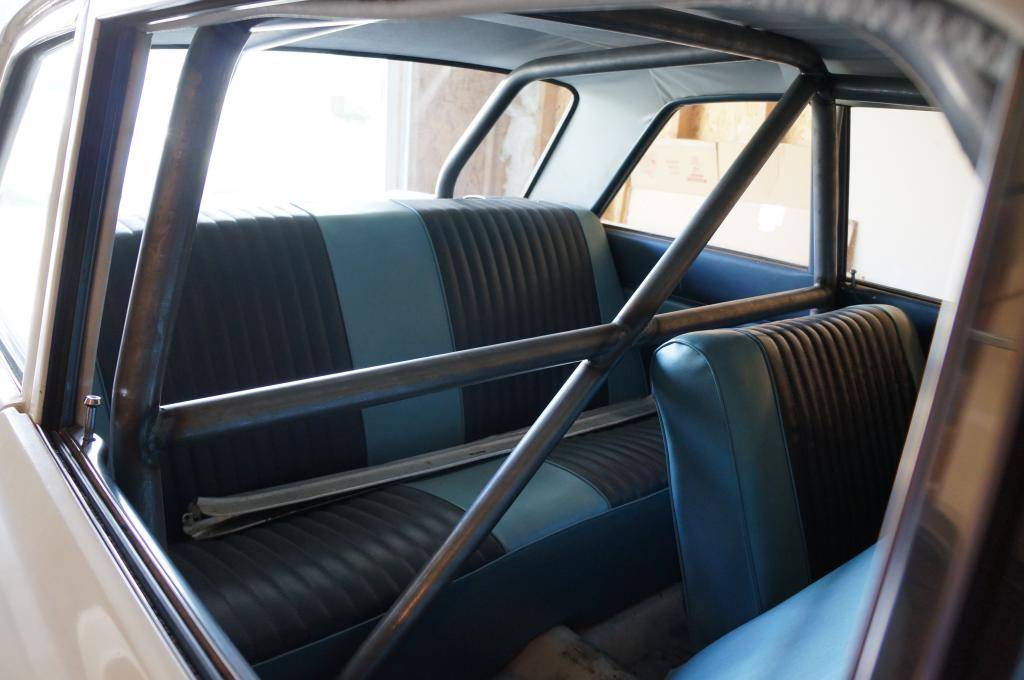

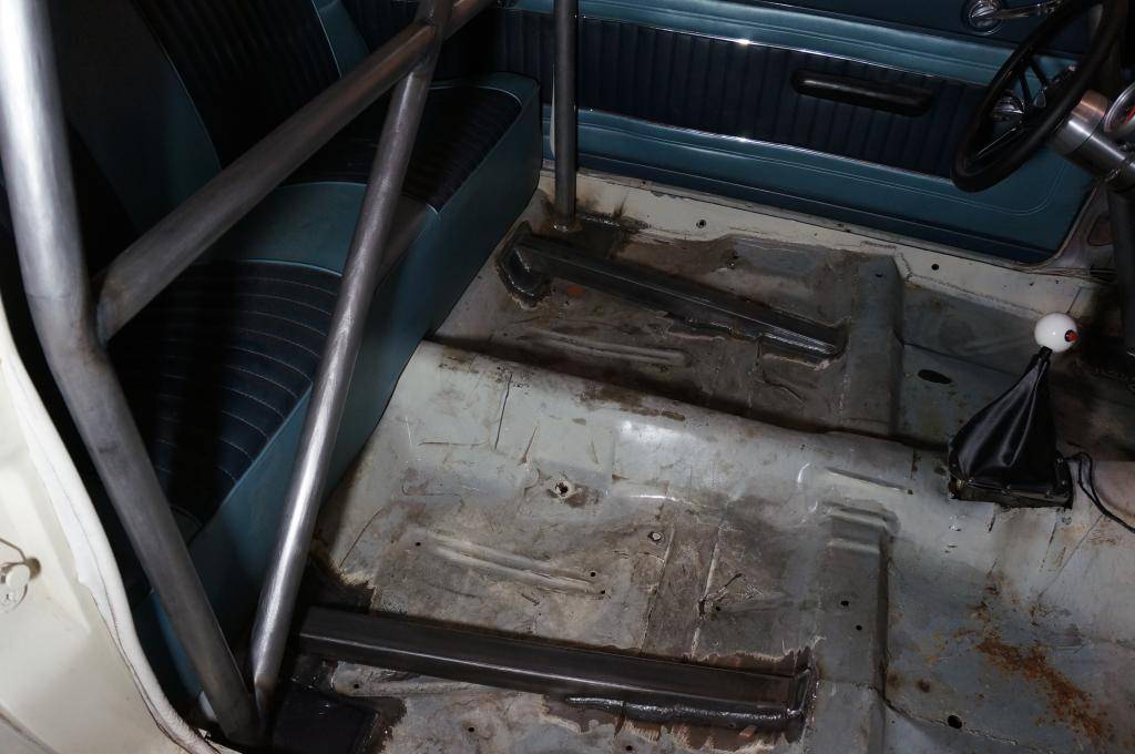

      Updates-

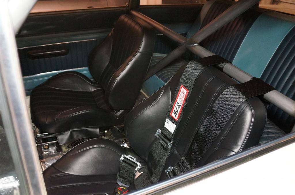

      Rollcage and through the floor sub-frames added. Ron Pircey Enterprises, local to me, did the work and its turned out awesome.
      Also, added some new Procar Rally seats so I can fit sidebars on the cage (not yet done)
      Have some misc things to resolve over the winter time, but plan to take it out for my first open track event next year. Can't wait.

      Very nice... What seats are those?

      Dig the Procars, how comfortable are they?

      Quote Originally Posted by 85coupe50 View Post
      Procar Rally - http://www.procarbyscat.com/Products_Rally.asp
      Quote Originally Posted by LowFast View Post
      Thanks! My buddy turned me on to them. I like them a lot so far. Good back support and nice side support. (Haven't driven the car yet with them but I did my fake driving test with them and they passed lol)
