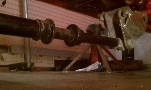

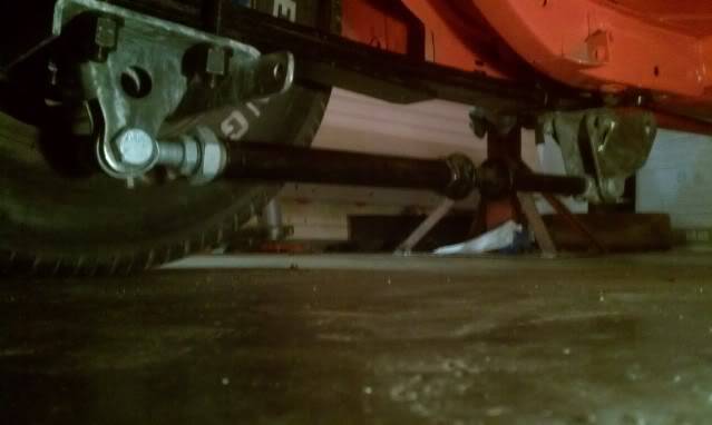

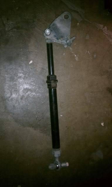

      I got a great deal on these new never installed parts but about four years old and not in boxes, and needed HELP idenifying some of them
      (2) hotchkis muitileafs.....stamped # 24910014-0 (not sure if there 1.5" or 3" drop leafs)
      (2) traction bars/caltrac bars..... No stamps (not sure who makes them)
      Here are some pics of the reartac bars (mocked up with the hotchkis leafs and 1" blocks, who makes the bars???

      forgot tot mention this is on a 68 camaro that use to be a monoleaf

      Those look like slide a links:
      http://www.competitionengineering.co...?CatCode=13116
      I think there should be a bushing in the slip section though...

      Dead on. Its an old version of the CE slide-a-links. They work very well for drag racing, and you can get some really good 60 foots with those.

      Thanks for the help guys, thats exactly what they are.
      So should i run them on my camaro its mostly going to be a cruiser and ill probably try some autocross events but nothing too serious. I read that they can be kind of stiff in the corners? OR are these strictly for drag racing? Dose any one have any experiance with these type of bars?
      Turns out that the leafs are Hotchkis 1.5" drop leafs i had to add 1" drop blocks to get my desiered ride hight.

      With the hotchkis springs they're kind of redundant. The stronger hotchkis springs wont bind like factory ones will, and that's what the CE kit fixes. IF you were going to drag race, on slicks, at a prepared track, then I would run these. Otherwise they're just big things to scrape on speed bumps.

      You shouldnt see any difference in ride quality with those, they only work on HARD launches. I do agree they look cool. Its probably not that expensive to get them powder coated a color that compliments your car.

      Agreed. They should have some sort of coil spring or rubber bushing to take up the space on the sliders, otherwise the bars will do nothing until they fully collapse, IF they ever get that far...
