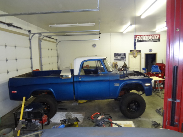

      Really guys, its not anything to get excited about. I just inherited a 1969 shortbed 4x4 Dodge pickup setting on a newer 80's chassis, 5.7 hemi efi., 727, 205 t/c and Dana 60's front and back. Its a really cool old hillbilly truck, which I'm trying to get running before I switch back to the AMX. I'll post some pics as soon as I take some.

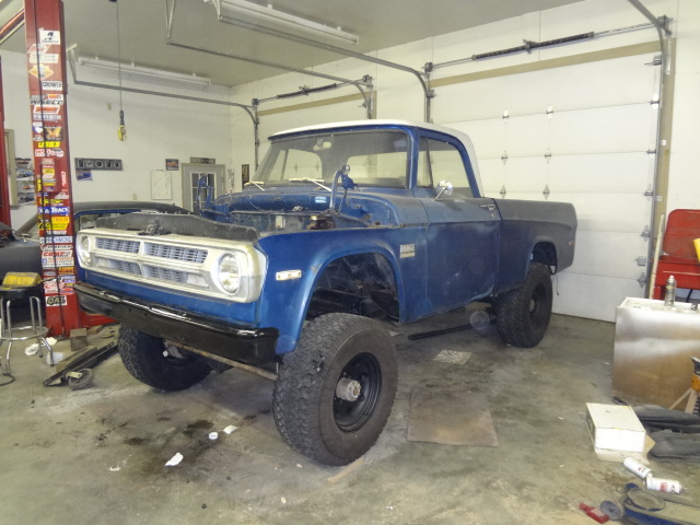

      Took a couple shots of my new Hillbilly truck, I really like trucks for some reason.

      looks kinda like a Baja truck with the nose up, thats really cool Ron. Don't see many of those around anymore.

      That is still up in the air, the truck will definitley be EFI, I'm trying to deside wether to slide a big cam in it, and run LS1 electronics like I did in my Cuda, or just stay with factory Dodge stuff and leave it stock. I just installed a 1991 Dodge Ramcharger EFI fuel tank and mounts in the back with a GM LS1 fuel pump in it. Just don't know if I want to spend the time or money to modify the Hemi.

      Yeah, my first thought was to put a Cummins in it, then I thought about how loud and obnoxious the older ones were are in comfortable trucks, in this thing they would probably make me not want to drive it.

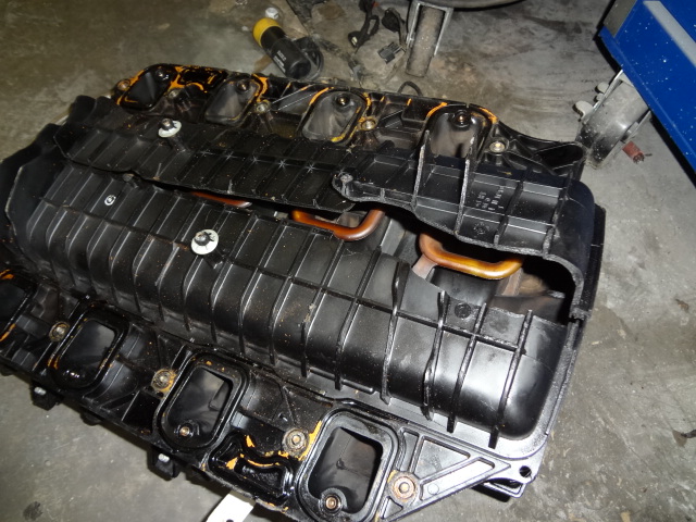

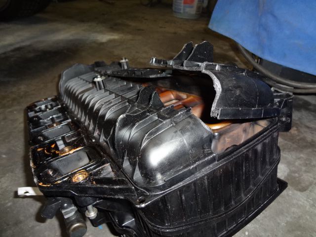

      EFI tech: When you can't get a new efi project to start, don't pour gas down the plastic intake manifold. Because although it may fire off several times, the belly that you don't see in the bottom of the manifold holds fuel, the fuel has no way to get out(well almost no way). If it backfires, or when it backfires, there will be a big explosion and plastic off the manifold stuck to the ceiling. Come to find out the hose inside the fuel tank had a pin hole in it bleeding fuel pressure, I did finally figure it out with help from my buddy Troy, and it runs great. Now that the truck is running, it will be AMX time.

      lol nice! Tech advice time is over, GET BACK ON THE CAR!!!! lol
      Robert
    18. #518
      16,129
      Priceless. Note to self: EFI is not like a carb.
      Note to Ron: install fuel pressure gauge.

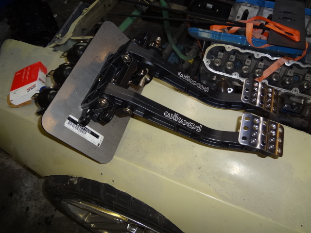

      On a side note, my pedals did come in today.
