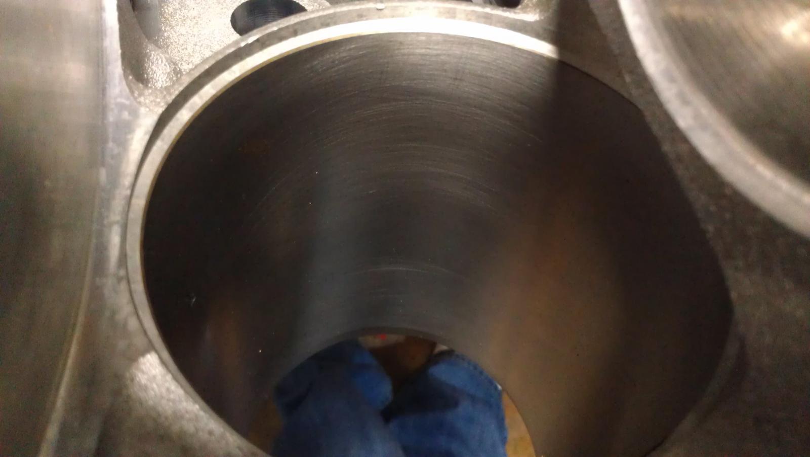

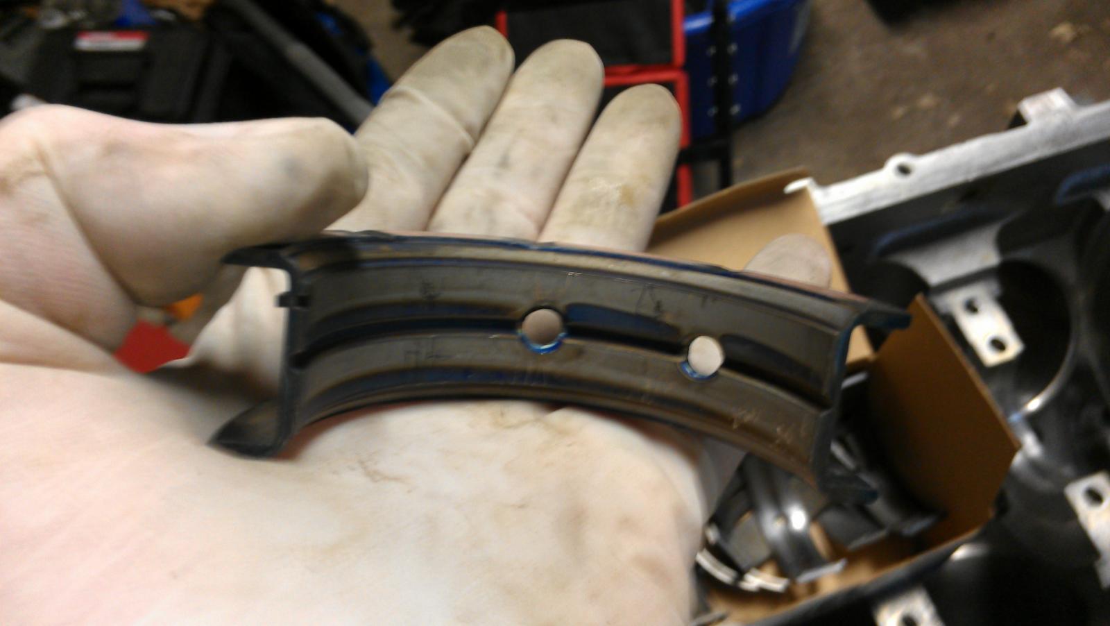

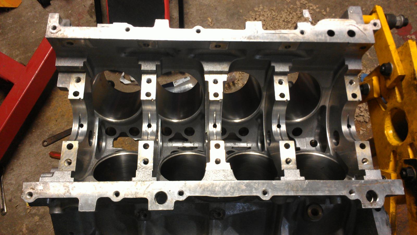

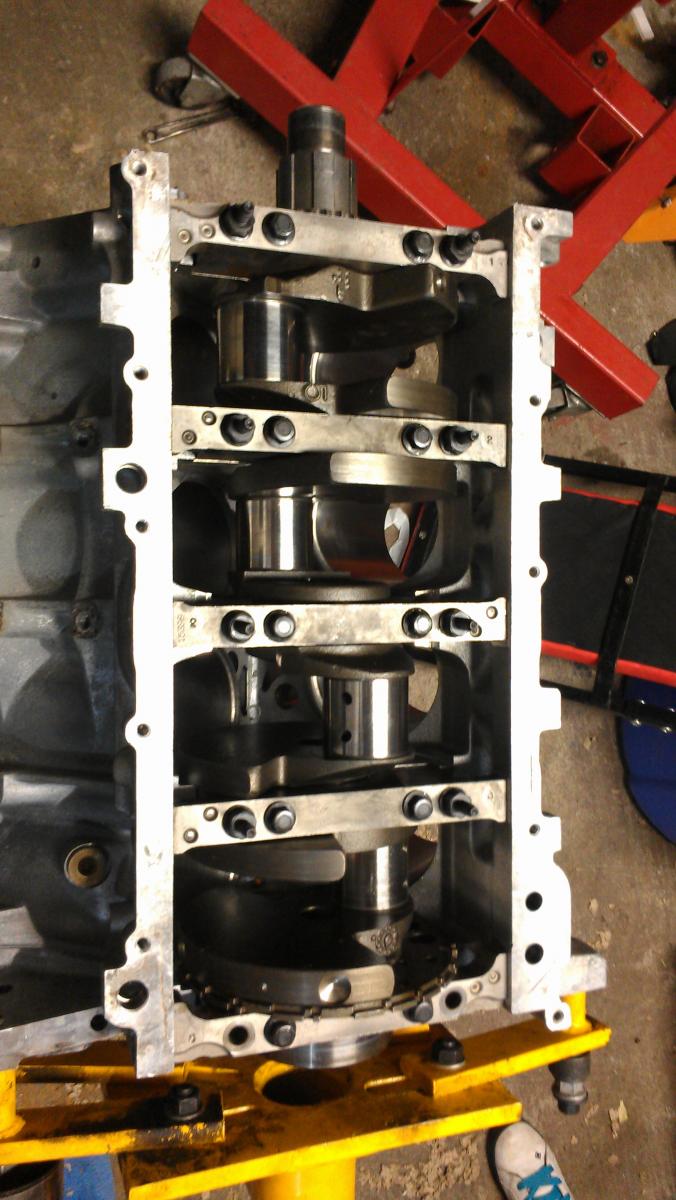

      Well you can definately tell its a low mileage motor. Bearings looked beautiful but came with a new set of Clevites so I went with them.Name:  IMAG0005.jpg
