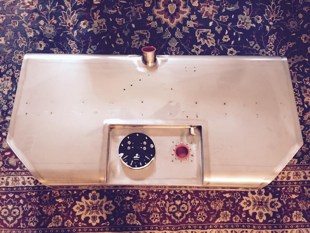

      Skipping Boost a pump and Tanks Inc fuel tank (with Walbro 450)
      Going with a Rock Valley stainless steel tank with Dual Aeromotive 340lph E85 pumps.
      Oct 2011
      467
      Quote Originally Posted by Blevinator View Post
      Thank you!
      Very near mechanics now.
      Added harness for my TCI paddle shifter.
      Rock Valley Tank with twin Aeromotive 340lph pumps
      This is the Aeromotive Phantom setup in an E85 tested pump vs standard pump
      Tank has a really nice baffle provided by Aeromotive to prevent starvation.
      Before anyone comments, baffle has been tested for a long while and doesnt degrade with E85 (I confirmed with Brett at Aeromotive)
      I am thinking I will do a full polish on the tank.
