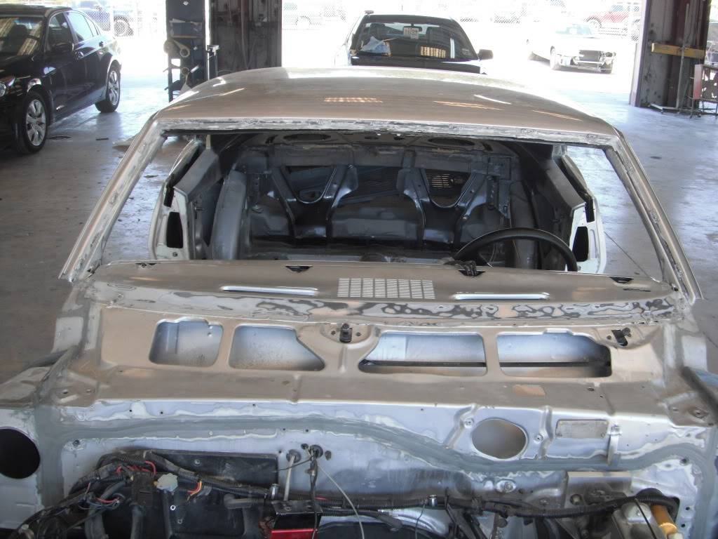

      After doing a thorough review of my body and paint work,
      we decided to do an entire repaint, as well as a few
      other tweaks. After reading several articles, I decided to have the car painted
      with all panels, trim etc. off the car.
      Body disassembly started

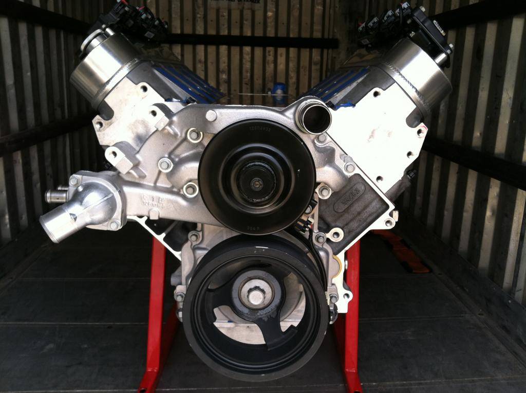

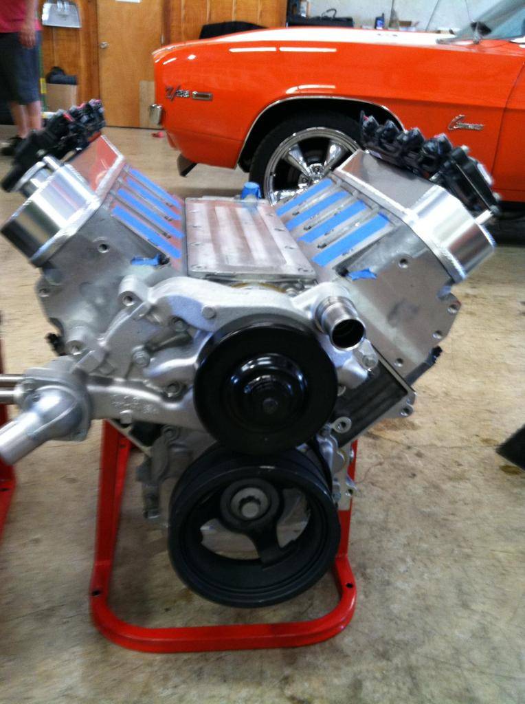

      Katech LS3 crate motor (Forged Mahle flat top pistons, Katech rod bolts, ARP head studs, hardened pushrods, PRC dual spring kit,
      C5R timing chain, Total Seal second ring, Melling high volume oil pump, ECS "small" blower cam mid 230's, 588 lift on a 117 LSA)

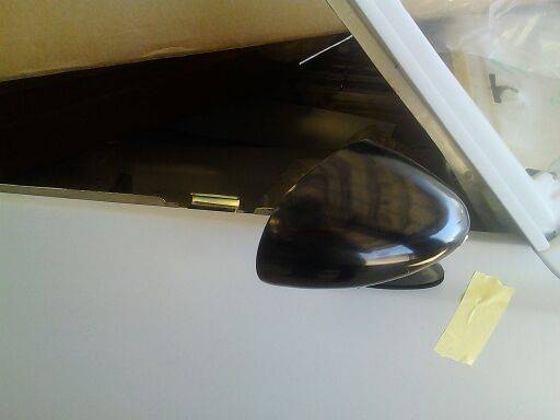

      1970-81 Camaro bullet mirrors painted to match car. Mirror bodies were media blasted have new mirror glass,gaskets,hardware.

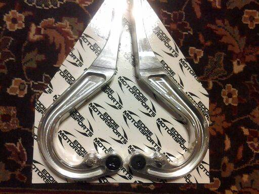

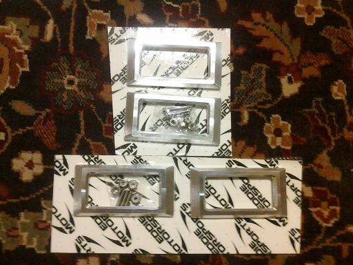

      Eddie Motorsports taillight bezels
      Eddie Motorsports trunk hinges
      Eddie Motorsports marker light bezels

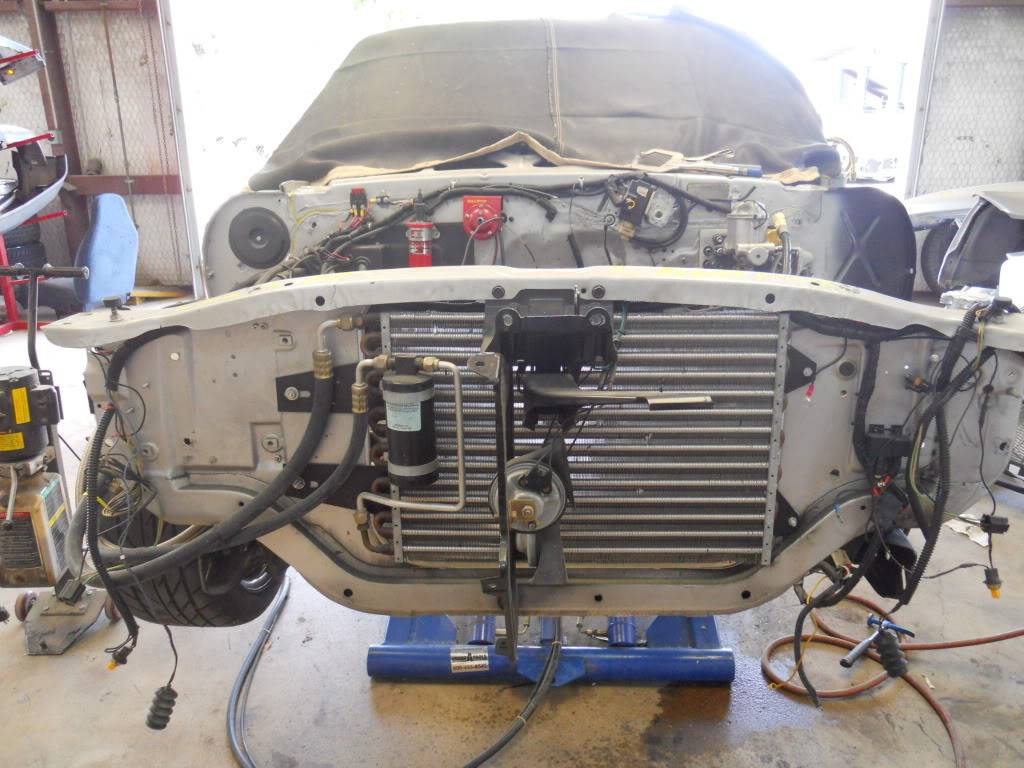

      Vintage Air A\C (Gen IV)- SPAL fans!

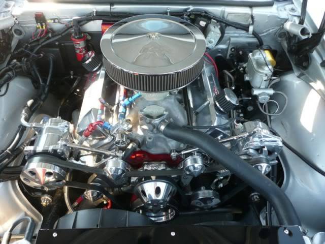

      "Old" 383 Stroker only dyno'd at 354rwhp
      Sorry! 383 wasn't getting the job done!

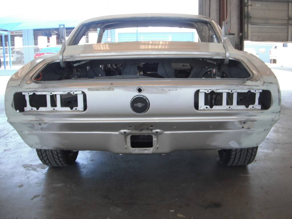

      Last restoration was 3000 miles ago

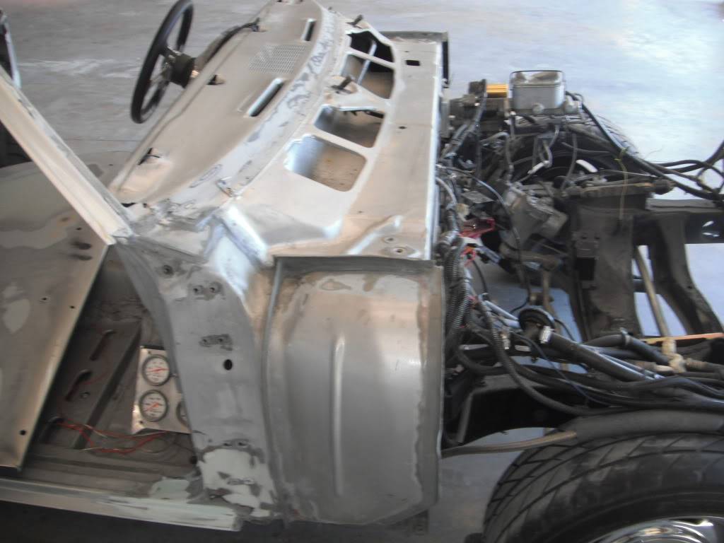

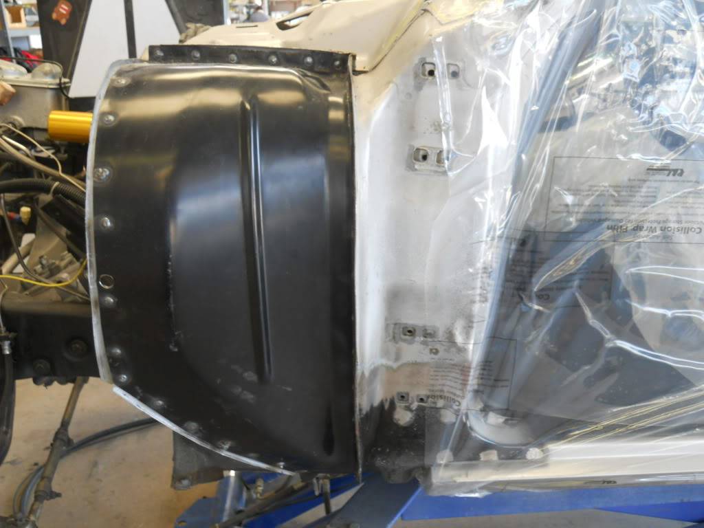

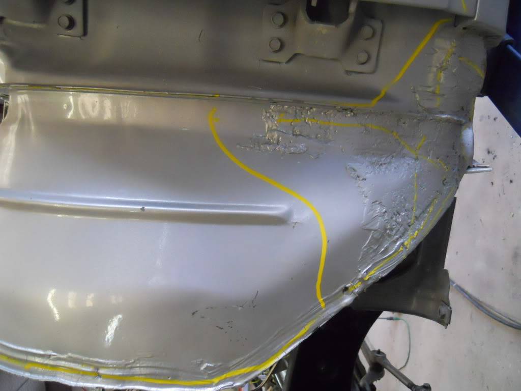

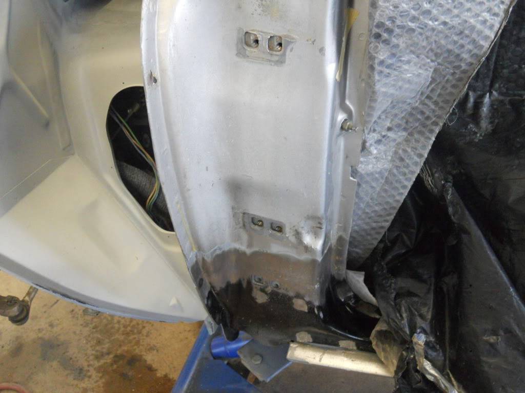

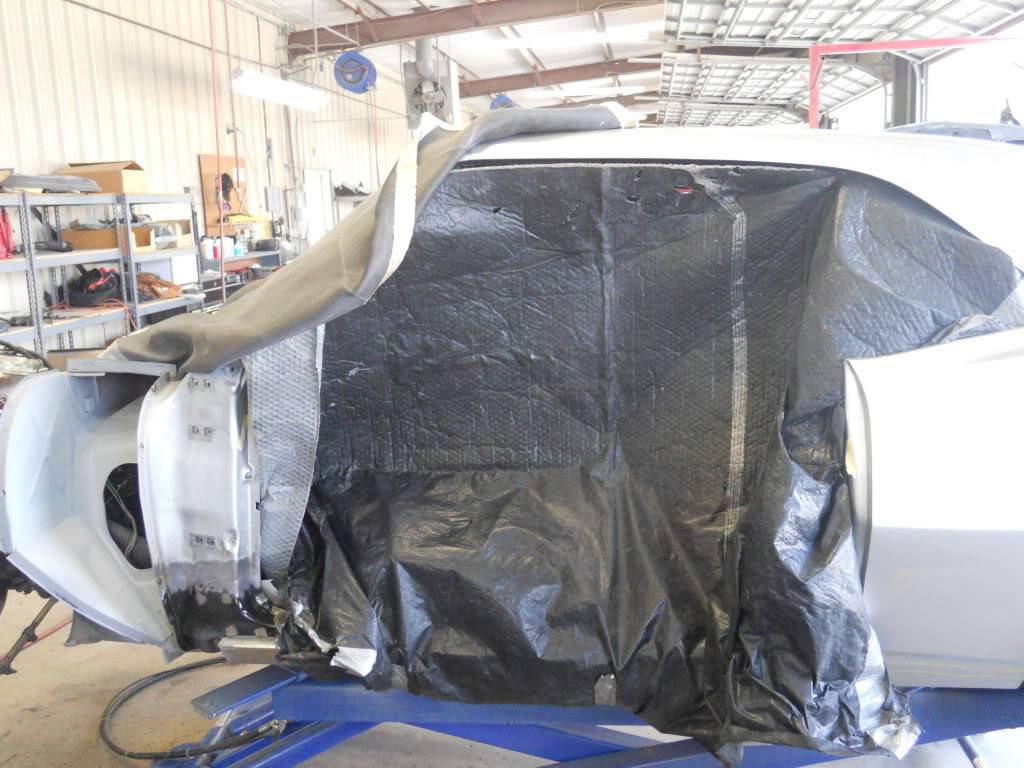

      Patchwork found under front fenders. One of the few replaced panels on the new transformation.

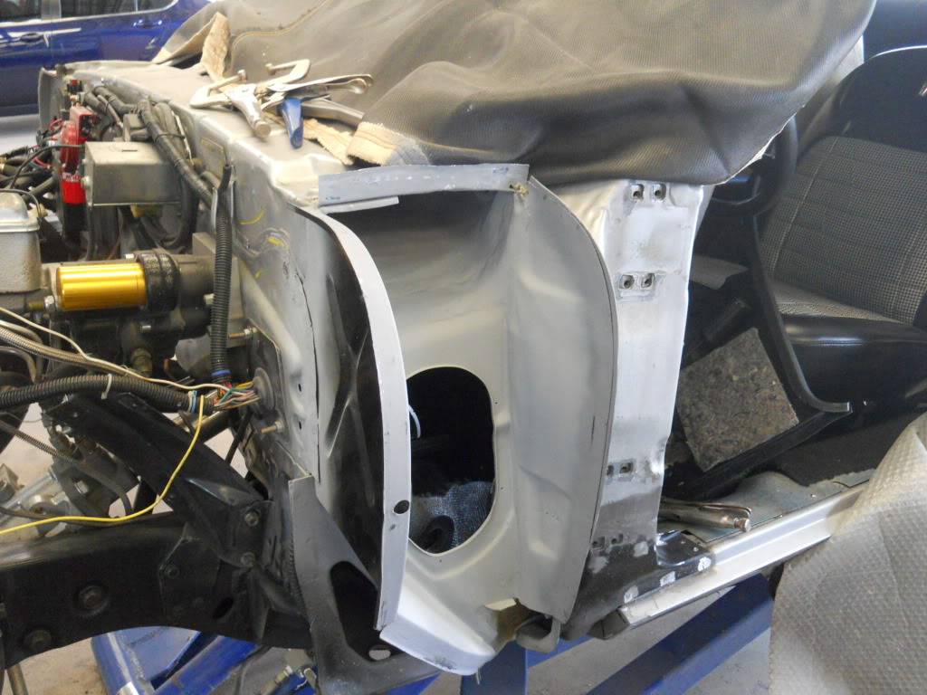

      Offensive panel removed. RH Tulip panel was good. Replaced lower sill panel (on right) as well. This was done on both sides of car.
      New Tulip panel installed.
      Closeup of LH lower door jamb replacement panel. Same panel replaced on other side of car.

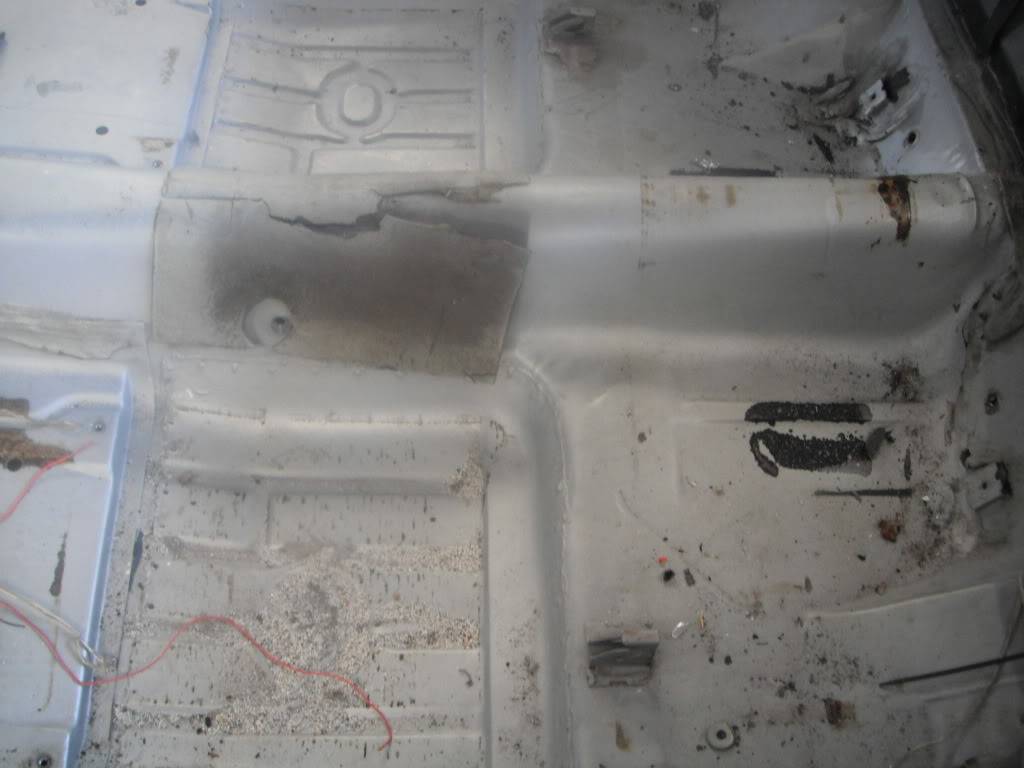

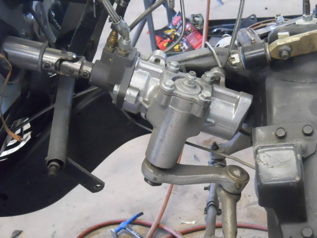

      DSE steering box
      Solid floorpans. Had been replaced upon last restoration.
      Even left some blast media under the carpet!

      Going to include pics of the minitub job as it will be done tomorrow.
      Thinking of pulling the frame and powdercoating it, as car is pretty much a roller.
      Especially since we notched and boxed the frame. No rust for me! Guess it's my OCD acting up!
      Have to know that car has absolutely zero issues.

      Oct 2011
      467
      Just had mini tub kit installed.
      Back at body shop getting soundproofing done,then back to paint booth.
      More photos soon. Car is taking a while, but will be great when finished.

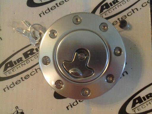

      467
      Katech forged piston LS3
      Dakota gauges

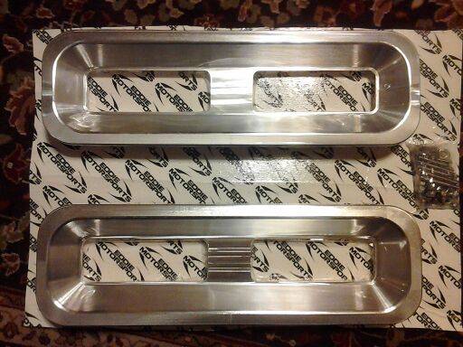

      Taillight bezels
      Trunk hinges
      Side markers

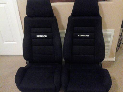

      Corbeau seats (will be covered in leather to match rear seat, no headrests when done)
      Bullet mirrors will be painted body color
      335MM Toyo R888
      Gas lid
      Mini tub is done
      Seam sealing tubs, floor pans, cowls etc.
