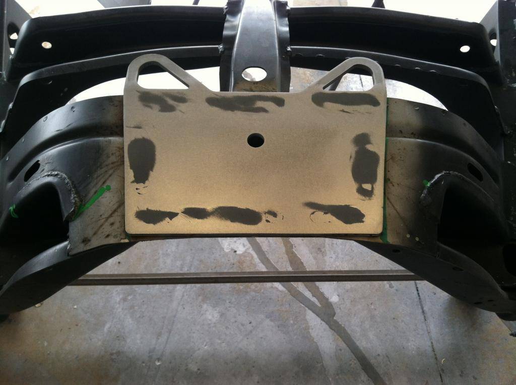

      Welded Screamin Performance tow plate on new subframe

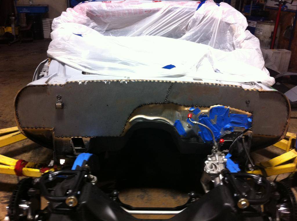

      Making sure it all looks right
      before each next step is super important
      to me on this car.

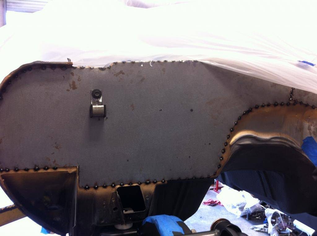

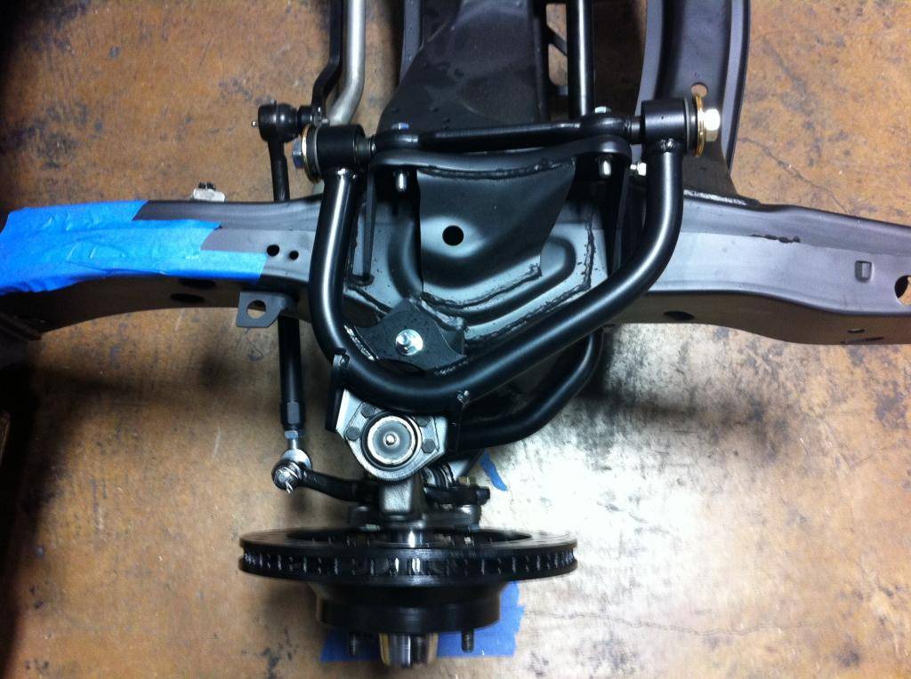

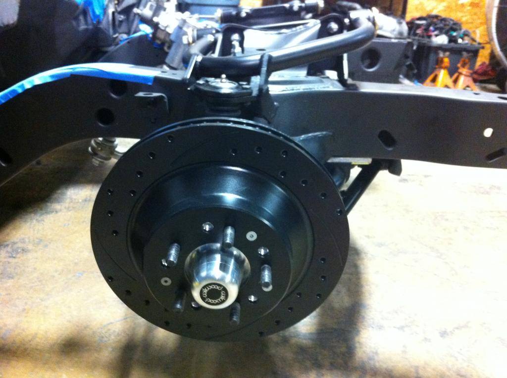

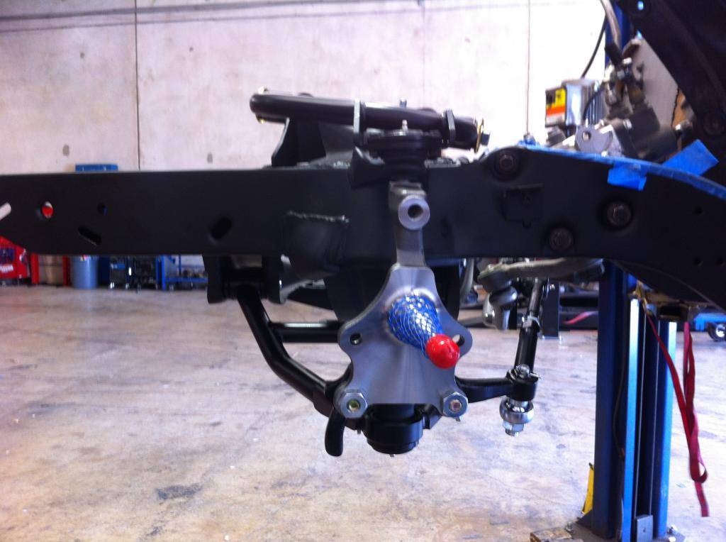

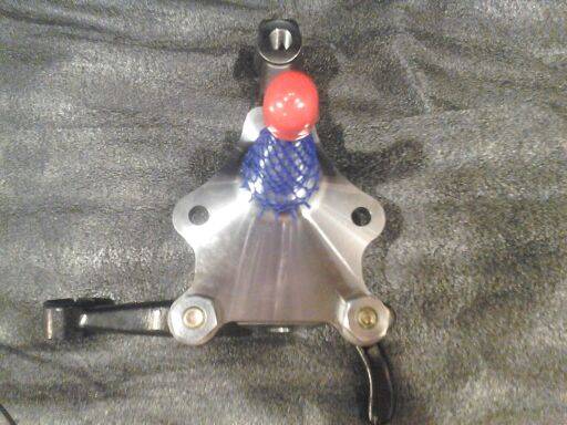

      Started working on the firewall. Applied Lizardskin. New subframe installed. Front suspension is almost done.
      Welding in BMR subframe connectors.
      Should have powdercoated the Ride Tech spindles before install.
      They developed surface rust just sitting in the shop.
      Removed them and powdercoated them black.

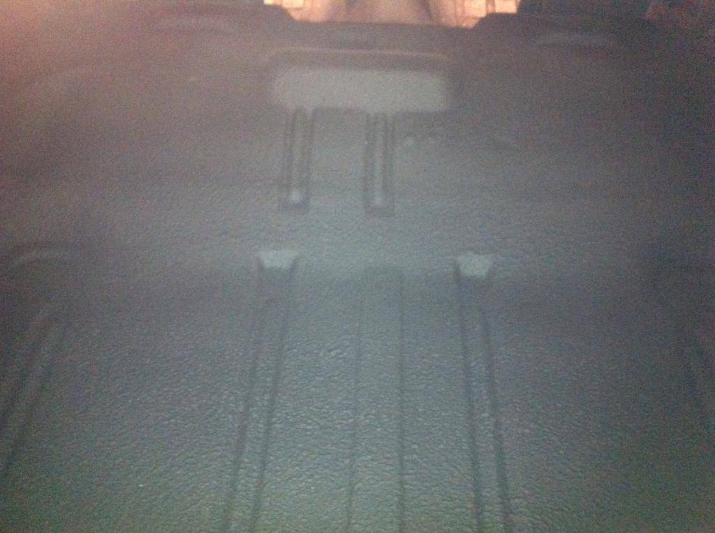

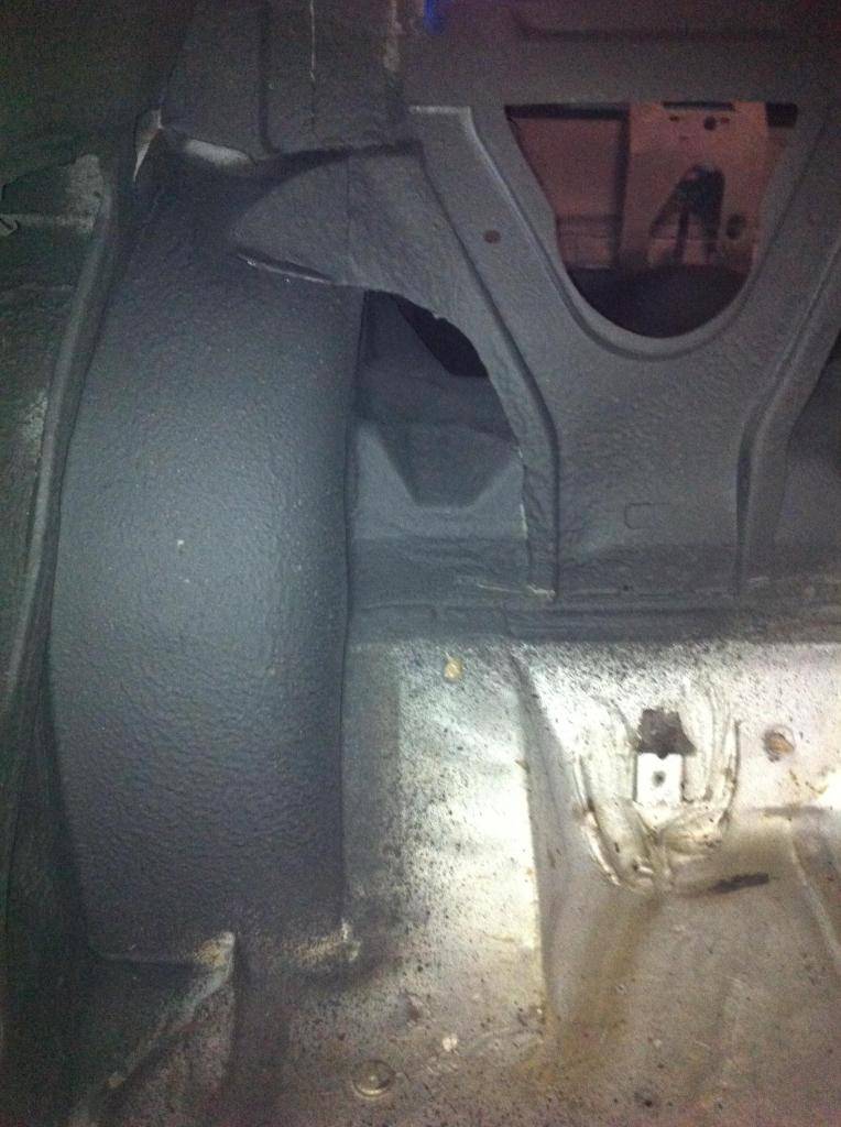

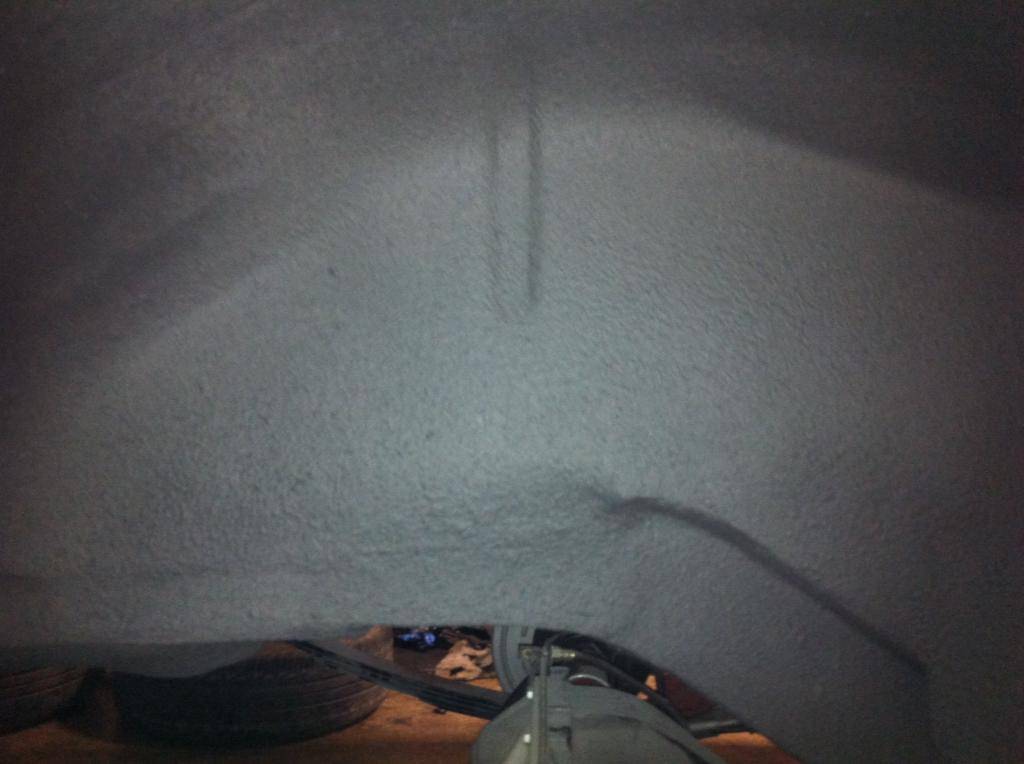

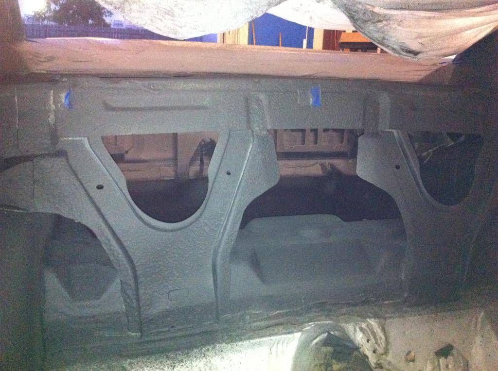

      great project....need to know how the lizard skin went on and are you happy with it...?
      Oct 2011
      467
      Quote Originally Posted by TonyV View Post
      The guy that applied it said it was easy to spray. I purchased the Lizardkin application kit to help things along.
      To me, it made a huge improvement over the way the underbody looked. I am very happy with it.
      We did quite a bit of work to make sure the bottom of the car would look great before spraying it,
      including using panel bond on all seams. The car was stripped of all components,brackets, clips,etc. before spraying.
      We also sprayed it with the subframe removed. I feel prep is 99% of what will make this application look good.
      It looks much better than bedliner and should make a huge improvement as far as the noise level of the vehicle.
      Will be spraying the interior with Lizardskin ceramic insulation early next week.

      good to know....i'm still on the rotisserie but plan on shooting it here in about a month...been working on prep as you said can't do enough. I also plan on shooting it with a single stage ureathane. How much did you use ........i bought 6Ga of the sound deadner and 4 Ga of the ceramic....?

      Car is at Sweedens Paint and Body in Garden Ridge Tx getting firewall smoothed and painted before major mechanical is started.
      Finally, the fun begins!
      looks good but make sure they pull the sway bar and flip it over before they drop the engine in.
      Thanks guys!
      The shop that put the swaybar on wont be touching my car again!
      I have a great mechanic now that is going over all.
      I bought stainless bolts to replace all suspension bolts that weren't stainless or zinc
      plated.
      I also purchased Billet Specialties Pro Bolts for the front sheet metal and
      Totally Stainless OE style stainless bolts for the rest of the body. Inside the car,
      I have a master screw kit that is labeled for each area to make sure the small details
      are correct.

      I used 4 gal sound control so far. Probably will use the same on CI.
