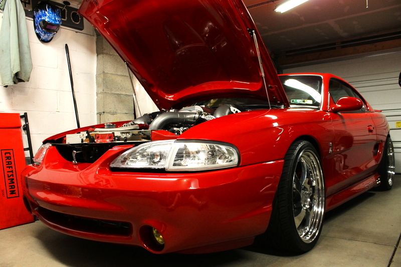

      Some completed pics courtesy of a couple of my photographer friends
