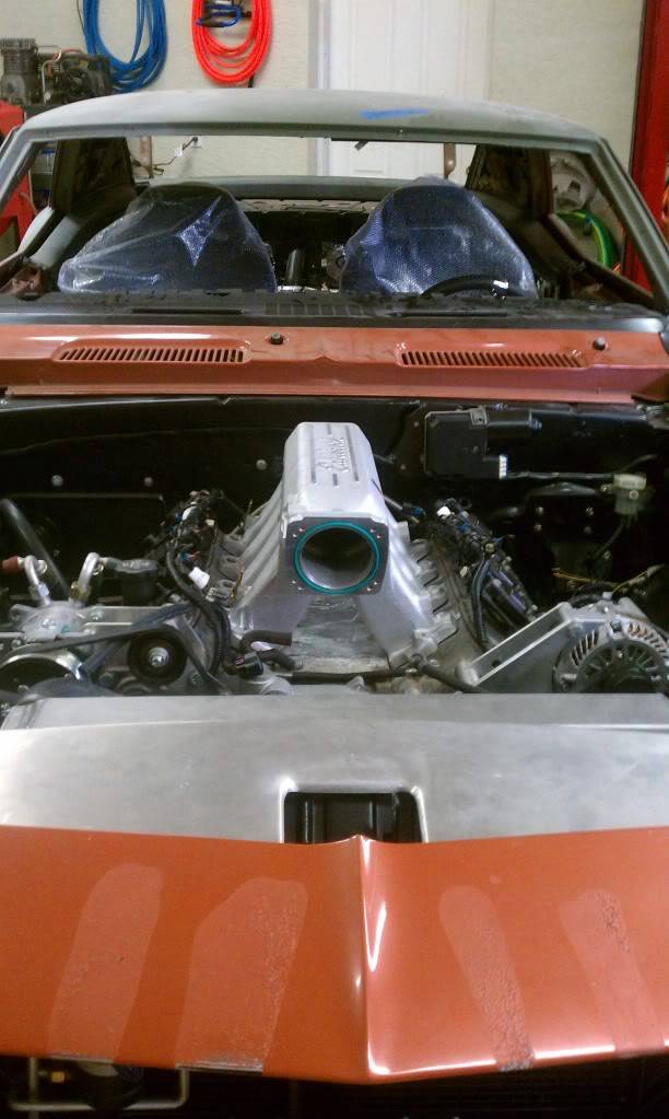

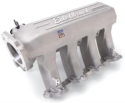

      I really need to finish this thing soon so I stop adding on to the list of crap to change lol I came across edelbrock's pro-flow xt intake and thought it was a good alternative to stock or fast intakes everyone is running. Supposedly it flows better then the fast 90 intake, since there aren't many dynos of this thing I figured I'd give it a shot. Only down side is the hight of this sucker, looks like the cowl induction hood will be functional (to some degree) instead of purely cosmetic.
      I lucked out and ended up swapping the S&P headers (which I planned to ditch in favor of an all dynatech system anyways) for a brand new xt with edelbrock pro-flo fuel rails included in the deal (stock fuel rail won't work with this setup). The guy shipped them out today, pretty stoked to see how it fits.
      So if anyone wants to buy a stock ls2 intake with fuel rails (and possibly injectors as well) let me know!

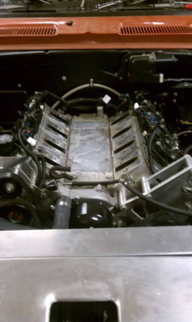

      Took off the stock intake and fuel rails last night and they are on their way to their new owner. Now the search is on for a good bulkhead electrical connector(s) until the new intake set up arrives Friday!

      Over the Christmas weekend I had a chance to throw on the Edelbrock intake, for some reason I'm having trouble installing the injectors on the Edelbrock fuel rail

      I ended up getting the injectors in (pain in the ass!) and had to modify the brackets for the fuel rails as the injectors were too tall to use the brackets but too short to use them as intended. Also installed the rest of the fuel line fittings for the fuel rail and started on the power steering lines, just waiting on a bracket to mount the power steering reservoir to the firewall. The brake lines came in the other day as well. Turns out the bracket for the brake booster/MC assembly to the firewall wasn't the correct one that came with the master cylinder kit so I had to order an angled one to clear the master from the inner fender. Hopefully by next week I'll have working brakes and steering then its time to finish the electrical and she's ready for paint!!!!!!!!!! (pics to be uploaded soon)

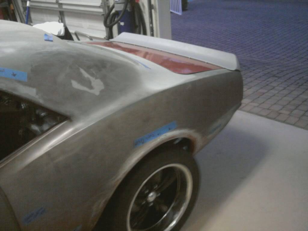

      For the first time in over 2 years the car is finally off the lift! Also re-installed trunk-lid and installed the rear spoiler.
