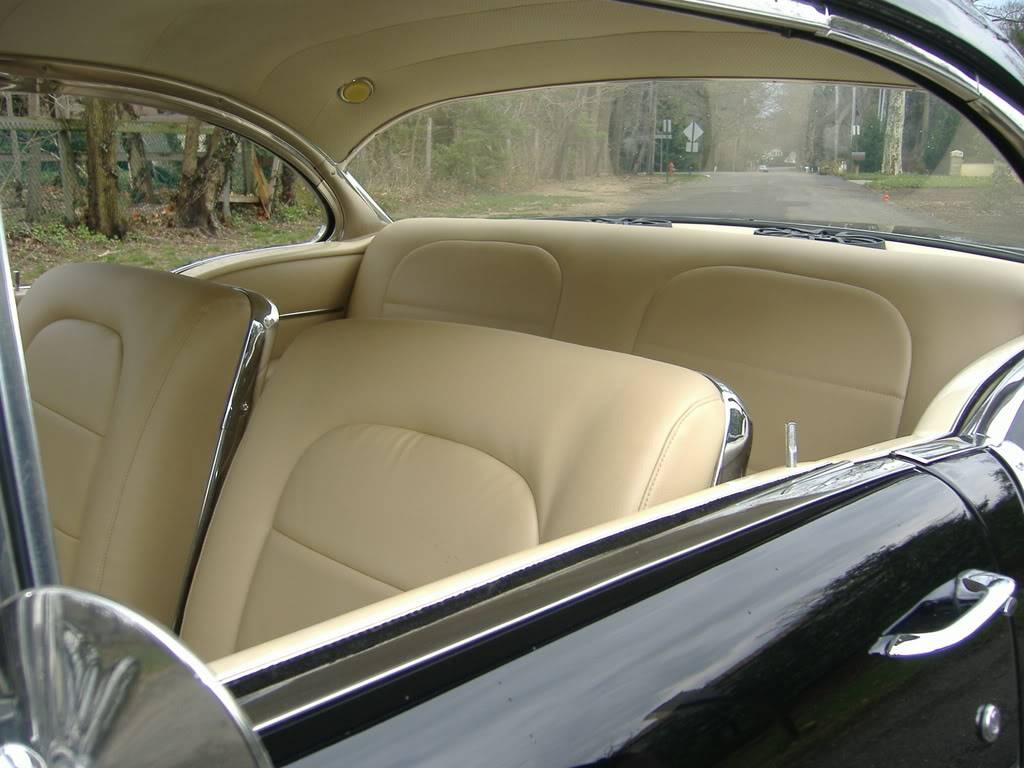

      The 64 Impala seats look really good in 50's cars IMO. Not much lateral support, but great for a pro-cruiser!

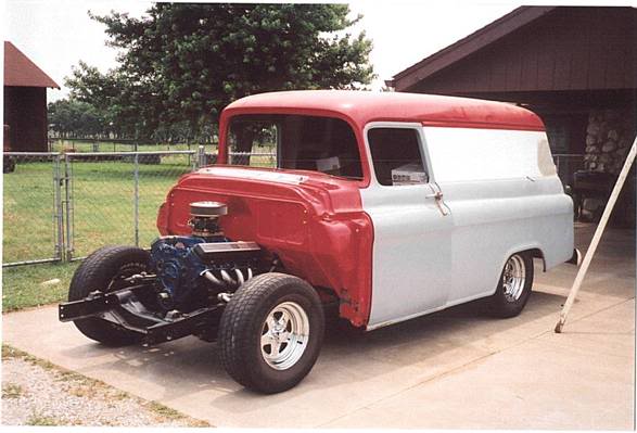

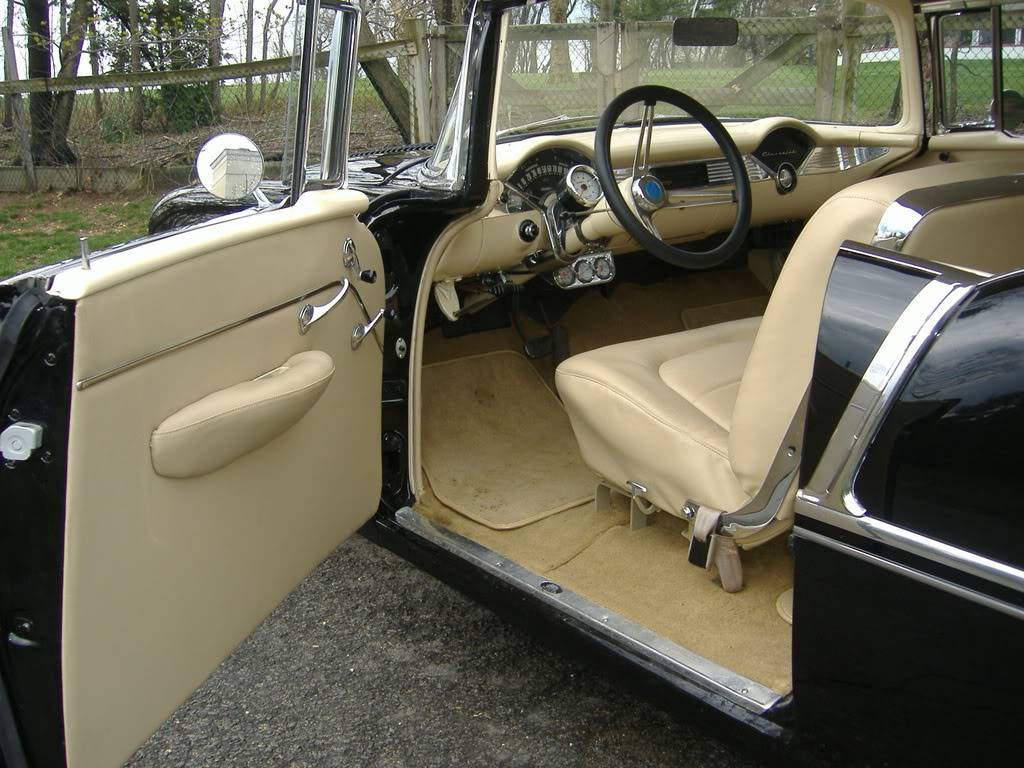

      Those Impala seats do look good - I may have to consider them for my 55 Post Bel Air - would you have any pics with the door open? I'll probably build a center console but will run a column shift. What about something late-model - anything that stands out whether they swivel or not? One nice thing about late-model seats is the integral seat belt but I don't think that's a must - I think there are plenty of places to mount conventional 3-point seat belts.
      Here is an old pic of the Panel:

      I dont have any great pics with the door open but heres an old one to hold you over... I can snap a better one next time I take the car out if you want
      Ive seen Silverado seats without the headrest in a big 50's truck that looked pretty good. Integral seatbelt too.
