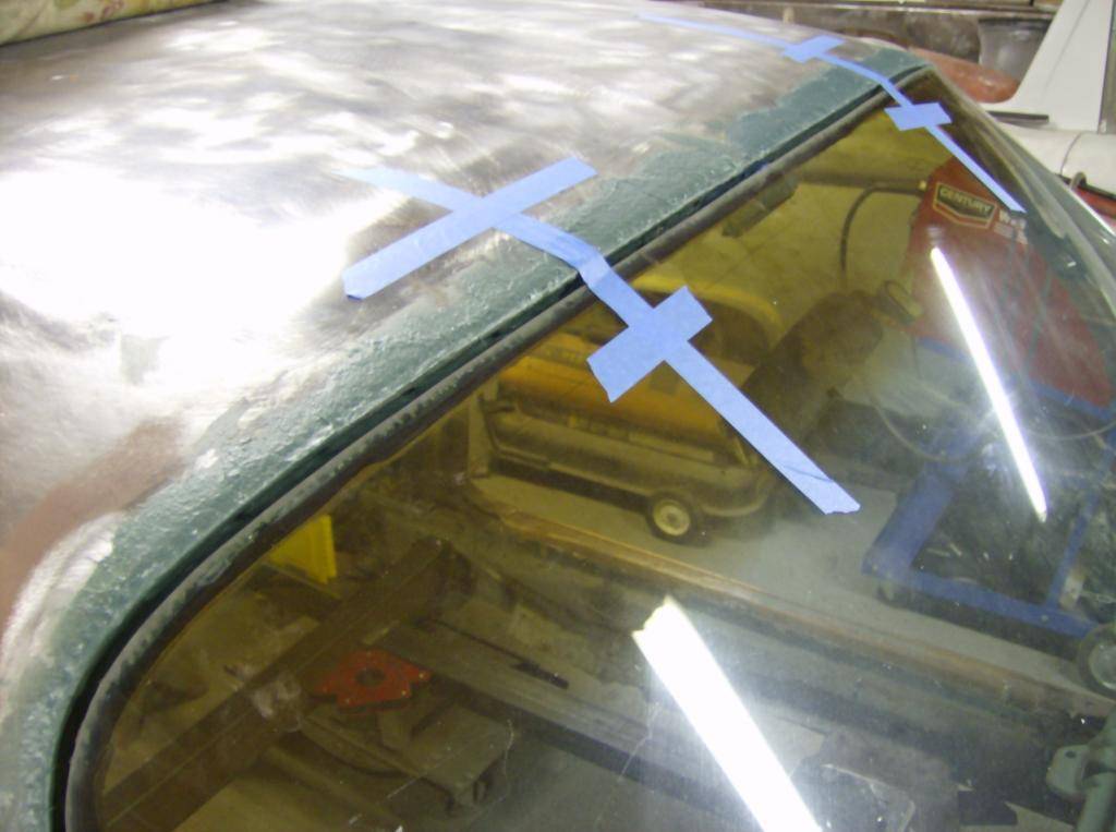

      Well I finished up installing the frame connectors last week,the 4 link installation is on hold until I get my 9 inch rearend here in the next week or 2.I decided to relocate the wiper motor to clean up the firewall alittle more.Name:  HPIM1810_zps57487c7e.jpg
Size:  70.9 KB This car is going to have flush mount glass,so I took some flat bar and 18 gauge sheetmetal and reworked the front windshield channel.After I welded that all up I went ahead and spread a coat of mud around the channel,the windshield is just sitting in there to check the fit still have some more work to do to clean it up and tighten the fit.
