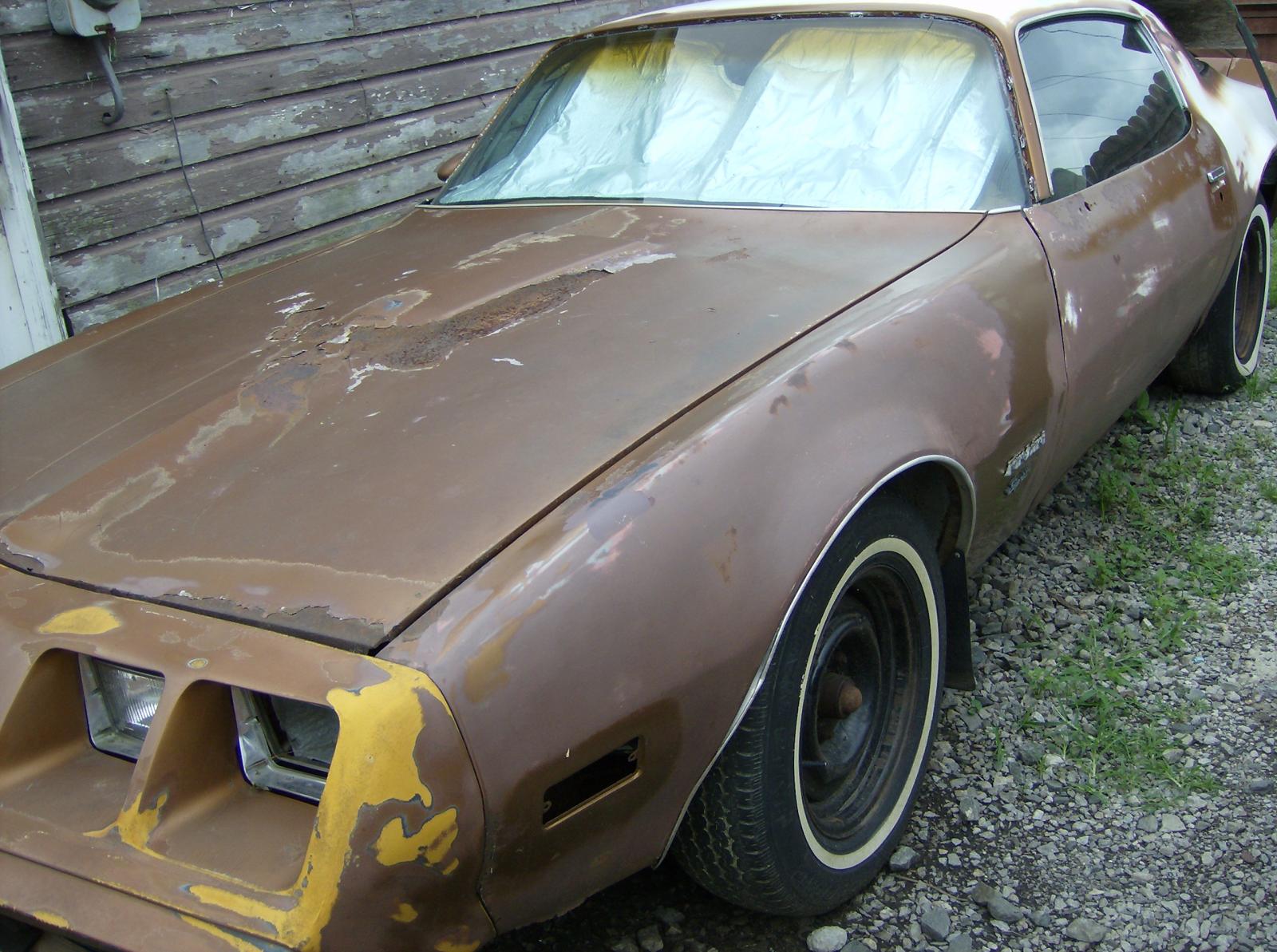

Size:  250.5 KBI posted afew pics of this car back several months ago when I joined the forum,I spend so much time building everybody elses car I dont have time for my own but I finally had a chance to get it in the shop the other day to start to dissasemble it.I am going to keep the overall look of this car very clean its goin to have several changes but they are going to be subtle.I am switching out the front end with a 70 front bumper and hood That I bought,also changing out the back glass to match.I have a 400 in the shop but cant decide if I am going with it or a ls swapand of course its getting a complete suspension upgrade I plan on this car seeing alot of track time when finished.

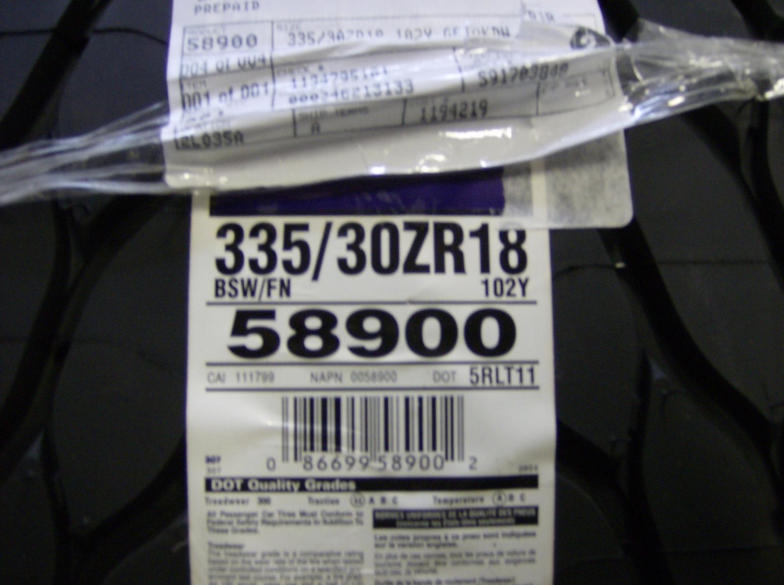

      Updates are few and far between on this project things will change in a few weeks,getting everything caught up at work so I can go back to workin 8 hour days instead of 12.That will give me more free time to get goin on this car.I did get the subframe dropped out started grinding down the firewall,getting it ready to smooth in,there is more rust on this car than I expected but thats the way it goes.Here is a couple of pics of where the car stands now also my new bfgoodrich tires I won!!!! that saved me some cash lol.
