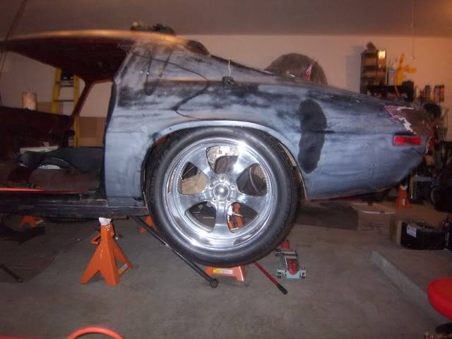

      Well the rearend is narrowed and new rear wheels and tires fit like a glove. The tires are pretty old (5 years) but they are brand new with the stickers still on them. They were stored with no air in them and I was successful in airing one up today. The other tire has one spot where the bead is unseated and not sealing. I tried soap and water, weight and airing up the tire but to no avail. So off to the tire shop tommorrow to have them remount the tire. I am very glad I got such a good deal on the wheels tires and brakes because billet wheels were never in the budget. Now that I seem them on the car, I would have never been happy until I got a set. Thanks again ole blue!

      Well got the tires remounted and rebalanced. They checked out good with no flat spots, so thats some goood news. The wheels look and fit great on the car now since I had the rearend narrowed. I will get some pics soon of the car on the ground with the wheels on it. I also still need to drop the front end a few inches.

      Here are a few pics of the car with the new rear wheels and the front dropped 1.5 inches. I don't have the new front wheels yet so I'm still rockin the vette wheels for a bit during mock up.

      Thanks for the complements guys. I really could not be happier with the wheels. It worked out well having to narrow the rear because now I have a big deep dish wheel due to the 4.5 backspace. Hopefully I will get the front wheels and tires soon. I am going to run a 18x9 with a 265/40 or 275/40 tire. d

      Nope, still the factory wheel wells. I just had to narrow the rear end 1.5 inches on each side due to the wheels having a 4.5 inch backspace. Normally guys running 20x10 wheels on chevelles run a 5.5-6 inch backspace. I haven't trimmed the fender at all but I will trim about 1/4 just to give the tire some breathing room when the suspension is articulating. The tire size is 295/40/20
