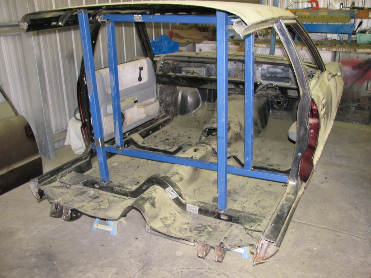

      Rear section of the corty removed, no going back now!!!
      Part of the floor cut out

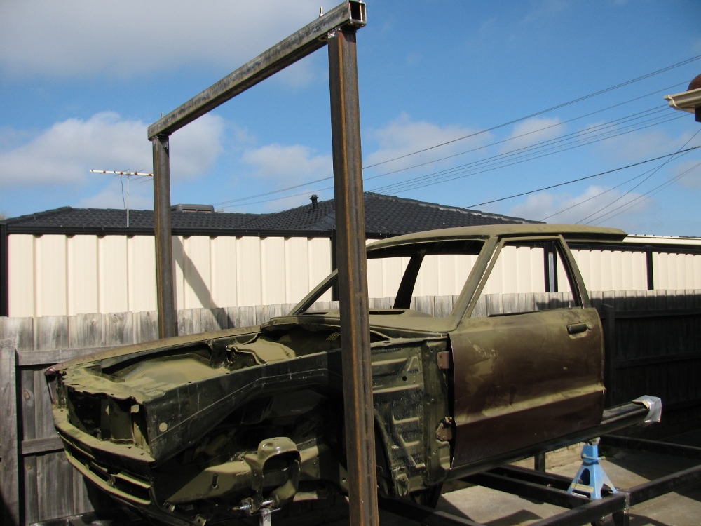

      I finally got the body up onto the frame table, which was easier than I thought it would be. Also started to extend the table as it was to short, but wasnt able to finish the extension due to running out of gas for the welder. As it was a saturday Iam unable to beg more gas, will have to wait till next week to finish it off, just need to add the legs and wheels. Also decided to lay a rail on the table to give me a rough idea what it will look like.

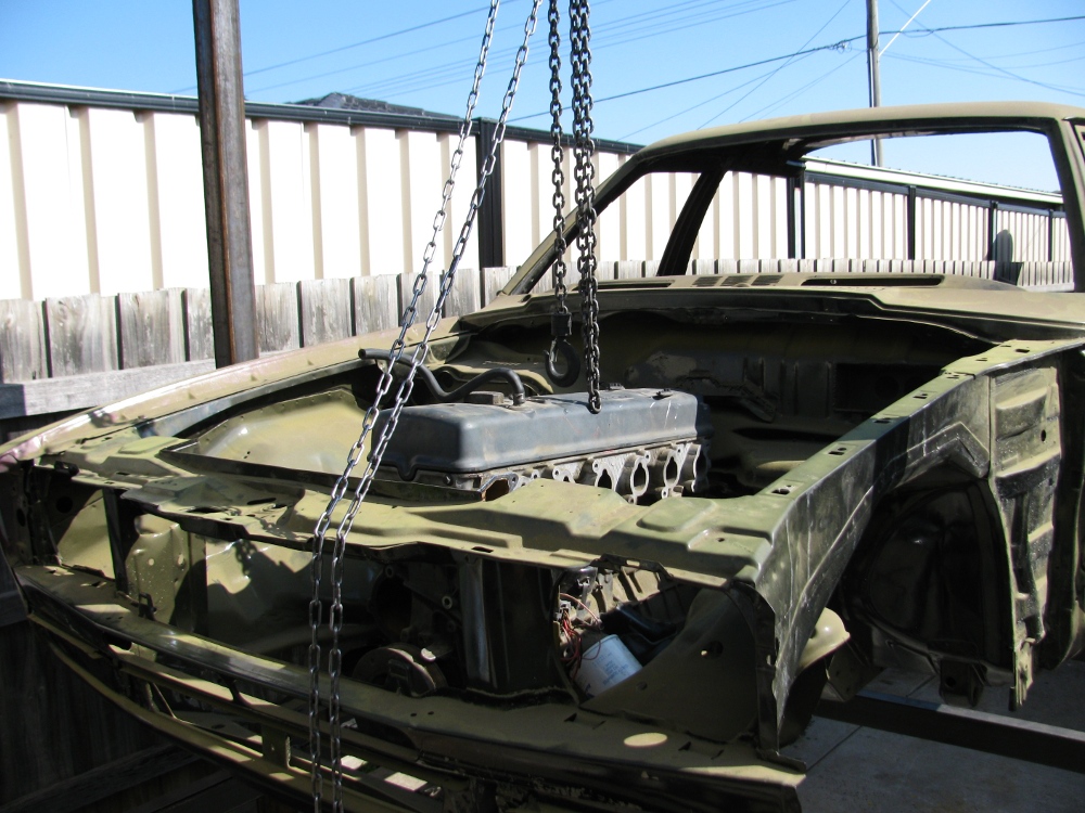

      Finally got the engine in the corty shell, damn glad it worked as I didnt want to have to take it of the frame table and put the motor in. It would have been fun trying to get it back up on the table with the engine in, not !!!

      Are those later engines bigger than the old cast iron 250's? Just wondered how much space it leaves you in the engine fore-aft?
      Regards,
      Leigh
      Sydney, Australia
      1971 Firebird 455
      Jul 2011
      Melbourne, Australia
      52
      Ford Cortina Ute Project From OZ
      Length wise the 4 litre Iam using which is from an EL Falcon is about the same as the older 3.3 litre or 4.1 litre crossflow's. The 4 litre motor I have is a little wider than the old crossflows. So what I have done due to the difference in the sump between a falcon and cortina, is to merge the two. The top half is a 4litre sump and the bottom is a cortina. The sumps on the falcon and cortina are different, due to the xmember being in a different spot. I may go back to a stock 4litre sump and just change the xmember.

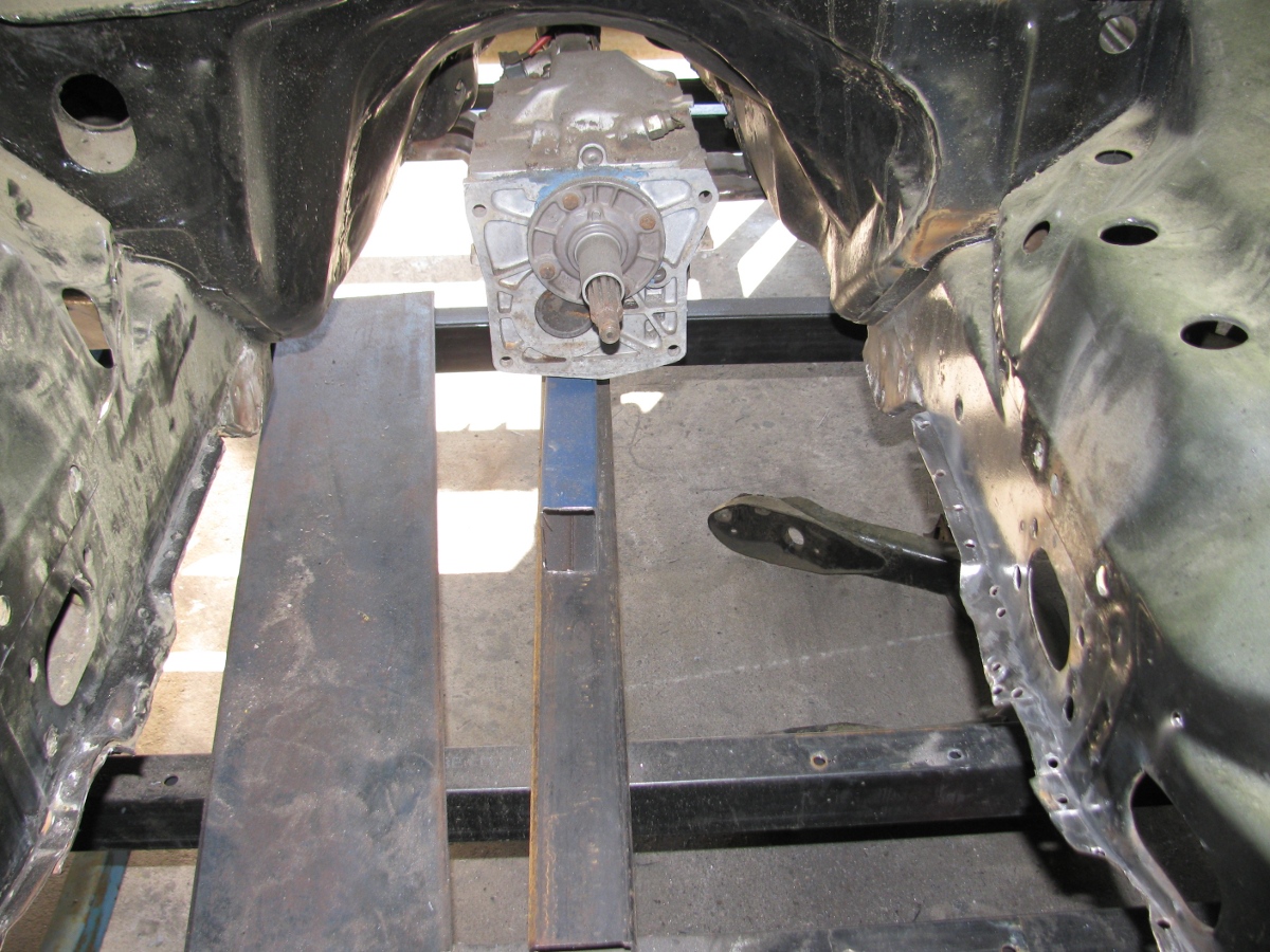

      Ok finally got the motor, gearbox, tailshaft and diff placed on the table and on the car, with it all lined up. So should be able to start doing some actual work on the car
      Anyhow just a few pics of how it sits atm

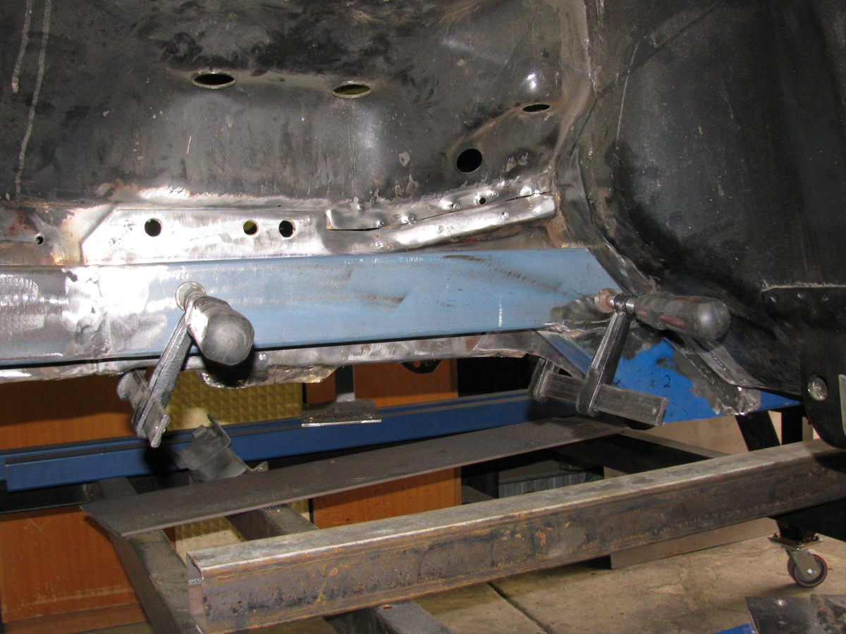

      I have decided to replace the factory rails on the corty and go with a custom chassis. Here are some pics of me starting to remove the rails on the front of the car. I will also be removing the factory cross member.
      Jul 2011
      52
      I have managed to remove the factory rails, and the crossmember. Started to make up the new chassis/rails today and got the front section done. Need to get some more steel tommorrow so I can finish the rest. Once the chassis/rails is done I will get it made up as this is just a test/sample chassis. Just need to find someone that can mandrel bend it up.
