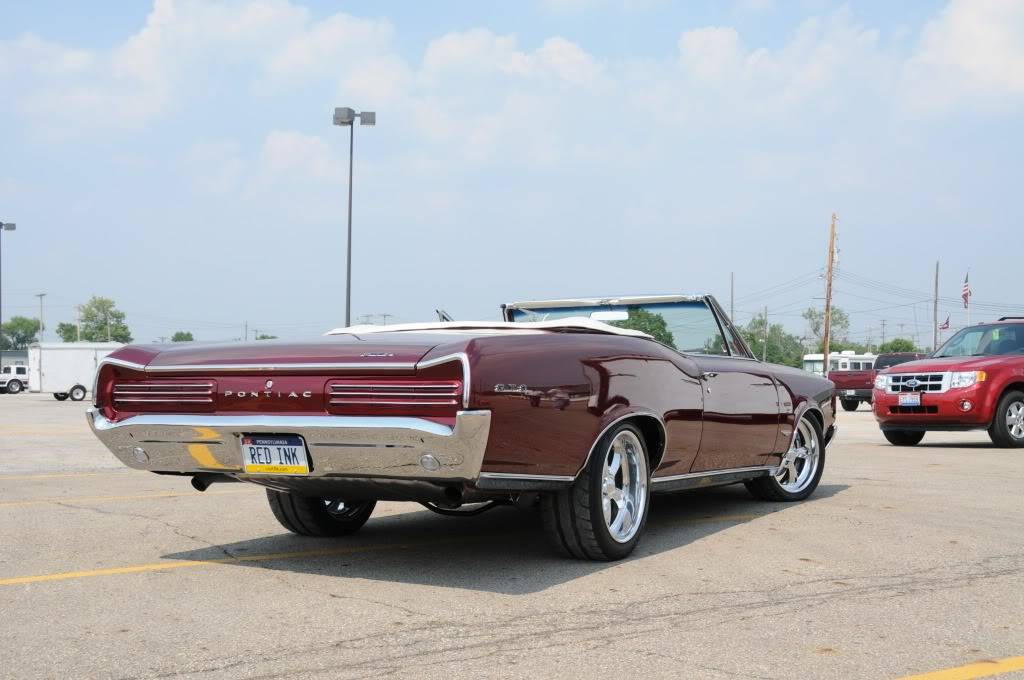

      Interesting. I got my SPC springs from Marcus on my '66 Pontiac A-Body. Currie Currectrac and Moser bolt in rear end. Nothing else modified in the geometry. I am quite happy about where my height ended up.

      Hey Alex, Actually if anything I may slightly increase the height in the front. For the rear, anything lower would create some problems for me. Don't forget all of the other complications that start to occur. It'll be harder to set pinion angle, have driveshaft clearance, etc. My first pic above is a little misleading. I took it from low on the ground and it makes the rear end look higher than it is. The second pic is pretty accurate.
