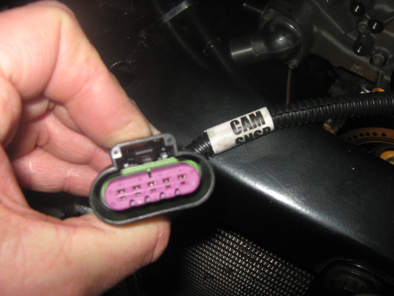

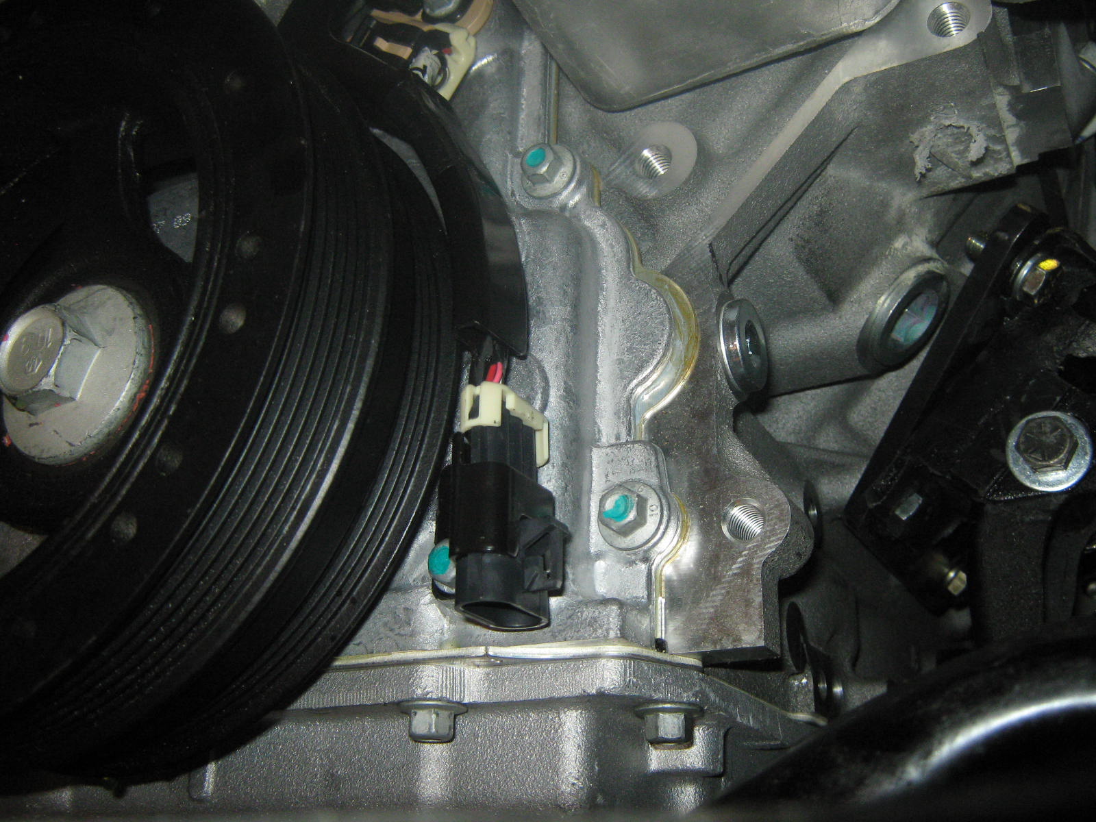

      I'm wiring the the LS3 eRod and I think I have a problem with the cam position sensor. I believe this is the cam sensor. It has a 3 pin connector with all three pins wired. The cam position sensor plug. It is a five pin plug with all pins wired. It is the same connector as the MAF sensor. Am I looking at the correct parts? All the connectors are accounted for except the cam sensor.

      Problem solved. I looked up the schematics and two of the wires are for the cam phaser and three are for the sensor. That sent me looking for the adapter plug in the kit which I found.
