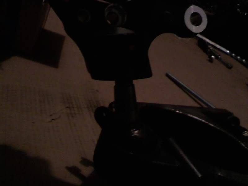

      Agreed, I think I did not explain myself very well. A picture is worth 1000 words, Id say these crappy cell phone pics are worth maybe 250 but they may help me illustrate my point
      Here is the ZO6 knuckle next to the lower ball joint that I want to run. The second pic shows the knuckle sitting on the lower ball joint. The threaded part of the ball joint is 5/8, as you can see it does not even fit thru the knuckle. It will have to be reamed out to fit the larger ball joint stud, Im just trying to find out if anyone knows what the angle of that stud is. I tried to measure it myself with a digital caliper and given the room for error that I gave myself, Id say its somewhere around 6.75 degree to 7.5 degree taper on the ball joint

      Im with Andrew, I would not ream that spindle. That is going to be alot of material moved for that lower ball joint to fit right.
