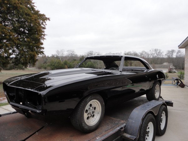

      It was a real pleasure working with Jeff on this car. It was nice to start with something that did not require a complete new skin before you ever got started on the body work.

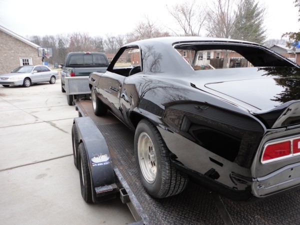

      Here is a few more from when I loaded it up to deliver it back to Jeff.

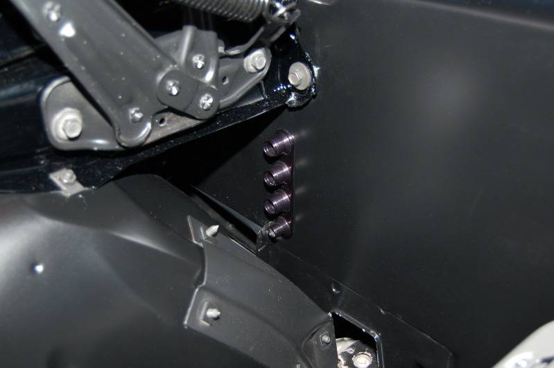

      So back to the good stuff. The stuff like a bad day in the garage is better than a day at work. I have been slowly moving forward with the exterior items on my car. I had Marquez Design turn signals and DSE headlights to install. I know you guys have seen this stuff before but I am here to add that they are both great items and really update the look on the front. In case you have thought about getting these turn signals you might want to know that you have to drill new holes and cut out part of the front valence in order for them to fit. And I probably would recommend cutting this out before the fresh paint job.

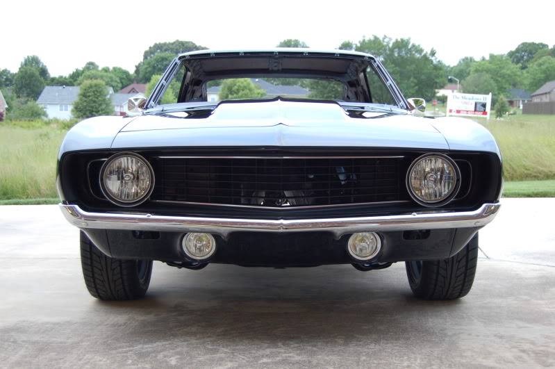

      Here it is installed. These are really nice machined pieces that offer a close fit to the bodywork.

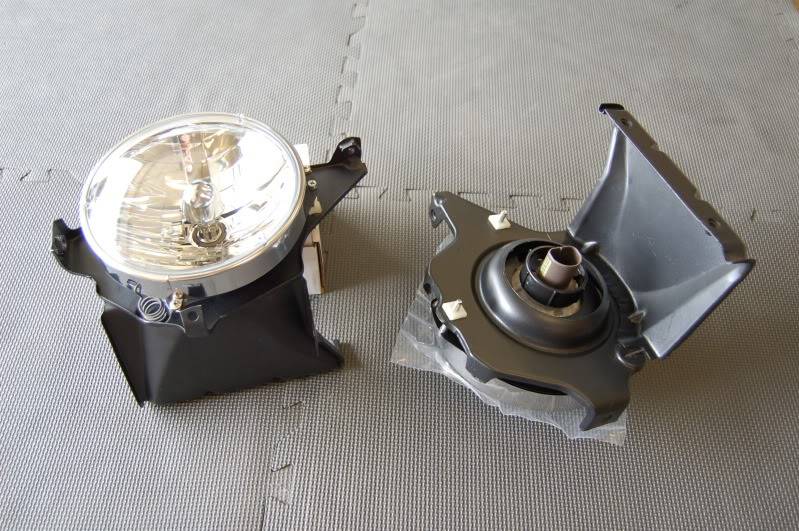

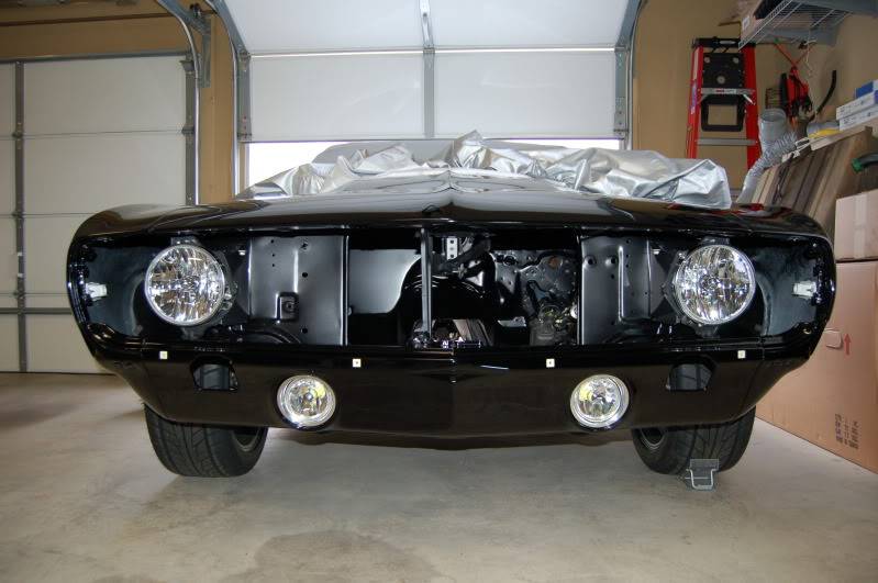

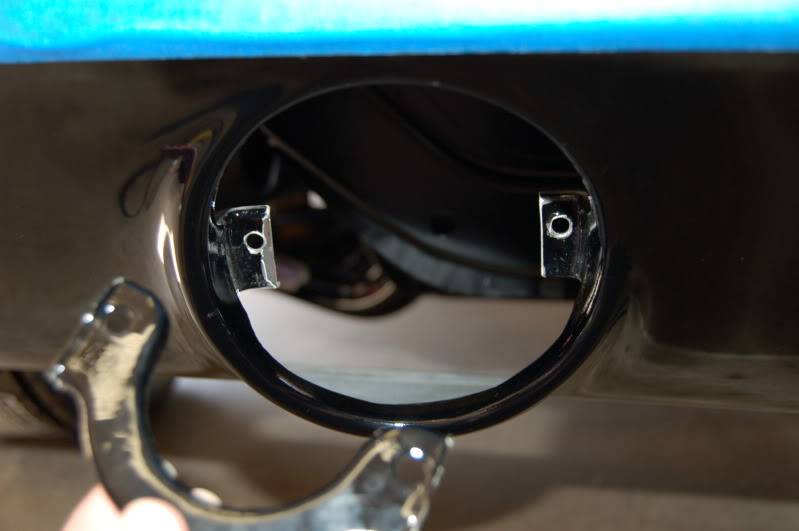

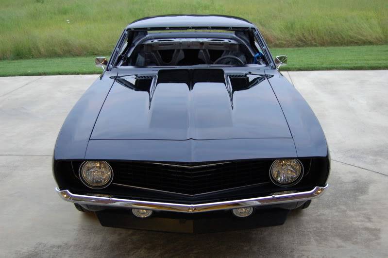

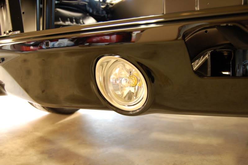

      Then I moved on to the Detroit Speed headlights. I had originally told Brian I would probably get new headlight brackets. He ended up blasting and powder coating them and they turned out great. Hey, something else we actually got to save from the original car.
      One thing to note about installing these is that you have to cut out a 2.75" hole in the back bracket in order for them to fit. Again, something probably better done before the paint or powder coat. I used a hydraulic punch and that worked out great.
      After a bunch of tweaking they are all mounted up and then the rest of the front could be assembled.

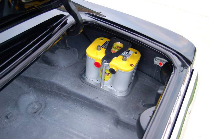

      Then onto mirrors, door handles, weatherstripping, side markers, battery relocate, rear bumper, etc.

      Thanks. Do I plan on lowering the car? Absolutely! I thought those pictures would bring that question up. It is just that high right now with the engine, interior, and gas tank being out. The car is set up for lowering with the front coil springs and rear leaf springs but I am sure I will still have to add lowering blocks in the back to get it just right. And that deep black is all Brian Finch's handy work.

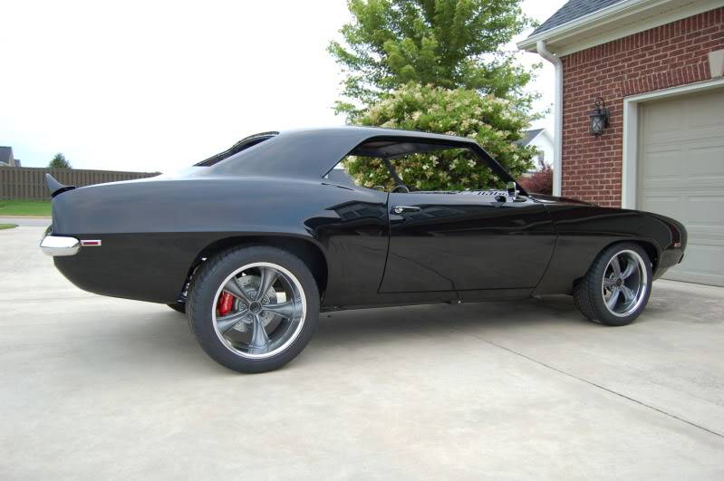

      Those wheels are the heavily debated Boss 338s. Not that they don't look nice but usually the issue of do they fit the Camaros. I was and still am torn between too many nice $$$ wheels and couldn't make up my mind. I needed something now and I ended up liking these especially for the price.
      Front: 18x8 with 4.5 BS, Nitto NT555 245/40R18
      Rear: 18x9.5 with 5.0 BS, Nitto NT555 275/40R18
      In my opinion, this company chose the wrong backspacing when they made these wheels. If they would have setup for more backspacing I think they would sell even more of them. The front is okay at 4.5 BS but the back at 5.0 BS is really pushing it. So much so that many places will not recommend this size on a first gen Camaro. I was able to test fit these wheels before I bought them because a friend had just bought them. After putting them on over the new brakes they are VERY close. The only thing I have in my favor is the fact that Brian did a clean job of cutting back the fender edges inside the wheel tub. These wheels really need at least 5.5 BS and then there wouldn't be an issue. However, as you already know your 68 will have a more rounded wheel opening and you might be able to fit them without an issue. Here is a link to the same set of wheels on a 68. I think you will like the look.

      Great pics- will help me out alot! I was thinking of moving the lines in further but then I have to deal with coming thru that hole in pic 2... Is there a reason why you didn't go in further or is that just where Brian put it? lines to short? That bulkhead is from VA? Yes, I believe I will have to get the DSE bracket bc my firewall is pretty much done....

      Yes, that is a Vintage Air bulkhead. And I wouldn't want to mount it any further in and then have to deal with the hoses coming out of the fresh air opening. I plan on putting the stock kick panel back on there and I also want to keep my fresh air vent for now. Eventually I might close it off all together and place a speaker in there like some others have done. The VA system is great but keep in mind that you no longer will be pulling in fresh air from the outside like you can on any new car A/C system.

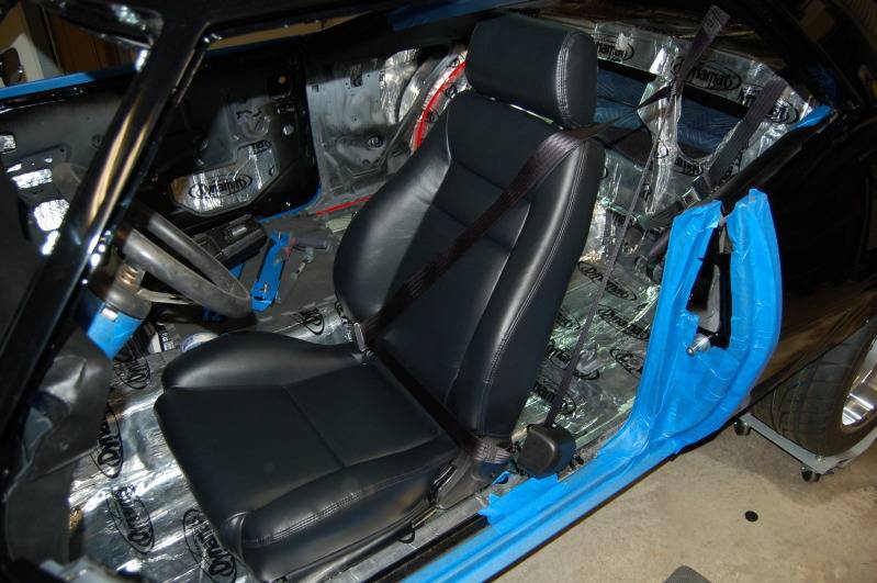

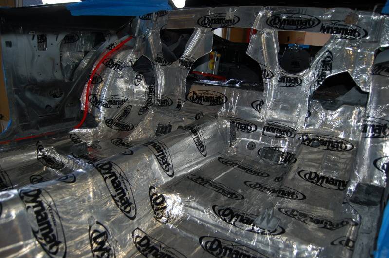

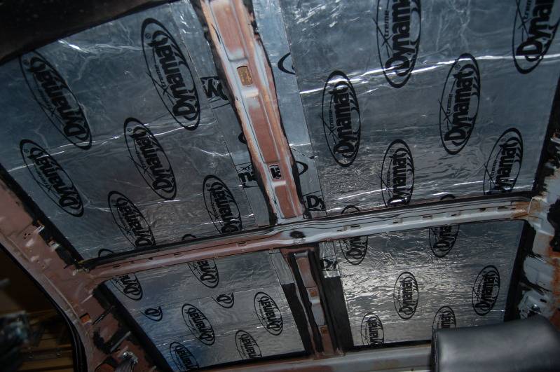

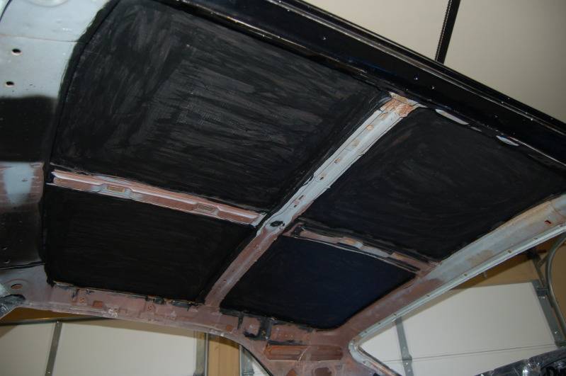

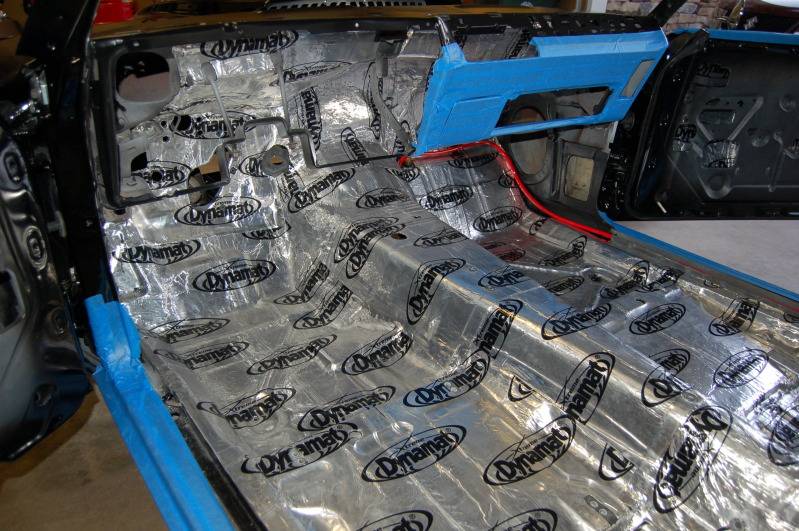

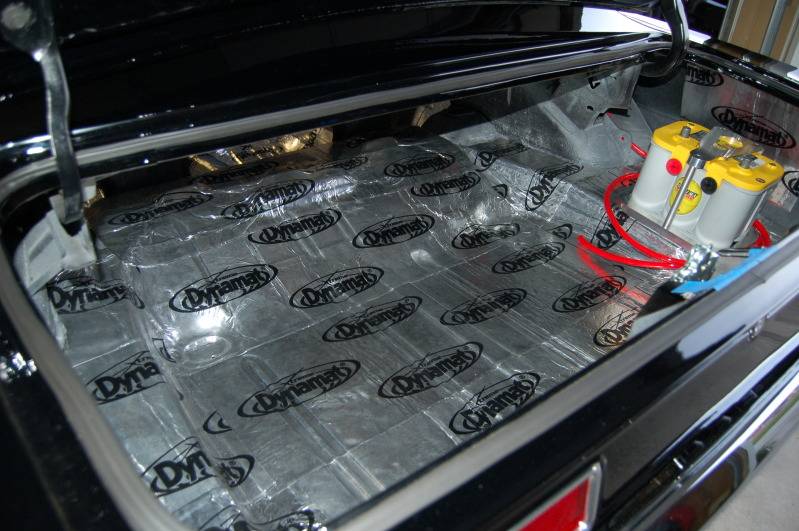

      I hit the roof panel with Eastwood convertor first. Then started soundproofing/heat shielding with Dynamat. A LOT of it. I ended up liking how well it worked and pretty much did the whole car. If anybody wants to know it takes about 4 bulk packs. Shutting the doors or just the solid feeling of the whole car now is a night and day difference.

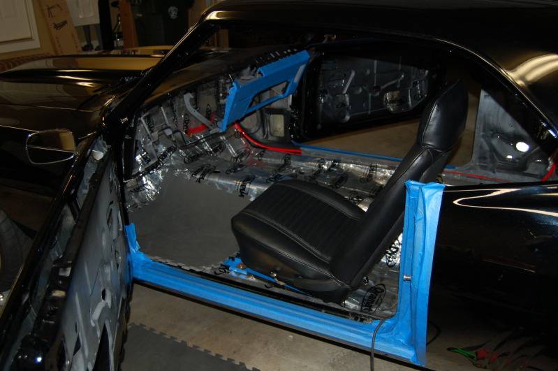

      I have had the interior restored for a few years so I went ahead and installed the front seats. The funny thing is I had always driven this car with a seat that was shot. I basically sat on towels over the springs and that must have sunk me pretty far down in the seat. Because when I sat in the seat this go around I was up into the roof. NOT GOOD! So I ordered the 2" seat setback brackets thinking those might work. These actually were a well built piece and fit right to the floor boards with no mods. However, at 6'2" I was still not able to get comfortable and I knew I needed seats that recline. Ended up going with some Scat ProCar Elite seats after originally thinking about the better matching Rallys. To me the elites will fit a taller person much better because of the extra seat back height. I will also end up modifying the Procar seat brackets to get another inch of head height clearance. To go along with the new seats I added the Morris Classic Concepts seat belt sets for the front and rear. Yet another quality built product that I have been very pleased with. They are comfortable and the new GM logo that matches the original belts is a nice touch.

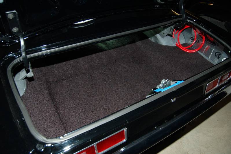

      Molded trunk carpet. This was a new product that had just showed up at Classic Industries. Ordered it, got it, unboxed it, unfolded it, it fit, BAM, done!

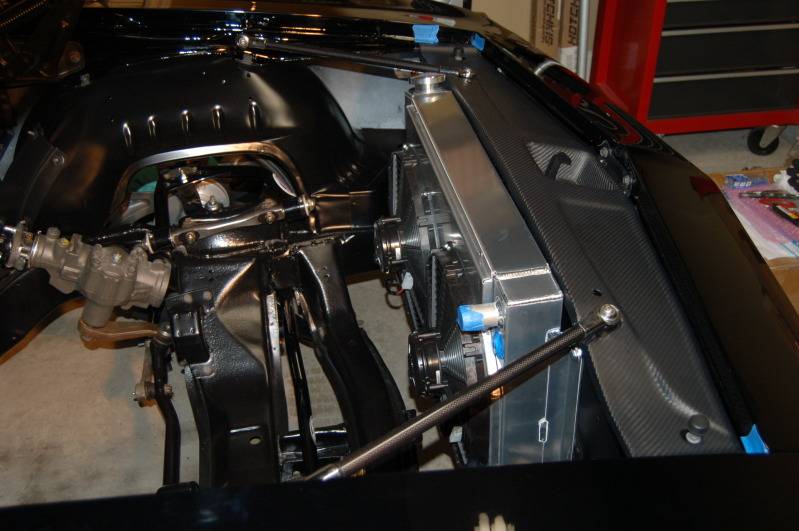

      Test fit of the PRC LS radiator and some Anvil Auto goodies.

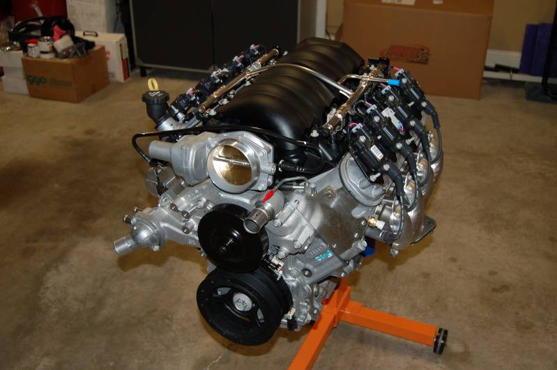

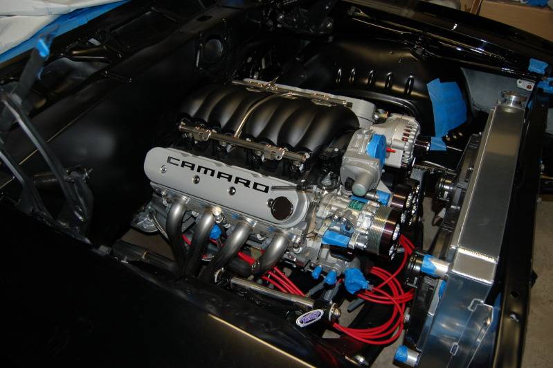

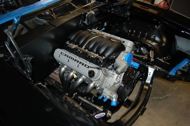

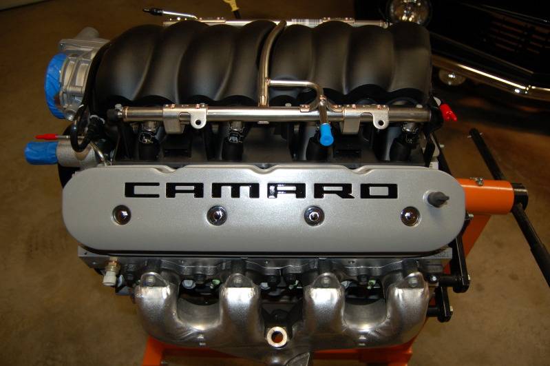

      Sometimes good things come in big packages. It even had that new engine smell. Good stuff!

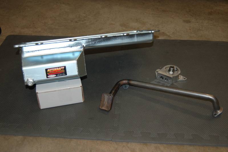

      Aftermarket goodies I added to help dress up the engine, improve flow, and prevent any oil starvation.
      I have gone through a couple of different LS conversion engine plates to make my drivetrain combo and trans crossmember work. I realize now that the half height body mounts and a large engine setback might have been easier with some trans tunnel modifications. Since the first attempt I have used some tools of persuasion on the tunnel. I am still tweaking on getting this setback the way I like it but I am pretty close now. Here it is sitting in for the second time.

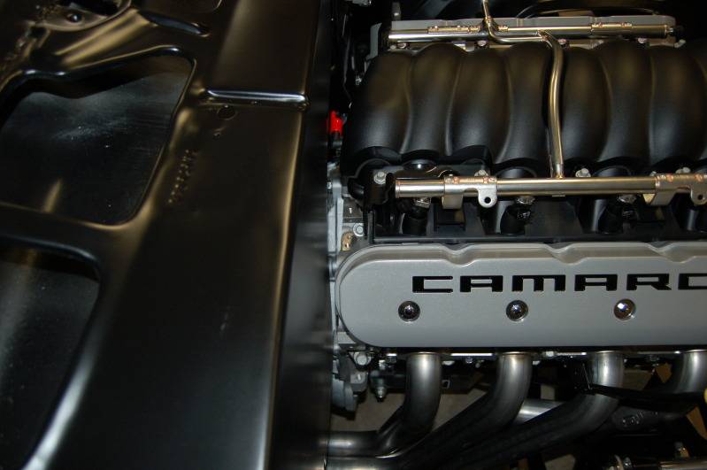

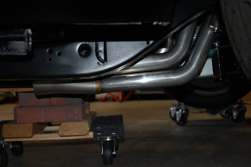

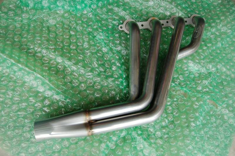

      Here is a shot of the Stainless Works headers installed. I know a bunch of guys like to see if headers hang down below the frame rails. I think the SW headers tuck up slightly higher than the other brands I had looked at. One more inch up and they would probably be perfect. But for a non custom header I thought they have fit just as described and had good clearances all around. Some spots around the power steering are close but that is always the case for this car.

      Kusi- did you get the extended hose kit from VA? If you are planning on tucking/hiding in fender you will need longer lines! It didn't come with all the correct fittings i need to do it the way i am so i had to order a few more...

      I love those new valve covers! Im gonna prob go the cheaper route & make a coil cover panel with some CNC & put some custom writing in it or something? Not sure yet...
